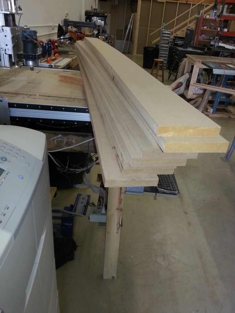

No theater-specific progress. I've started cutting up MDF/Ply for shelves in the family room. Delta-FL and OSB is done and mostly tapcon'd down. Today we primed most of the basement walls and ceiling.

Riser Framed, Columns and Trim Started
I framed a riser up using 2x6 perimeters with 2/4s as joists. I had originally planned for a taller riser, with maybe 2x8s or 2x10s, but I scaled back because I didn't like how it would work out with my ceiling heights. I also plan to do a mini riser under the back row of seats to get the sight lines good enough. I mocked my seating distances up in another room using my seats that I already bought and it should work out OK.
I've also started putting together some of my columns, wall paneling, and trim. I cut some strips of MDF for the column sides.
I went with 4.5" deep columns, plus the 3/4 MDF face, so just over 5" from the drywall to the front of a column.
I also have 4 of my column faces cut. I need to make a Lowe's run to get some more MDF for the rest. Here's one getting glued together:
After glue up, I've been flush trim routing the edge of the front face to make it even with the sides. Here is my first column mounted. I have a mess of wiring from all of my lights in this column that will eventually get wired up to a Grafik Eye.
As you can see, there is also a sheet of MDF attached to the bottom half of the wall next to the column. I'm going to use that between each column and do Cinemar-styled panel trim on it. The remaining part of each wall section will eventually get fabric covered wall panels between the columns.
I bought a load of crown and base trim too, and started cutting the crown sections that will go up into the tray ceilings.
