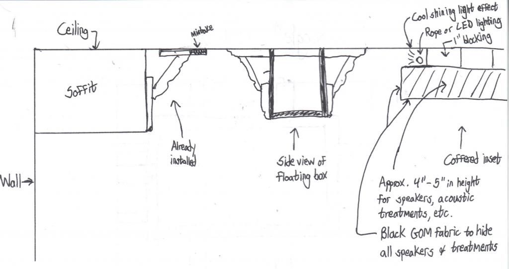

But without TMcGoogle......it's tough to get a visual! Are you referring to flipping the crown downward to reflect off vertical piece? Was planning on crown being down at bottom of vert with reveal.
OK. Hopefully this TcMGoogle Sketchup helps you visualize what I meant in my post. Remember, the software is currently incapable of accurate scale, which is no matter since accuracy in engineering drawings is an overrated feature.
I believe you were looking for triad to make a surface mount speaker that has a very low profile that you could use for your ceiling Atmos speakers. Knowing Triad, I would assume their design would be in the 4" range, similar to their in-walls. You were also looking to place acoustic treatments on the ceiling and cover with acoustic fabric while still finding a way to light everything up with indirect cove light of some sort. So my proposal is creating a functional inset within the inner portion of each coffer that can conceal the speakers and treatment while providing a spot for indirect rope lighting, similar to the Burj Khalifa picture above, that simply shines against the inside portion of your coffer. Make sense?
How much is a license for TMcGoogleSketchup ? I might need to use it.
Product information was posted in The Plains Theater at THIS post. Pricing fluctuates, but is closely tied to the wholesale market pricing for dehydrated chicken livers.
If it's any consolation, my second wife hasn't even been born yet....
I like it!!! You just cost me more material!
What a great idea! One of a kind......different......
Applying TMcGoogle now makes perfect sense..........what would this world do with out it!
Concept is out now let's build it! Triad's getting back to me.....thought was to use either in ceiling Silver Sats, Bronze LCR's, or custom build Silver LCR's in an angled baffle. Minimum of 6" is required which is doable.
If Triad's conversation with Dolby suggests getting away without angled baffle, standard 4" in-wall Silver LCR's could be modified for ceiling.
Will figure logistics out on how to build with what material......glad someone has a creative mind since it's not me!

Care to share what angles? I assume it varies based on which set of ceiling speakers - first row, second row, etc.
T,
I have PDF along with angles.......problem is, my computer won't let me get to my email account so I could use snipet tool. Can't save or copy PDF from my phone or tablet. I'm trying to find a way to format on phone.
I'm working on it....
Here is a link to info Roger emailed me........I believe info is similar.
The official Dolby Atmos thread (home theater version)

Rogers explanation:
My current rear surrounds are elevated 20 deg, and with the rear heights at 50, there's a 30 deg vertical spread, which I think is good. In the front the spread is 40 deg even though they are 10 lower on an absolute basis (the front L/R are at 0 deg elevation).
I do have the option of shifting the front heights forward, thus also giving me a 30-deg spread. To the rear seats, the elevation difference is almost nil, 17 vs 15 deg, so I only need think about the MLP here.
One thing I like about the original 40-deg position is that the ceiling cloud will reduce SBIR, whereas the 30-deg position has bare ceiling (and can floods) with about 1 ms extra path length, making a null at 500 Hz or thereabouts. Dolby (thru Denon) suggests they should be 30-55 deg elevation, so 40 seems the better option for that reason, too. I'll start there.
Hope this helps TMcGoogle.

Yesterday, emailed my design plans from Erskine Group to Steve Colburn at Triad. We can all assume recommendations and placement will be based on current speaker locations and set up. Until then, have to find things to keep me busy in room.
Well, its back to sanding, pre-stain wood conditioner, sanding, staining, sanding, and finally shooting four coats of satin lacquer. Here is inventory being used for ceiling cloud:
60 LF 1 X 8. Knotty Alder
60 LF 1 X 6 Knotty Alder
60 LF 9/16 X 5-1/4 OG base
60 LF 9/16 X 3-1\4 OG base
60 LF 4-1/4 Crown
50 LF 1-1/4 X 1-1/4 cove
For now, at least I can have Knotty Alder ready for constuction while I wait for Triad. My design all depends on outcome from their recommendations, yet ultimately decision is mine.
Here is a mock up of light tray. Very similar to mock up you guys preferred yet now has 5-1/4" OG base which is not stained.
