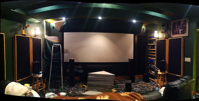

The wides are sitting on bar stools with old college books to position them correctly.
On paper and using geometry guide looks correct for improved soundstage width.
However, since I have wide scope non AT screen (10 feet width, 130" diag) my mains are outside that already.
There is actual 26" distance center of mains to wides.
The back corner of the wides limits how close to the wall I can position them.
This opens up using thinnest possible bookshelf speakers, or using those flat screen side speakers, which are 4-5" deep vs my 11" deep monitors to improve the separation and get the wides as close to the wall as possible
Later I'll run Audyssey, I'm really curious to hear the difference.
If my mains were closer together I'd intuitively expect some gains, but my situation is leading me to lower my expectations somewhat for wides.
(auto stitch on iPhone4 works decent enough)
Sent from my 32GB iPhone4 using Tapatalk

Hi Mike,
I think the wides are going to be too close to the mains. I'm assuming the wides are at 60 degrees azimuth from the MLP. You may find it necessary to cheat a little down the wall for best results.
Also there have been some comments that the wides affect center output or widen imaging. IIRC the wides are supposed to derive all their information from the L & R channels and not touch anything going to the center. So, it shouldn't "pull" any center information to the sides. Now if dialog is coming out of the L or R then yes it could be pulled to the side more but, assuming the dialog is suppose to be off axis and coming from the L or R, that shouldn't be distracting. I'm wondering if room accoustics is playing part in some of the problems noted.
The above assumes what you are watching (listening) to has been properely recorded. Don't worry about televison. It's all over the place.
BTW, I've had a 11.1 setup for almost 2 years now.
John

Blame it on my turing 50 this year. Or my boys distracted me during set up and me not following my layout.
I put them at 45deg not 60 and I started this thread with the layout clearly in post 1.
Will move them to correct location.

I've got the wides at correct 60 degree location. They do impeded into the theater space, less deep speakers are desired definitely.
When I re-do my side wall acoustic panels these speakers will be the 5" closer to the wall and acceptable.
Putting the heights up temporary was hard to do, due to acoustic broadband bass traps, so I had to tear those apart and put mtg brkt up.

I forgot how bulky my screen is, took it down yesterday with my 15 year old's help.
Ran the wires behind the upper bass trap and along the LH bass trap, meant taking all the triangles out and then back in again...
Got the heights mounted and the bass traps all modified/back, the wides wires routed and they are sitting on the bar stools still as temp solution, not sure on final method for them.
As for critical listening, lots of combinations going more than 7.1, so will take time.
