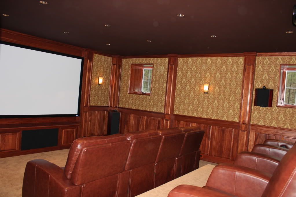

I constructed a home theater about a year ago and have been enjoying it immensely.
I posted the theater here : http://www.avsforum.com/t/1391328/the-farm-theater-complete-with-pics
I feel that at times the center channel dialogue is not clear; I have not addressed the rooms acoustics and i am wondering if i should treat the room acoustically or go with the Audyssey program built into the NAD M15HD processor first.
Thoughts?

If you have the processor, what are you waiting for? run Audyssey. If it improves then you should be happy.
Now the bad news. based on your speaker placement, low to the ground. the second row is always going to struggle with hearing the center channel. It looks like the second row doesn't have a clear line of sight of the speaker. That is a problem. That is why so many of use use acoustically transparent screens and place the center directly behind the screen.
How does it sound in the middle for the front row? that is probably the best seat right now.
I re-read your thread and I see that is wallpaper above the wood, so basically you have hard surface walls, correct?

Hi I would run the audussey but it is a 500 dollar add on for the software , and I am not sure if it will make a difference as there isn't too much on the forums about this model. You are correct, it is better in the front but not perfect. As the screen is purchased, would additional center channel speakers above and to the side help. Would likely compete with the front sides.
And yes , all the sides are hard, so would one go with acoustic treatments before room equalization with preamp?

I think it would be worth a couple experiments before you go spending any money. I've got two ideas for you as to why you're having trouble. Maybe we can come up with a way to determine if either of them is the cause.
The low position of the center channel speaker is the first guess. Like BIG suggested, line-of-sight for the second row may be the problem. Also, the proximity of the floor may be causing interference (SBIR) that creates a frequency response dip which may be in a troublesome frequency region for dialog. To test these hypotheses, maybe you can temporarily rig up the speaker up in front of the screen on a stand - at least high enough that you can see it clearly from the second row. Listen to a couple troublesome clips and see if that's a solution.
My second possibility is harder to test. There is the possibility that untreated resonances are masking other sounds. A sound in the recording may be unusually amplified by the acoustics of the room, making it harder to discern other sounds in a nearby frequency range.
Read about the phenomenon at wikipedia here.
Determining if masking is the problem won't be as simple, but you might start with a casual analysis of the troublesome clips; are they "busy" sonically - especially in the lower frequencies (below around 300 Hz)? "Yes" would suggest masking may be likely. Continue with some test tones of varying frequency - hopefully a sweep of frequencies (like the kind generated by REW); listen (or measure) for strong peaks in the response. If you find that bass response is strongly uneven, you may be dealing with some strong room resonances (eigenmodes), and potential masking as a result.
If masking is the problem, you'll need to do some more thorough analysis and maybe some treating as well as EQ.
Of course, I could be striking out here - let us know if this gets you anywhere.

Hopeful Fred, thank you for the suggestions. I will move the center channel and see what I hear. It is true that dialogue seems to be "muddier" with more complex sound tracks. For example, listening to a sports channel or news show is less of an issue than a movie.
Will update after trial

99.99999% of the time, dialogue intelligibility problems are directly as a result of poor room acoustics ... not electronics or speakers. While automagic room correction systems can assist with sound quality improvements, they should be used to tweek in room response rather than be the primary method of attempting to get good sound. As well, room correction systems still have one remaining problem none of them have yet overcome ... they cannot violate the laws of physics.
Get a proper acoustic engineer, relocate that center speaker, and then a professional calibration.

Thanks to all who replied to my post. Moving the center speaker did not help much; so i did my research on room treatments and put a few calls in. I decided to get 4 traps from GIK Acoustics; Bryan was most helpful in going over my room, and suggesting what i could add that would help my main issue with dialogue clarity. I have 2 traps in the front corners and 2 traps in the middle of the rear wall; covered with a chocolate brown fabric. Everyone at GIK was very responsive to emails and shipping was quick.
End result- The difference is absolutely amazing. Even my 13 year old son appreciated the improvements immediately. Dialogue is clear, bass is tamed, and i am hearing sound effects in movies i have watched a few times that i have never heard before
Clearly there could be more to tweak, but as mentioned in other posts on room treatments; this will potentially give you the most bang for your dollar.
