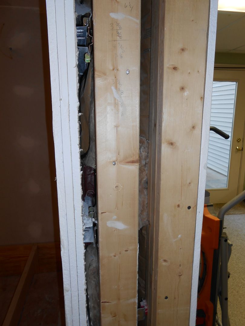

I just did a marathon read of this thread and WOW, that's quite the theater. Very impressive!
I do have a question on the walls, if people are still monitoring this thread. The entire thread started after the walls were completed, so there are scarce details. I do have this picture from Big, though:
Okay, I got out my screen ruler and calibrated it on the studs. Based on that, here's what I think is going on:
3 layers of 5/8" drywall with Green Glue in between
1 3/8" hat channel with whisper clips
2x4 stud wall with insulation loosely packed
1 3/4" air gap
5/8" drywall
Is that right? If so, on to the questions:
1. I know that all hat channels are not the same... so what are the specifics on these?
2. Is the insulation in the interior wall attached in any way or just sorta there?
3. What is the reddish-purplish blob just above the lower hat channel?
4. Is there another isolation clip (or similar) in between the two walls (lower right hand corner)? If so, what for?
5. Is there any kind of isolation barrier between the bottom of the walls and the concrete?
1 3/4" air gap
5/8" drywall
Not my thread, but I'll give you my perspective.
1. Most of the hat channel you see used out here is 7/8" tall x 2.5" - 2.75" wide. Used to be only the 2.5" was recommended, but the clip mfrs now all support the 2.75" wide (according to Ted at The Soundproofing Company).
2. If un-faced, the insulation is friction fit. If paper faced it can be stapled. Nothing fancy about the insulation installation here, just the cheap fluffy stuff. As long as you don't compress it, you're good.
3. That looks like a putty pad that gets smashed around any outlet boxes. One of the little details that really helps a good soundproofing solution.
4. Yes. Looks like that might be an IB-3 clip (or similar). Used to give some stability to the inner wall, while still decoupling from the existing framing.
5. Not sure what BIG did here, but most will run a bead of acoustic caulk along the bottom plate to seal off any air gaps.
Hope that helps. I'm sure someone will jump in if I'm mistaken on any of these.
Thanks, this is very helpful!
My question on the insulation was mostly because while you can clearly see a smooth paper-faced insulation layer on the outer wall, the insulation in the inner walls seems to be less fitted. At one point, it looks like it spans the gap between the walls and is touching the outer wall and I just wanted to confirm that that's what I was seeing.
Actually, that ties into the red blob, since the pushed out insulation is behind that. That makes sense if there is a junction box there and they didn't see a need to cut around the box.
My first guess with the red blob was a putty pad, too.. but I was thrown by the fact that it's on an already isolated interior wall. Presumably the interior is already completely sealed off from outside, and so what purpose would the putty pad serve?
Looking at the Sound Proofing Company website, that does look like an IB-3. That implies, then, that the wall is not very securely fastened to either the ceiling or floor or both that it needs the clip? Or would there be another reason, even if the wall was bolted to the floor and screwed to the joists?
To view links or images in signatures your post count must be 0 or greater. You currently have 0 posts.
granroth is offline
post #977 of 983 Old 12-13-2013, 01:27 PM - Thread Starter
Posts: 20,823
Quoted: 276 Post(s)
Liked: 612
The room was originally constructed by a couple of Local Dudes, Vik flew me out for the day and I spent a day with the dudes and Vik talking about theater construction thechniques. By the end of the day I'm sure they thought I was Nuts. I disappeared and came back several months later for the theater finish details and the start of this thread. Maybe Vik has some original construction pictures he can back fill?
Anyway the channel is 25 ga 7/8 inch tall furring channel (be sure not to use 20) . The clips add something based on clip type.
The blob is a putty pad on the back of the wall switches one of the few holes we allowed in the entire theater space. outlets went in columns. Front wall outlets are surfaced mounted. As one of the holes you need to preserve the airtight soundproof shell and the pad does the trick. There are no recessed lights penetrating the fortress only lights inside soffits constructed inside the fortress.
As for the IB3 clip, somebody's OCD got the better of them and I wasn't there to convince them otherwise, not a lot of harm done.
The walls were built on top of a rubber pad and floated sub-floor. Then caulked all around.
This confused the heck out of me, at first, because I considered the inner wall to be on the inside of the shell. I spent a some time reading every document on the Soundproofing Company website to try and figure this out. And indeed -- I had it completely wrong! Since the outer wall does not have drywall on both sides (which would create a triple leaf design), I shouldn't be considering it a standalone wall at all. In fact, the two walls together make up THE wall for the theater and as a whole should be considered the barrier between conditioned and unconditioned space. As such, yes, any holes in it will have to be treated.
