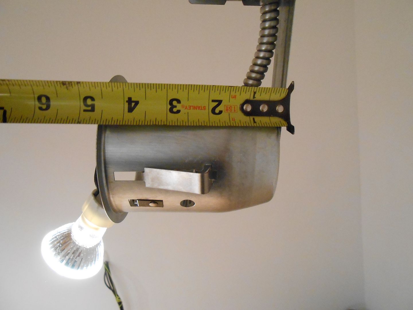

it is a 3.875 hole saw, I think I ordered it from Amazon. It's funny I think I've used three different cans from Lowes and they never seem to sell the size hole saw that fits their lights.
On this project I'm using the 4 inch cans with the connection box on the side, they are shorter than the 3 inch can which has the connections on the top. AND the connection box is HUGE in comparison. The soffits are 5 1/4 tall.
Yes on rope, still need to bang up lip on ethe front edge of the MDF to create a channel for the rope. Something about 2 inches tall.
For the record on the other three walls I cut all the holes when the MDF was on the ground, I can only take overhead cutting long enough for one photo op.
Thanks for the info. Those are the exact same lights I am using in my soffit. My soffits are 5 1/2" high, so I was very happy to see that I am not the only one with a "short" soffit. I am curious to see what you do for the lip that will hold the rope light. I have been playing with a couple of ideas, but nothing that I am crazy about yet.
Off to Amazon to order a hole saw!

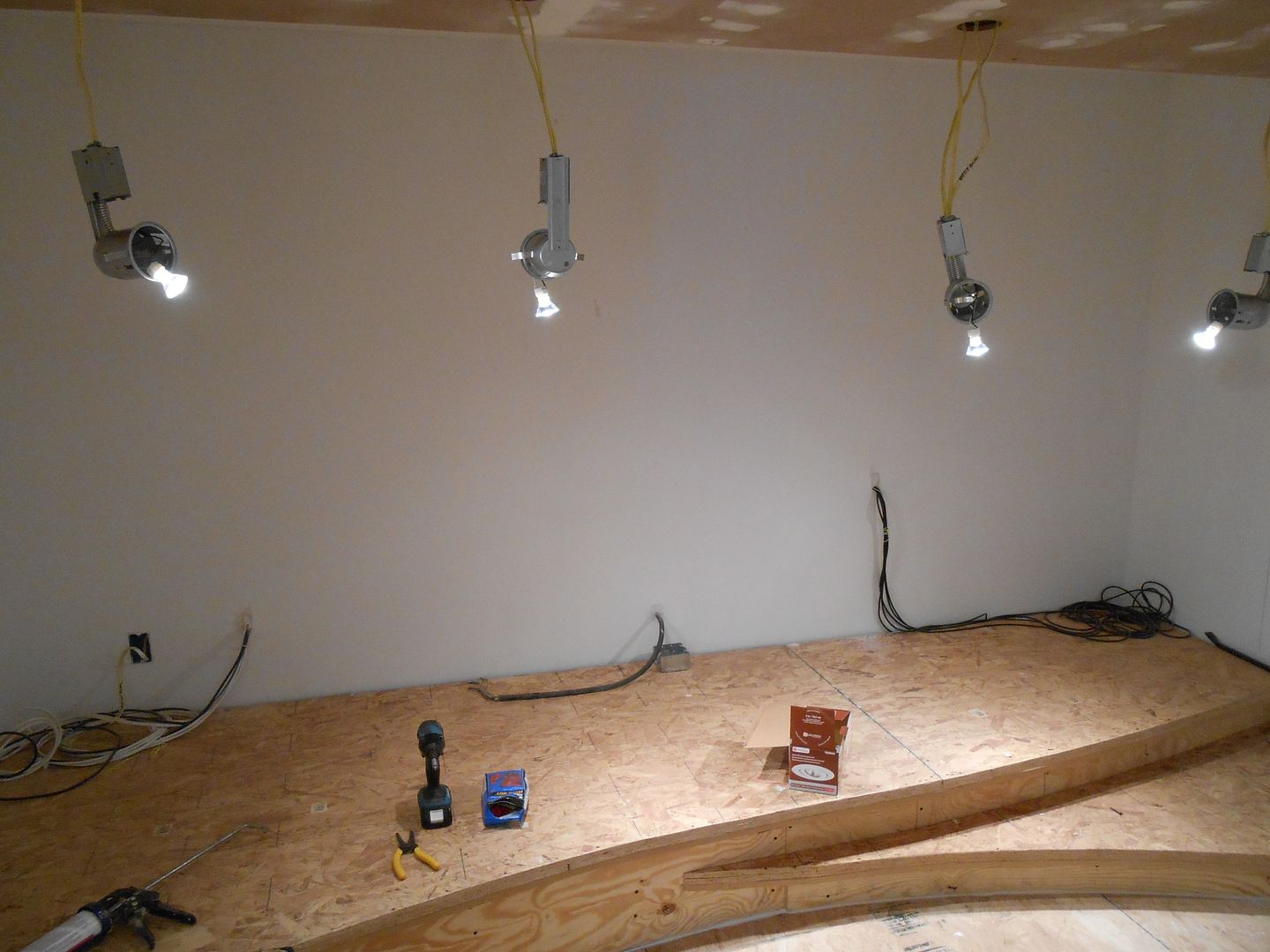

Today's big task was hooking up and installing the 14 reccessed lights.
I like to test them before I slide them up into the ceiling.
Zone 1 of 3, these are over the screen
These are my current favorite lights for limited headroom. Pretty easy to install lights. A Lowes Utilitech 4 inch can. Much bigger hook up box than the 3 inch can which has the connections on top.

Hey Big - I know I asked in another thread what bulbs you are using - Just wondering if you are using the same for this build?

I can tell you just by looking at them that those are GU10 bulbs, either 35 watts each or most likely 50 watts each.

35 watts. What is curious is our shipment (Lowes.com) came in two boxes. One box of 4 and on those it said bulb included and they had 50 watts. The other 10 said bulb sold separately and we have a case of 35 watts on order. Not sure what is the newer version they both had the same SKU. Just a FYI, it is rare to find enough on the shelf at one store to do a theater.

Here is the info on the bulbs we ordered at 1000bulbs.com
MR16JDR-9817FP Hikari JDR-9817FP - 35 Watt - MR16 - Flood - Frosted Capsule - GU10 Base - 2,000 Life Hours - 120 Volt.

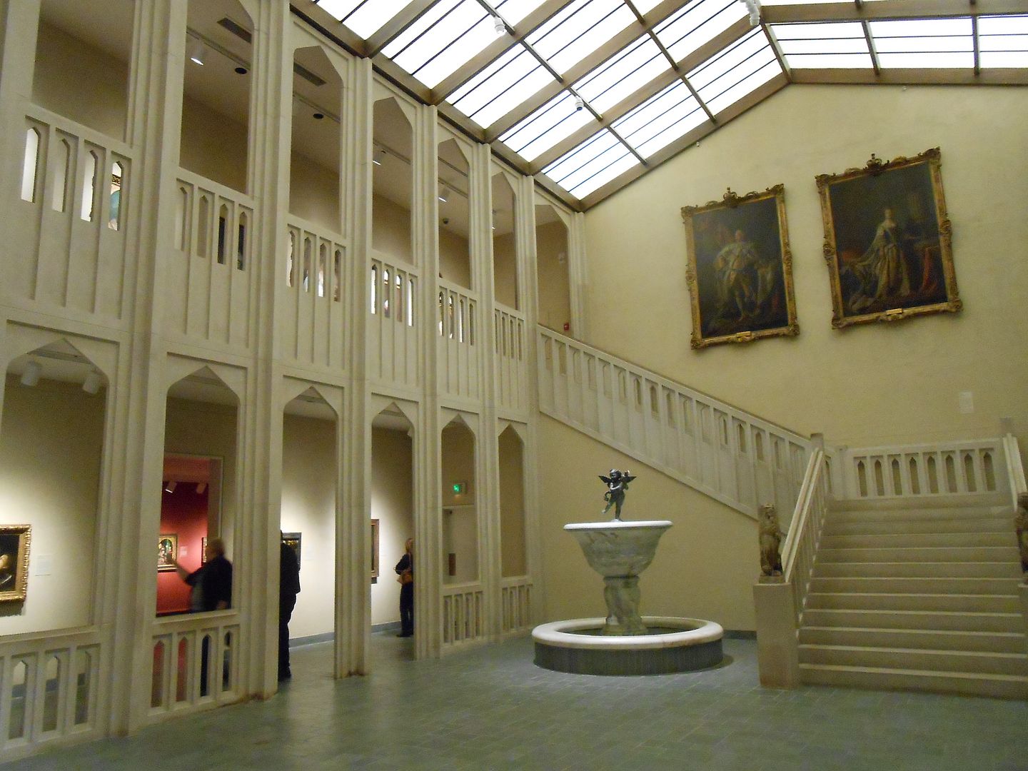

After working on this space nine days straight I took a day off. Went to Indianapolis Art Museum for design ideas and had lunch at Fountain Square.
Look at the design ideas for molding in these frames

The Mexican food must have been real good, or real bad because there have been no updates on their progress since.
How exciting can it be to look at pictures of outlets and fishing wires in the wall? we should get back to real things like columns soon. Then the wall treatments and monster door.
