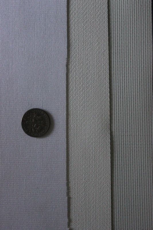

For an up-close comparison, here are a few samples I received during the course of my build. Obviously, a better comparison would be with a projected picture as well some acoustic readings, but this will at least show you that not all AT screens are the same.
From left to right: Elite AcousticPro-4K, SeymourAV Centerstage XD, Elite AcousticPro 1080P2

I almost hate to step into this, but I will before I get another cup of coffee and think better of it.
I like hard data, too, and I read the paper linked above. My take is the only attribute that would seem to apply is the contrast ratio (from a video standpoint, anyway). I don't think the cross reflectance would be an issue in most of the theaters designed here, and even so, the argument could be made that if you're going with a cheaper screen, the cost of admission is black walls and ceiling. This now boils down to whether the newer woven screens have improved on their ability to reflect light back to the viewer through a tighter weave, better coatings, secret sauce, etc.
It doesn't seem like there is enough analytical data on the new screens to make a call there. I don't doubt that a perforated screen is brighter. It just makes sense for it to be. However, considering the cost of admission for a "good" woven screen. I think it may very well fall into the buy it now and upgrade later category. In this hobby, we don't think much about upgrading a several thousand dollar PJ. I think buying a $300, $400, or even $500 woven screen for now, and upgrading later to a perforated screen seems downright sane in comparison to upgrading a PJ.

Join Date: Jun 1999
Location: Toronto,Ontario,Canada
Posts: 4,402
Quoted: 44 Post(s)
Liked: 42
It is curious that that paper uses real branded microperf screens but compares them against some random "Woven AT fabric". What were the specs on this fabric? The Studio 130 perf is something like 1.15X gain. The Seymour AV screen is 1.2X gain. So, the ANSI white levels should be similar on these two screen surfaces.
This seemingly fundamental point is entirely glossed over, throwing all the subsequent conclusions into question.
I also wonder why they would put the black scrim for the woven screen in-between the screen and the speakers, rather than behind the speakers?
vikgrao likes this.
