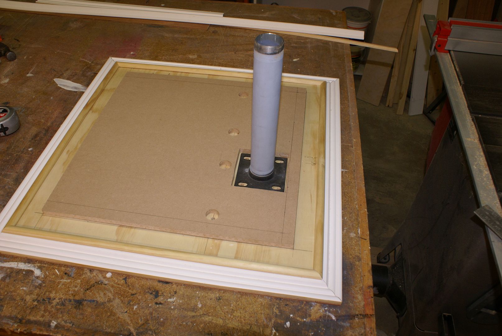

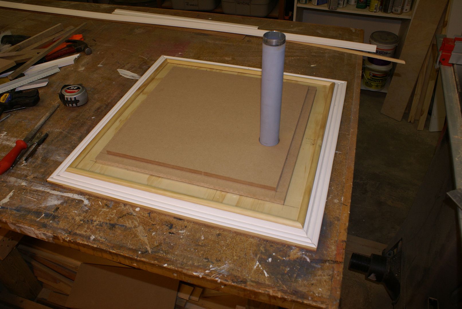

ALL my wires come down the down rod of my Chief Mount. There is a way to do it code legal and then there are shortcuts. Code legal would involve a hidden recess in the ceiling with an outlet side by side with the LV box. You cover that recess with a REMOVABLE plywood hatch that the projector mount is attached to and bring all the wires down the tube.
