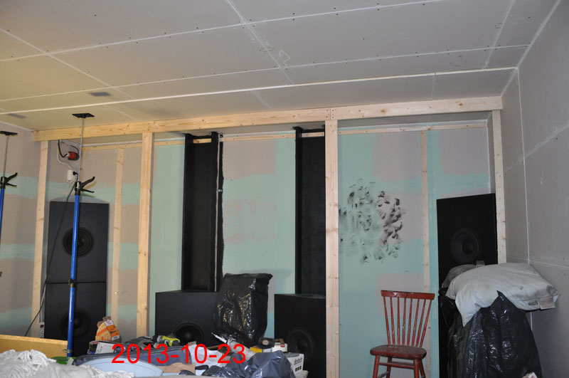

Have caught up with what I planned for had I been home last weekend. Getting closer to planning how to get the insulation for the dampening walls up better than last time. That's a little benefit of getting to do it another time - can adjust those things that didn't come out all that well in iteration one. Going with more solid pillars for the screen and not round this time, so the reflections will be directed rather than always having one as per the round ones. (Diffraction you can't escape anyway...)
Done everything I can on the door, it's had some effect, now it's at the same level as the original walls surrounding it. Will need a double door later as already specified, but it's definitely improved. ( I'm actually wondering if it's not dampening more towards the outside than it is from the outside and in, if that's technically possible, due to the difference in surface material... the sound hitting the door from the outside would vibrate the door and the soft material will move with those... but the sound hitting the more flexible inner surface, might it not possibly deform that material as well as trying to move the door? )
Had my fronts hooked up and enjoyed a few tracks of music, including Stairway to Heaven at an average dB in the seat of just above 90dB (both A & C, fast) and I could actually imagine increasing the volume even more.... bloody good speakers these! Will be nice to try that again in a while with the subs in, drum kick will benefit a bit. tongue.gif

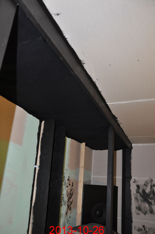

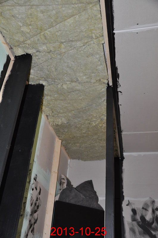

Besides some painting, I've gone at dampening the ceiling right above the speakers:
70mm (3") rockwool:
Black felt:
Under construction: the Larch theater
