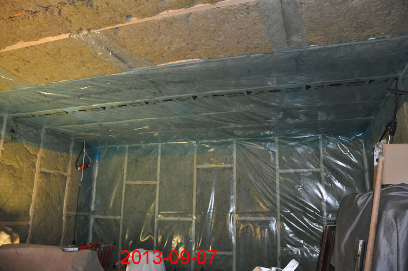

post #183 of 739 Old 09-07-2013, 05:05 AM - Thread Starter
Nightlord's Avatar
Location: Southern Sweden
Posts: 2,483
Quoted: 759 Post(s)
Liked: 261
Originally Posted by just jim View Post
The usual method is to get everything ready, the plastic sheet lined up perfectly, get the first staple in, only to find that you are out of staples. biggrin.gif.
Just cut the first piece of plastic (2m70 wide on the roll. 4m75 cut off to have 30cm hanging down on the sides).
Checked stapler - 4 staples left. Are you psychic, or are you perchance related to THE Murphy? biggrin.gif

post #185 of 739 Old 09-08-2013, 05:20 AM - Thread Starter
Nightlord's Avatar
Posts: 2,483
Quoted: 759 Post(s)
Liked: 261
Having a bad cold this weekend, so sweating profoundly over the slightest of work, but slowly entering Dexter-territory now.

post #186 of 739 Old 09-08-2013, 09:33 PM
just jim's Avatar
Join Date: Oct 2012
Location: Toronto
Posts: 412
Quoted: 74 Post(s)
Liked: 51
Just make sure to cover the speakers. Don't want them splattered and smelling of bleach! wink.gif
Well done! Looks like you kept parallel to the joist within a cm!

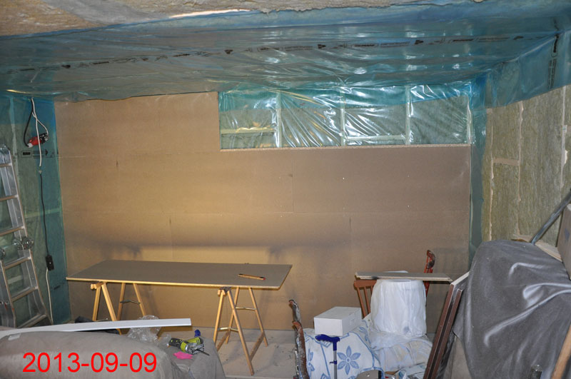

post #188 of 739 Old 09-09-2013, 01:27 PM - Thread Starter
Nightlord's Avatar
Posts: 2,483
Quoted: 759 Post(s)
Liked: 261
Almost a first layer on front wall.
But must confess that top one was difficult to put, so the next one that has to go into tongue&groove on the side of it will be even worse and for the last one, I'll have to cut off the T&G sideways to even have a shot at it.
But with that said... the pieces put has been much easier than anticipated.
It's 18mm fibreboard that's meant for flooring... the OSB comes in too big boards, so I figured 18mm of this might be close to 12mm of OSB... Might be wrong, but please let me delude myself if you know contrary...

post #189 of 739 Old 09-10-2013, 03:08 PM
just jim's Avatar
Join Date: Oct 2012
Location: Toronto
Posts: 412
Quoted: 74 Post(s)
Liked: 51
If you put the 1st top piece on the right, then you could cut the back of the groove off and still have overlap on the side joint. biggrin.gif The front of the groove would be against the tongue.
I assume your OSB has large chips of wood, like our. Is your fiber board compressed saw dust? Which we call particle board...and you use it for floors? eek.gif Tell me there is actually fibers in it...

post #190 of 739 Old 09-10-2013, 11:40 PM - Thread Starter
Nightlord's Avatar
Posts: 2,483
Quoted: 759 Post(s)
Liked: 261
Ah... that was a solution I didn't contemplate. I'll try it next piece that needs it.
Front wall is done now. Have brought out the caulk gun again to do the perimeter before I start on the walls. It will be a good overlap, the crack is about 10mm at the widest, so the wall boards will cover that nicely. smile.gif
It seems like these boards have different layers. The surfaces are definitely compressed saw dust, but the inner part have larger chips like OSB.
I think they are Norweigian made by "Forestia".
I believe OSB has larger chips and they are aligned, this is probably a bit more random?
I found they carried 12mm now too, I'll probably try that one for the ceiling, it will be less difficult to lift, these 18mm ones are just on my limit to handle safely. I'll go check the renting place to see how small lifts they have, if I can get one home and in at all.
