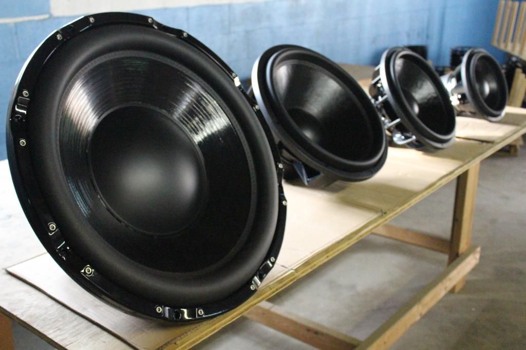

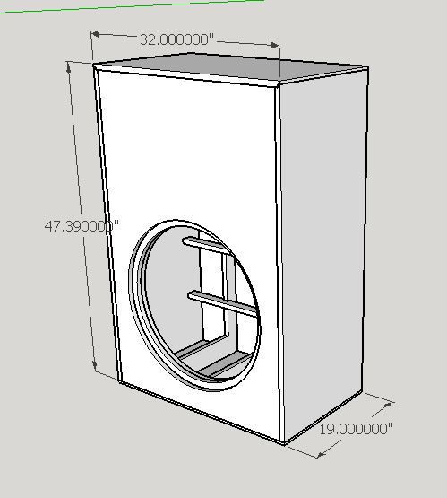

One of the things I have been working on behind the scenes are custom sub cabinets to house the two Stereo Integrity HS24 subwoofers I will be installing in the front baffle wall. Given the width of my screen and the width of the Procella P610 LCRs, I was left with about 35" between the center and the respective left and right speakers after framing and back boxes were taken into consideration. I wanted the depth of the box to be as shallow as possible to maximize my room size and viewing distances. With the driver being 13.5" deep, I had heard that the box could be as shallow as 15" deep, which was great. For height, I could literally go up to a full sheet height of 8' which gave me quite a bit of design flexibility. I have the sub driver located at the bottom of this vertical cabinet so the driver will not fire behind my screen but under it.
I ended up connecting with Andrew (Gorilla83) because he is very knowledgeable when it comes to DIY speaker box design and has his own CNC machine in his workshop. Fortunately he had the time to tackle this project. Once I gave him these max dimensions, Andrew set about tweaking the box dimensions to maximize performance while optimizing sheet material. The first thing he did was increase the depth of the box to give the driver a bit more room to 'breathe'. Next, we maximized sheet stock by going 32" wide on the box so three panels could be cut from one sheet. The 48" max height dimension was also selected to improve sheet material yields without sacrificing driver performance.

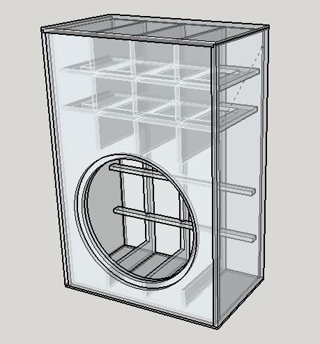

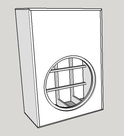

In the end I will have a 12.3 cubic foot box that measures 19"D x 32"W x 48"H. Each box will take 3 sheets of 3/4" MDF and have a triple front baffle, a single layer of 3/4" for all other walls and a heavy duty internal bracing matrix.
This is not the final design, but very close. The walls of the three vertical internal braces will be opened up, all inside corners of the braces will have a radius for strength and the bracing around the driver will be "u" shaped for even greater bracing stability. All joints will either be dadoed or rabbeted. Andrew will also add in the Speakon connector.
Boxes will be cut in the next 8-10 weeks. Here's some Sketchups of the box design.

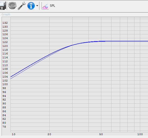

I had the option of creating a 15 cf box that would necessitate another 2 sheets of MDF, but the payoff was only an extra 1db at near infrasonic frequencies. I decided it wasn't worth the extra $400 to eek out that last ounce of performance. Special thanks Andrew and to John (LTD02) who took the time to model this box in WinISD. The difference between the two cabinets was only about 1dB for the same applied power. This graph shows the two different cabinets with 1500 watts each and no inductance effects--one is 12.3 and the other (the heavy line) is 15.0 cubic feet. John said this graph is usually a pretty good estimate of the very low end performance.
I should have 115db at 20Hz and 103db at 9Hz.....not accounting for the fact that there will be two of these beasts working together.

Very cool, Tim. It's interesting to me that the HS24 seems to work well in both ported and sealed enclosures. It seems that this driver is a nicely engineered woofer. I was skeptical when it first started making news; I assumed anything that large was going to have distortion problems and really just be a gimmick or have serious bandwidth limitations. It looks like that's not the case - so good news all around for those who can afford the space.
I imagine that there will be a build thread for this when the time comes? I'm sure Andrew would like to show what was possible - it looks very impressive.
Ported box size just starts to get really out of hand though...

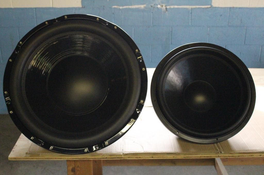

Yeah, I was closely following all the reviews, shootout results and general impressions from dozens of fellow AVS members plus a few professional reviews and they all came to the same conclusion: These 24" drivers are the real deal...and are the real deal in spades. 10 cubic feet is the minimum box size and 15 cubic feet is the recommended optimum box size for a sealed enclosure. I'm happy at about 12.3 cubic feet because I'm not giving up very much in terms of performance as the graph shows. Assembled weight is going to be pushing 400 pounds each.
I will be stopping by Andrew's house to pick up all the pieces when they are ready. He's going to leave them unassembled for easy transport. I won't create a separate build thread, but I will post photos of the construction in this thread FWIW. I might ping Andrew to see if he can take some pics during the CNC process so I can post them here.
I had the opportunity to visit Nick at the Stereo Integrity headquarters about 30 minutes north of me and see the 24" in action on the test bench when the driver was first released last year. I brought my DSLR and took a handful of pictures. The only thing I kept thinking was how the 24" made the 18" look like an 8" midrange driver. Yes, that's their 18" driver sitting right next to the 24"!
