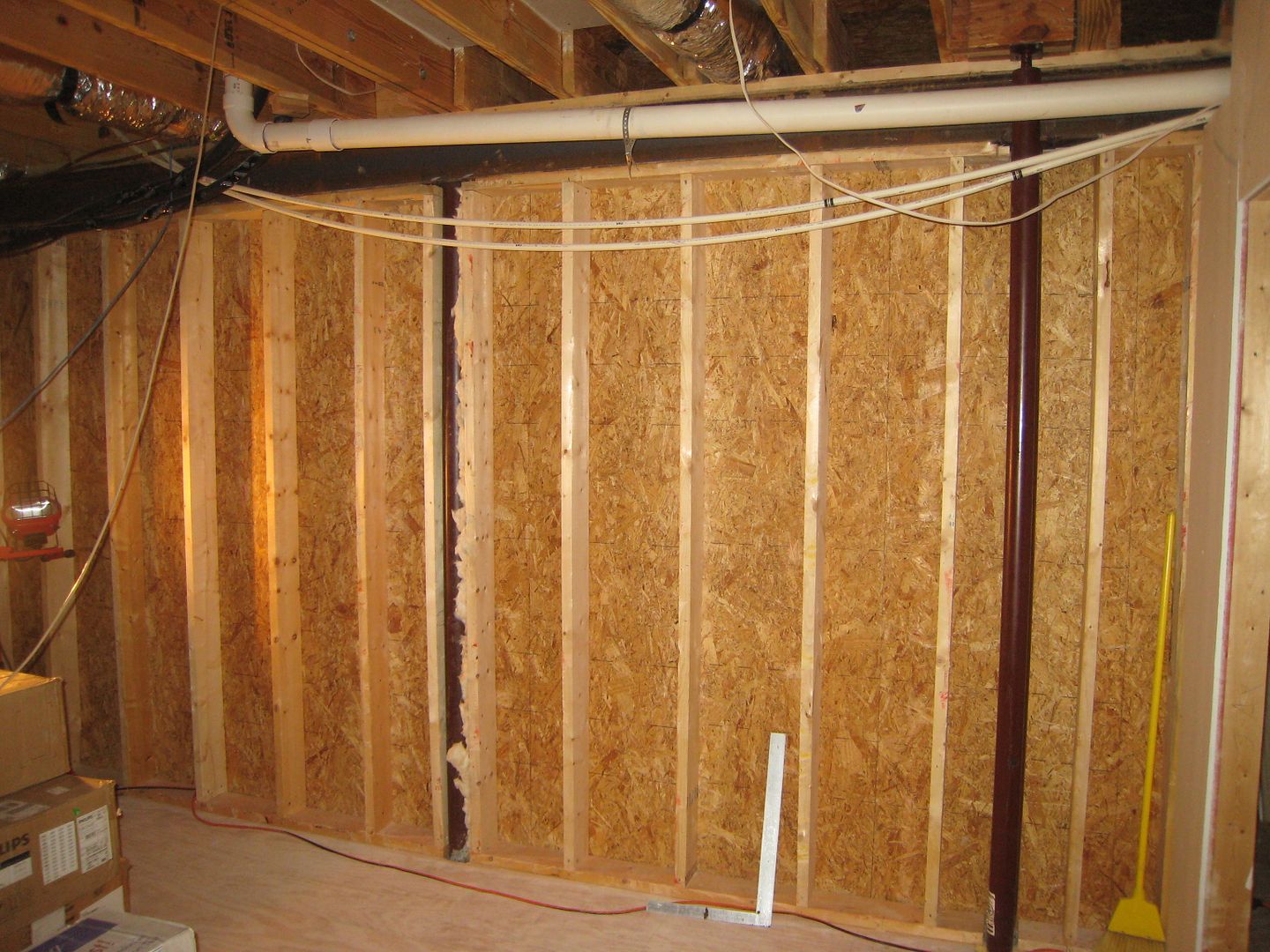

Deconstruction - Day 1

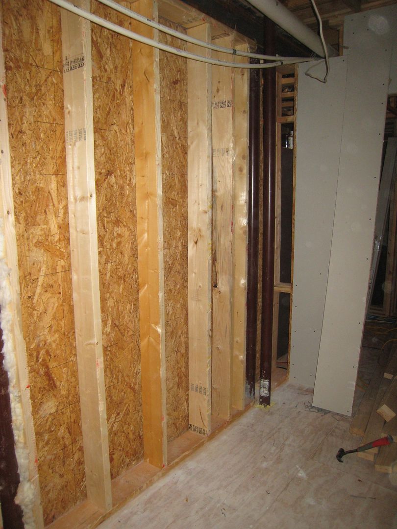

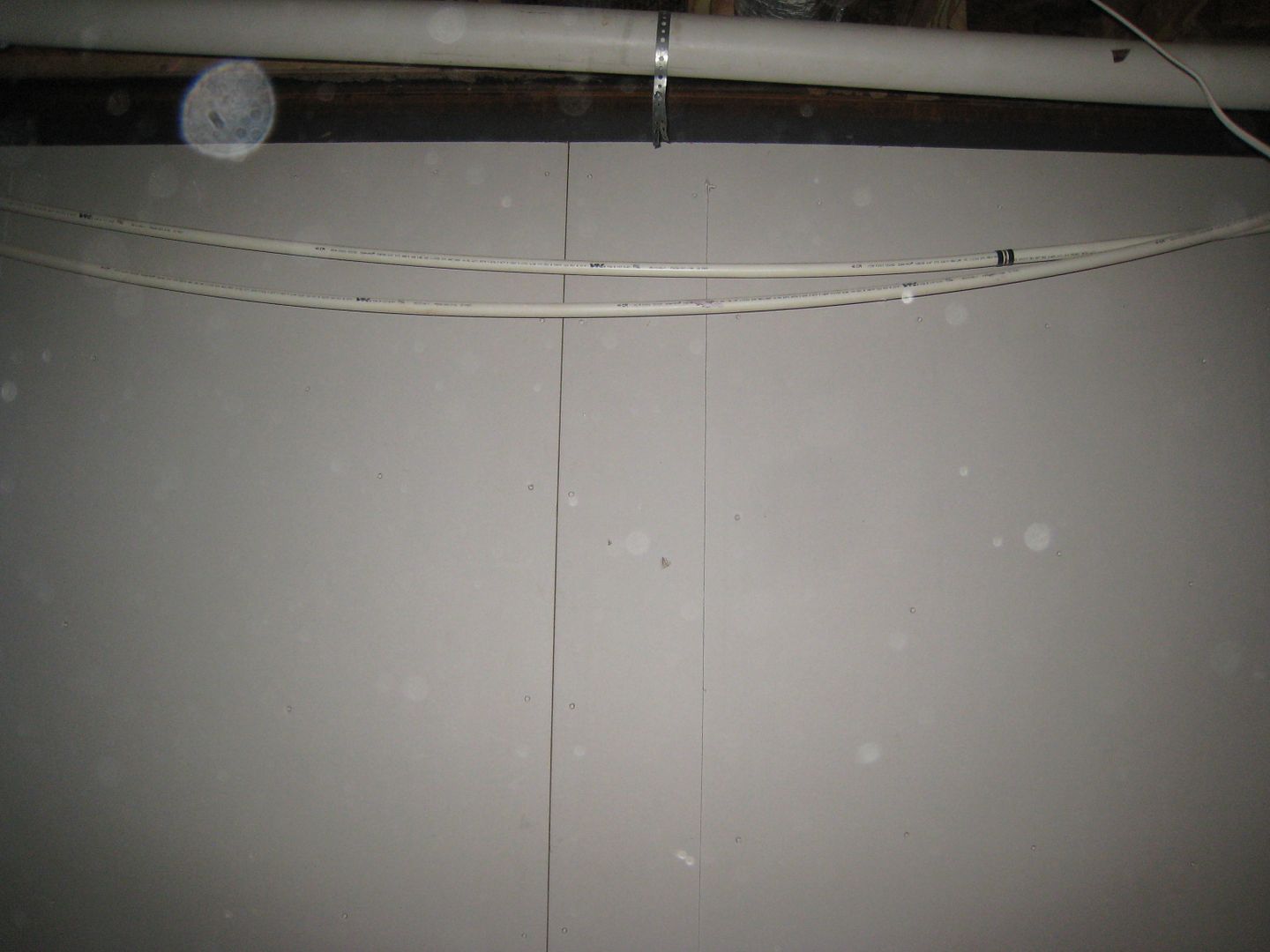

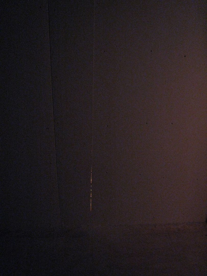

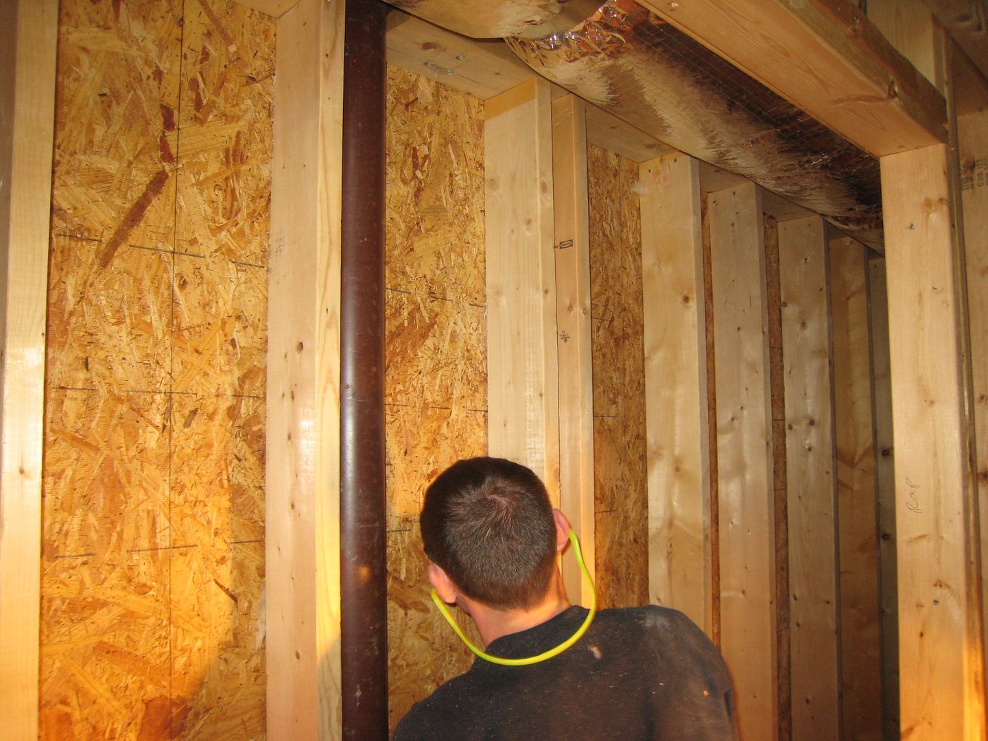

Well, the day I was waiting for finally arrived....deconstruction. Just in case you are new to this thread, I previously added a layer of 1/2" OSB and 1/2" drywall with Green Glue to the existing house framing back when I was going to build a high-value theater. Enter scope creep and...well...here I am.
The primary reason I am removing the decoupled framing is to remove these two layers of sheet material from the original framing and avoid the Triple Leaf Effect which can dramatically reduce soundproofing effectiveness and potentially introduce resonances. Quite literally, there is a 10 STC improvement by going with a double leaf wall vs. triple leaf. The Green Glue Company has an excellent white paper explaining this effect HERE. With the LFE firepower I have going into the room, I wanted to do the best job I could with sound containment.
The other reason is to recapture about 5-6 inches of usable room width I left behind because I didn't want to trim down all the closed cell spray foam on the right wall. The rookie installer mistakenly sprayed 6-7 inches of foam depth vs. the 2" I paid for. Cutting down the foam and recapturing this room width will allow me to use 4" deep acoustic treatments vs. 2" without any loss of finished room width.
I was fortunate to have @24Changer help me with today's deconstruction. This was a two-person job almost every step of the way, without question, and I GREATLY appreciated his skilled help. He'll be back tomorrow for day 2. Now on to the pictures.....
Today we focused ONLY on the rear wall. This is how the back wall looked this morning with the drywall/GG/OSB sheet material behind the decoupled wall.
I had used a bit of Liquid Nails under the bottom plate and was very concerned that cutting through this adhesive was going to be difficult and take forever. With Kevin on the Sawzall, I was using a series of pry bars to lift the bottom plate as much as possible to make the cutting easier. To our surprise, I was able to pop the bottom plate off the subfloor using only prybars. Loosening the entire wall only took about 15 minutes. What a relief!!
Since I used screws, the wall disassembled fairly quickly.

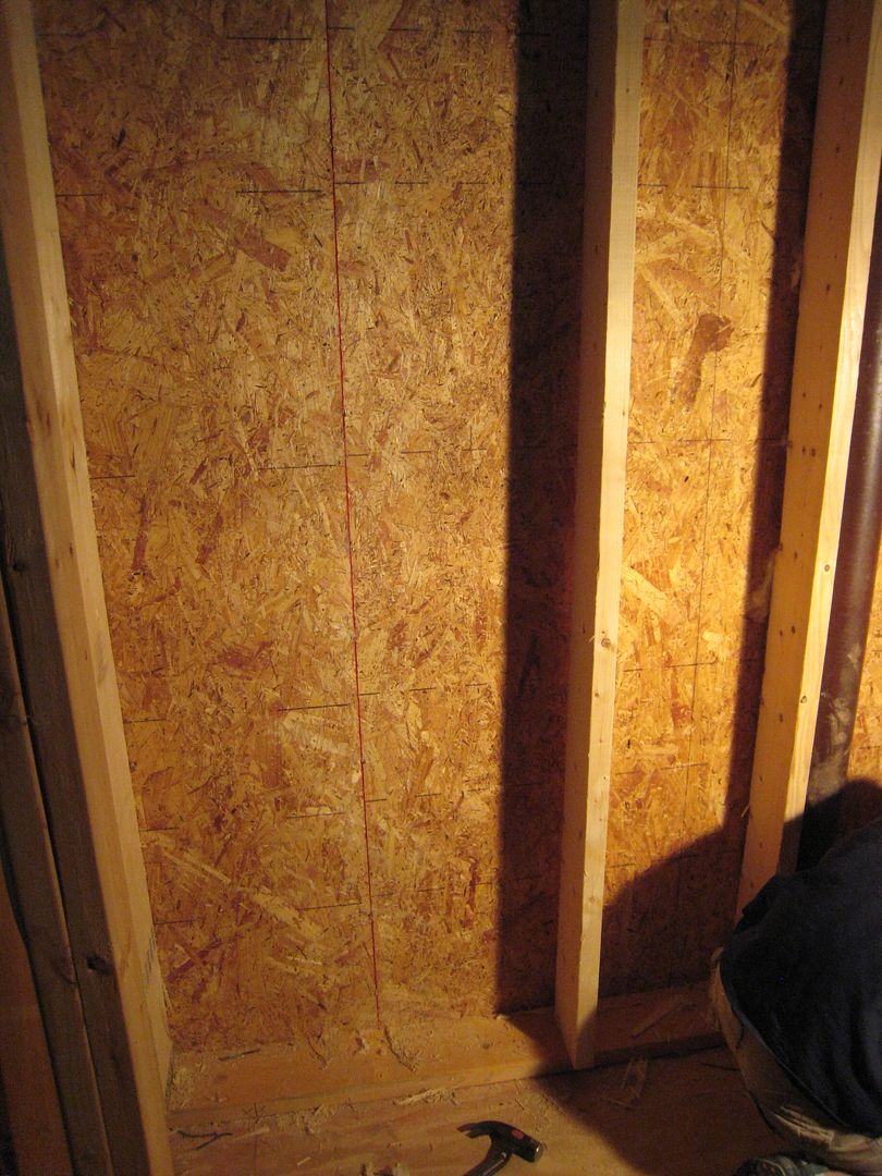

With me working the prybars and Kevin working the Sawzall, we were able to cut through all the screws that were holding the OSB to the back side of the framing. It was slow going, but we kept at it.
We ended up removing the entire stud at the vertical OSB seams.
I bought a thin-kerf Sawzall blade and was able to run it right down the seam, with the factory edges of the OSB as a guide. You can see the light poking through.

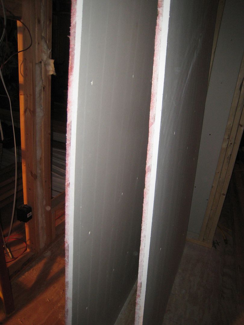

Here you can see the same cut (with flash) and you'll notice I removed all the screws holding the drywall to the OSB. The Green Glue has permanently bonded the two layers and I will be going through both layers with a single 2" drywall screw when reinstalled on the back side of the rear theater wall.
First perfect 4'x8' piece removed!!
Here you can see just how cleanly we were able to remove the pieces in-tact for reuse.

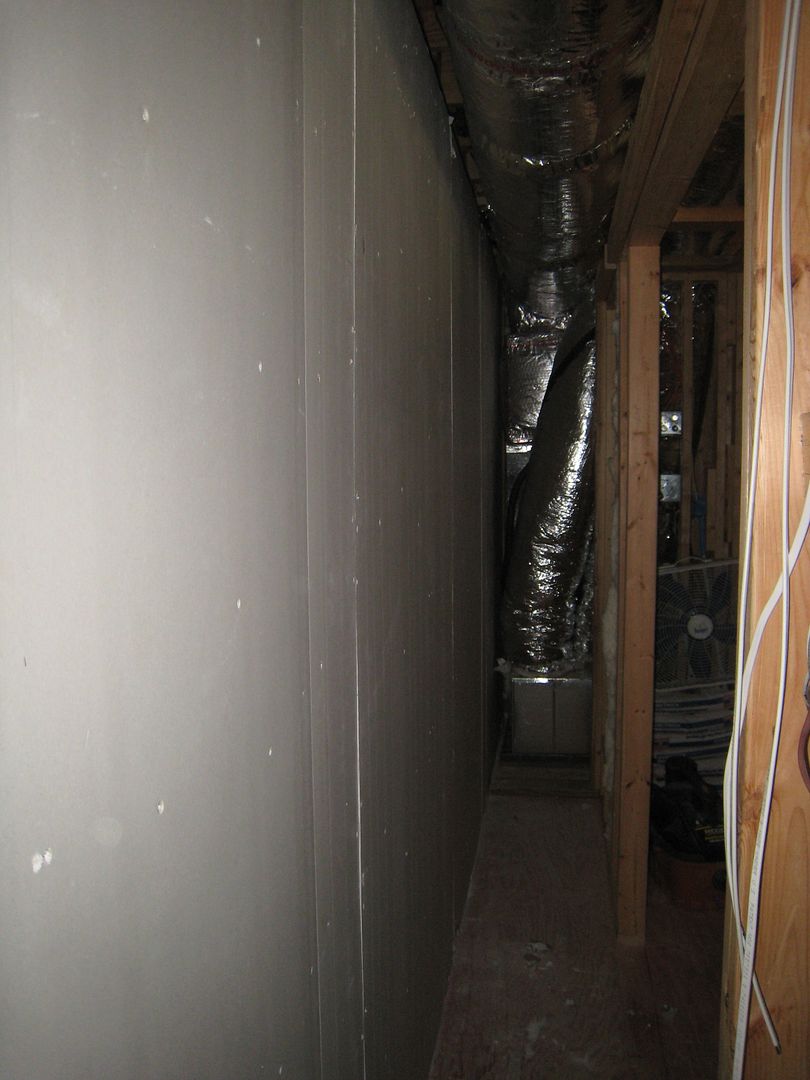

Here's a close-up look at the carnage after removing all of the sheet material from the rear wall. You can see I ended up with four full 4x8 sheets plus a small extra piece. Each 4x8 is HEAVY!
Another view of the rear wall

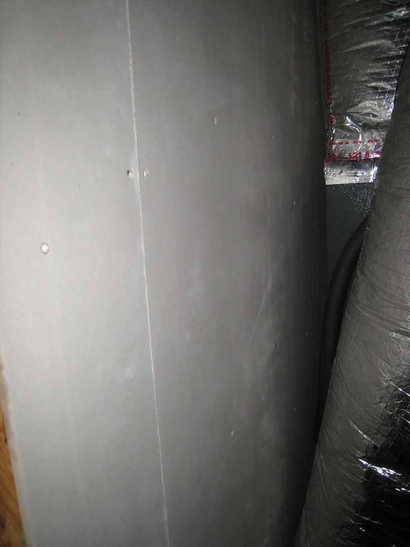

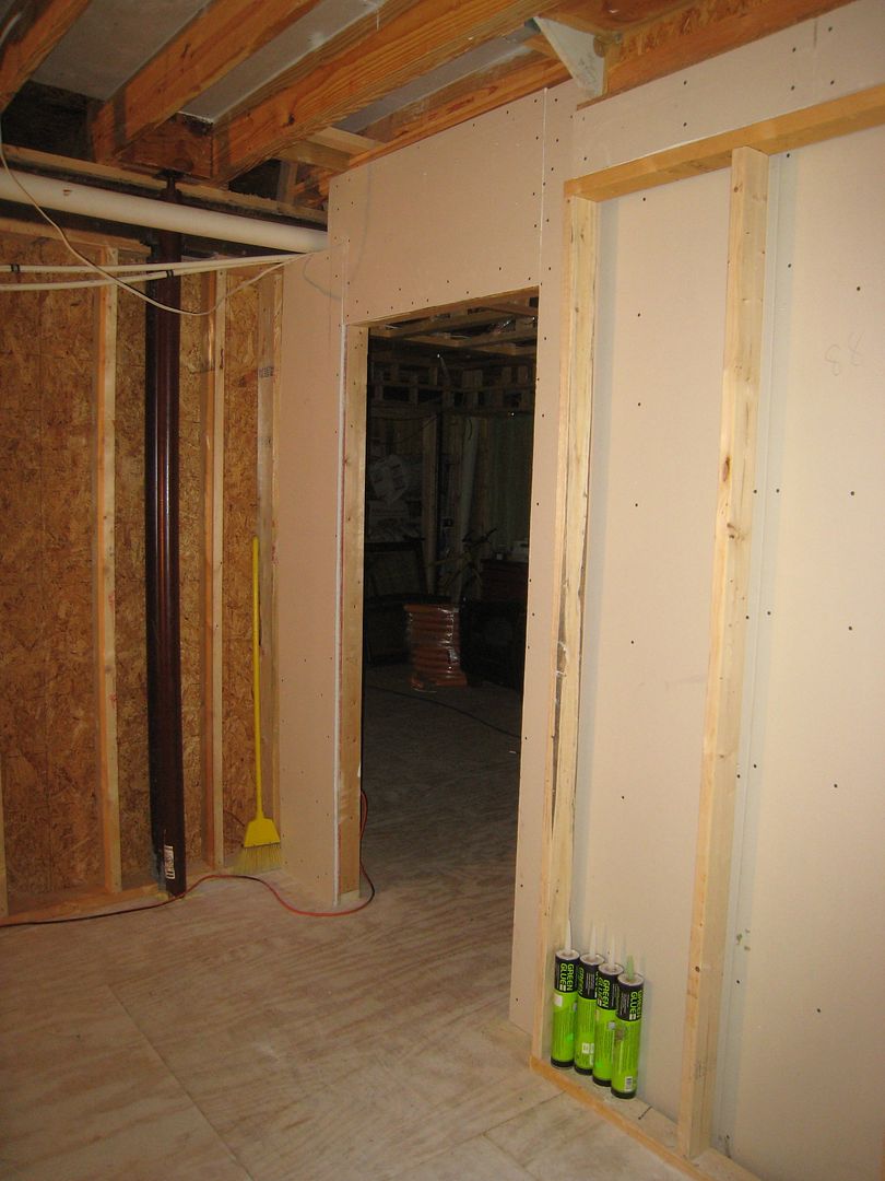

We reinstalled the studding we removed and shifted all four pieces onto the backside of the wall, ready for re-installation.
There wasn't enough room to get these 1" thick sheet sandwich pieces behind the HVAC unit, so we has to improvise with removing the surrounding framing, cutting a path through blocking and working together to move the entire HVAC unit about 2 inches, pictured below. It took a little work, but we were able to get the needed room to install the sheet material. I'll have to figure out something fancy to get everything reattached properly, including all the studding we had to remove.
Studding around the HVAC needs to be reinstalled...I'll probably get to that tonight or tomorrow morning.

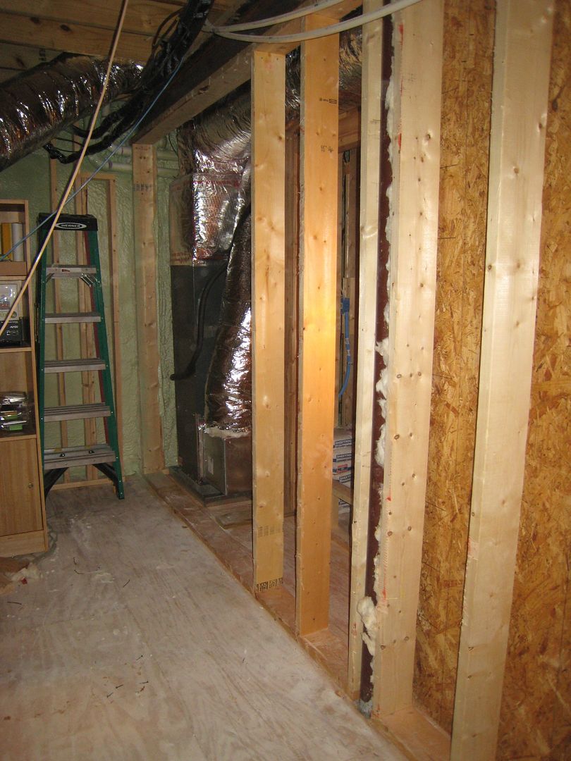

Tomorrow's goal is to remove ALL the remaining framing, plus the sheet material along the left wall. I think it's doable now that we've worked out the process. From there I will be cutting down the foam to the proper height, re-framing, adding decoupling brackets to the wall framing, insulating and then skinning the room. Today was the spark I needed and I look forward to keeping up the pace and have a finished shell over the next few weeks.

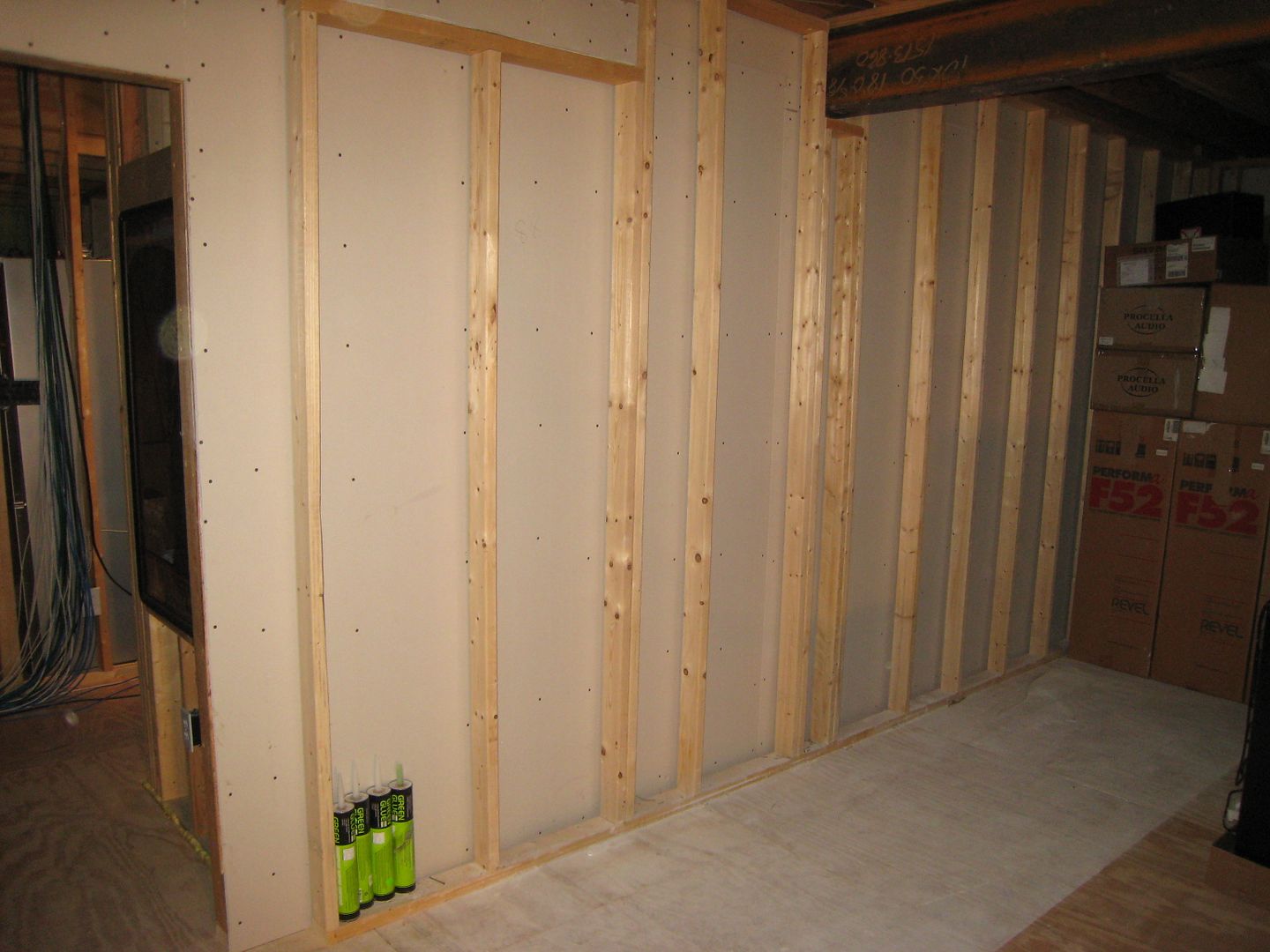

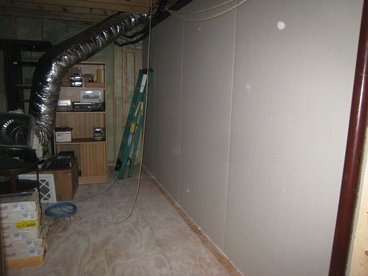

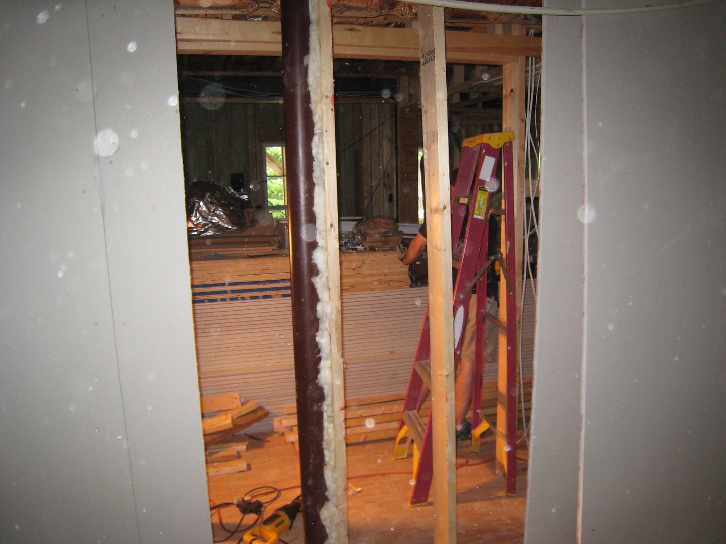

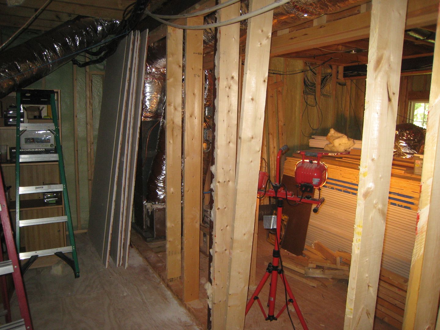

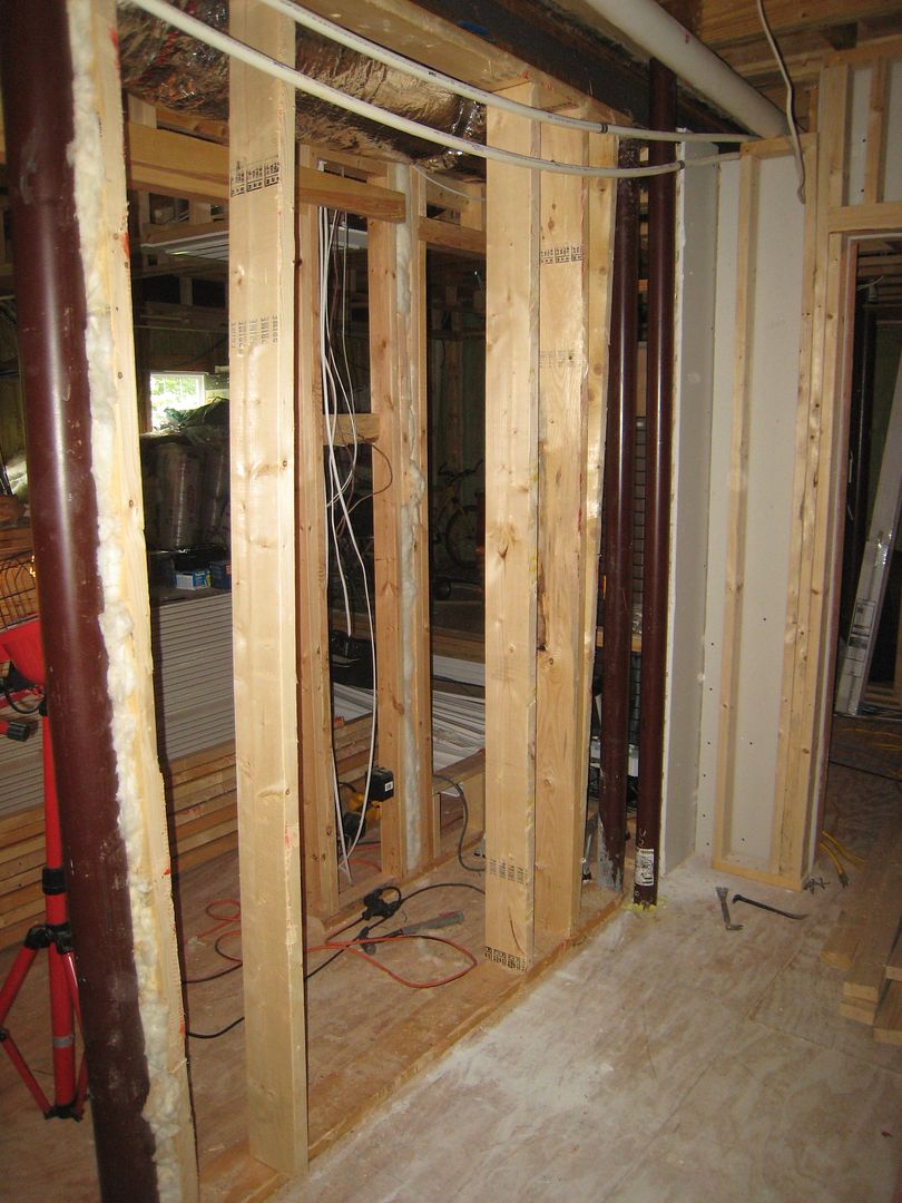

Deconstruction - Day 2

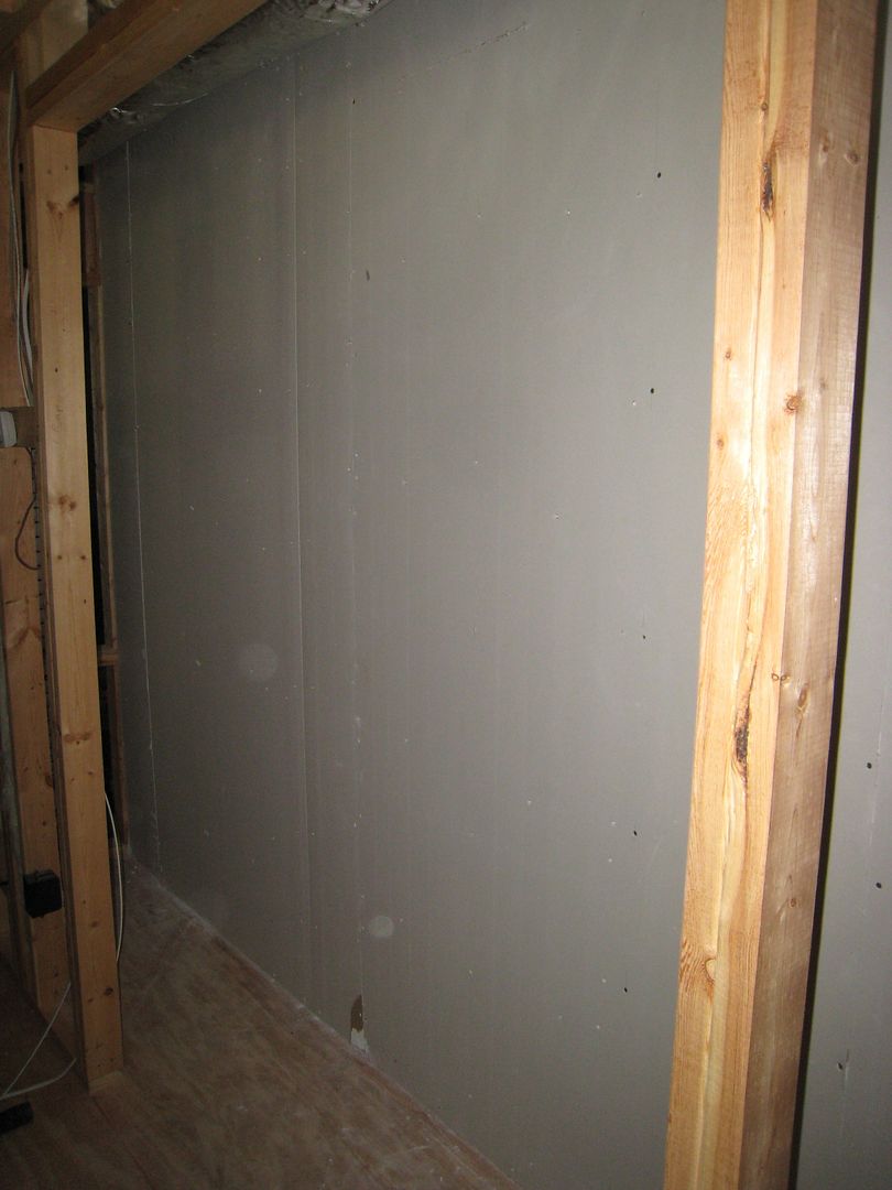

Well, today was another productive day. @24Changer came out again and I cannot thank him enough for his help. First order of business was to get the rear wall put back together. Here's the final result as seen from the theater:

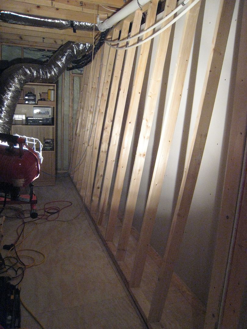

And from the back side:
The most difficult area to address was behind the HVAC. After thinking about it last night I thought the best way to handle this area would be attach the studs to the back of the sheet where we had full access and then slide it into position and secure the studs to the top and bottom plates. This is exactly what we ended up doing, although we had a few false starts and a few hiccups as we discovered new obstacles to execution.
A couple more shots. I have to say it looks like a new install vs. repurposed sheet goods.
We removed the framing around the accessible area near the door:

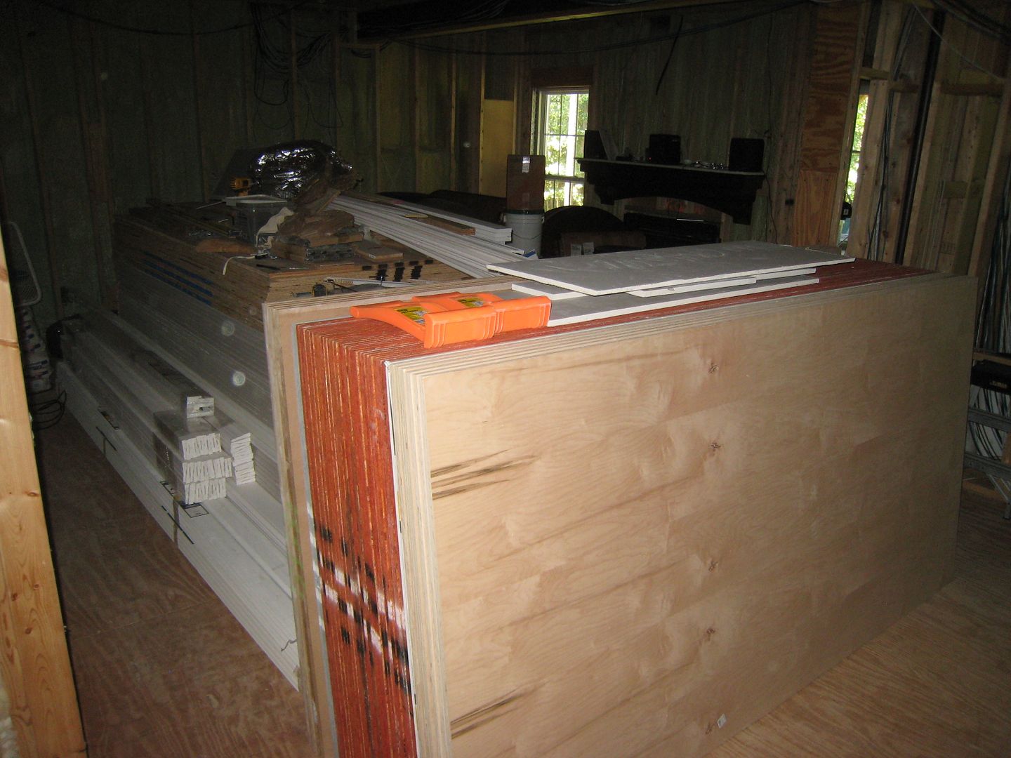

We couldn't go any further until we moved the gigantic pile of sheet goods intended for the theater, including 24 sheets of 54" x 12' x 5/8" drywall. It's the part of emptying out the theater I was dreading most and again, Kevin was a HUGE help. We also did a bit of cleanup to give us room to work and places to put all the 'stuff' we were hauling out of the theater. Can you tell where the drywall was sitting?
Only part of my total supply stash (for both basement and theater)
So over the course of the next week I am going to continue emptying the room and remove all the existing framing. Once I get to the point of removing the sheet material on the left wall, I'll probably see if I could draft another helper as it's definitely a two-person job.
Oh, and @JVoth - you cracked me up with that comment!

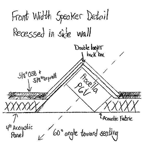

This coming week I will be building double layer back boxes with Green Glue and will incorporate these back boxes into the framing when I start the reframing on July 3rd. One note about about the backboxes......I will be building all the boxes for the side and rear channels four feet tall. The inner layer will be 3/4" MDF and will be drilled to accept shelf pins before assembly. This way I can adjust the side and rear speakers to any height I choose and even accept two sets of speakers in each box, if needed (one at ear level and the other angled toward the MLP from just underneath the soffit).
I had contracted with Dennis Erskine at the beginning of this project and he is currently busy updating my plans to incorporate Dolby Atmos / DTS-X, plus placement for all the 18" subs. The two 24" subs will be going in the front baffle wall. Dennis had suggested adding front width speakers and prewire for an 8-10 speaker ceiling array to cover the two rows of seating. Since I'd like to keep the front wall aesthetics in-tact, my only option was to move any width speakers to the side wall and angle them toward the MLP. I sent Dennis a quick TMcGoogle Sketchup rendering of how I would like to incorporate the front width speakers. I may have to open up the one side of the box to a 120 degree angle to not interfere with any audio energy on the left side of the speaker, but the basic engineering should be about the same.

I really like that Idea of recessing and angling. That would need to be one heck of a backer box to contain the sound this room will be producing. I'm glad that the deconstruction is almost done. When you look back, you'll be very happy you did it. Triple leaf is a very dangerous game, from what I've read.
BrolicBeast is offline
post #1375 of 1953 Old 06-26-2015, 01:38 PM - Thread Starter
TMcG's Avatar
Location: Earth
Posts: 4,006
Mentioned: 62 Post(s)
Quoted: 1182 Post(s)
Liked: 1000
Originally Posted by dlbeck View Post
Great progress. Keep it rolling!
Thanks! You never answered what movie you'd like to watch in a few weeks...
Yeah, that triple leaf effect would have irritated my selective OCD every time I walked into the room. I didn't want to live with any 'should haves' with this theater construction, especially when it comes to sound containment.
The back boxes will be 3/4" plywood for the outer layer and 3/4" MDF for the inner layer with Green Glue between the layers. That should provide plenty of damped mass and structural support. Since these will be 4' tall, I'll probably frame a bit of support underneath these boxes to take care of most of the weight.
I have given a lot of thought to having 3 layers all around like you did, but I am going to stick with two layers. The tradeoff with having the third layer is that you need much more bass trapping since the LFE can't 'escape' as easily. Given the amount of LFE vs. the size of my room, I don't think I have enough cubic volume for that much bass trapping.
TMcG is offline

Wow.
I'm very impressed with your removal and reinstallation of the wall material.
I'll bet you're glad you didn't stagger the seams of the OSB and drywall. I thought I remembered that was the preferred installation method for layered walls, but it's been quite a while since I read the recommendations on The Soundproofing Company's Web site.
M.T.Nest is offline
post #1377 of 1953 Old 06-26-2015, 02:11 PM - Thread Starter
TMcG's Avatar
Location: Earth
Posts: 4,006
Liked: 1000
Thanks! But I DID stagger the seams. The OSB was mounted vertically to the studs and I overlapped the seams at least 8" by vertically mounting the drywall to the OSB, not the studs. You can see the drywall seam and the thin kerf cut, where I used the factory OSB edge as a blade guide. In other words, I cut between the sheets of OSB but straight through the drywall. The blade created what appeared to be a factory drywall edge.
