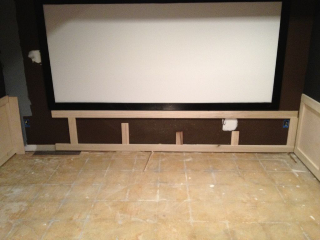

I already have my 7.1 system which I'll be keeping. I actually think it should be fairly easy. Just roll the velvet over at the top and staple from the back side of the velvet along the soffit/wall line then I'll staple along the side walls which will have acoustic panels and will hide those staples. Do the same for next row which will be near the bottom of the wall (only 6’6” between soffit and floor) and staple below the baseboard line; shouldn’t see one staple.

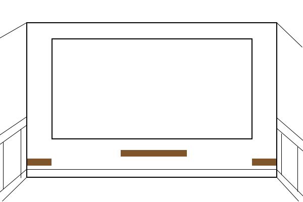

Here is a diagram to show where my floating/bracketed shelves will be.
And here is a shot that gives you an idea of the actual space. I should be ready in the next week or two so I’ll update this thread with my success or failure pics.
The screen above is just painted drywall and the velvet border will be removed shortly. Once the velvet is stapled on then the new screen can be hung

Is there any reason this wouldn't work?
Again the sides would be stapled from the front side of the fabric on the side walls because those will be hidden by acoustic panels above the wainscot. Where I will need to staple along the wainscot at the bottom the staples will be visible so I'll either hide that with a trim piece or just use a permanent marker.
Play like a Raven
design1stcode2nd is offline
post #28 of 41 Old 01-24-2013, 07:26 AM
Posts: 28,011
Mentioned: 259 Post(s)
Tagged: 5 Thread(s)
Quoted: 3823 Post(s)
Liked: 3253
If you don't get a line of staples exactly straight the fold won't be straight.
If you staple some stiff cardboard inside the fold you will get a better result.
