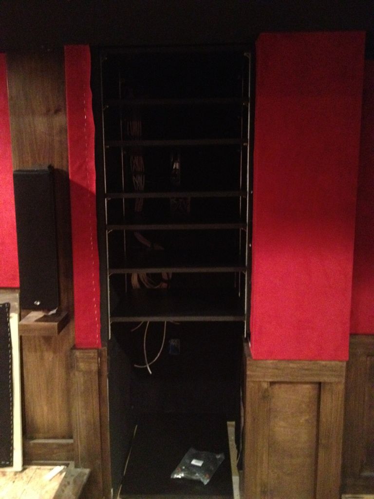

I forwent a stage and all the normal things associated with it. I wasn’t about to haul out sand and all the rest if my basement floods again.
As for sub and sand they make isolation mats, I would think that would be sufficient. Mine will be sitting on 4 isolation dampers, then on a MDF platform with rubber wheels on carpet and pad. No idea if that is going to be good or not but we’ll see soon enough. If that doesn’t work I’ll add an isolation mat between the isolation pucks and the MDF.
yeah; but, all of that will allow your sub-cabinet to move. Not good. A sub should be anchored to something with considerably more mass than the subwoofer itself.
I'll have Auralex isolation pads between the sides of the platform and the rack enclosure so the platform the sub is on won't be able to move around.
For reference the sub will be on the black platform on the bottom. I was worried about the sub moving around so I'll make sure it's wedged in tight..
