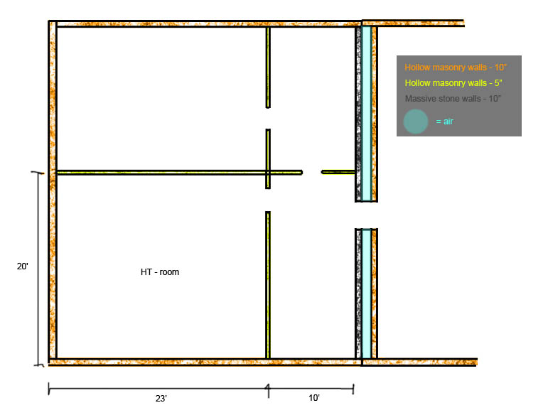

I'm planning my new home theater right now and like everyone here I'm having thoughts about soundproofing it, so I can bump the volume up without bothering anyone in the house and my neighbor who lives about 20 yd away.
Other than him I don't have anyone surrounding me, the HT room is at the far end of the house, no basement, but two rooms and a terrace above it.
Since the HT area will be added to the already existing house it has somewhat of a special connection to it.
The exterior wall of the house is a 10" thick hollow masonry wall. Then there is a 1 ft air gap and after that another 10" thick stone wall.
That's where the HT will connect to.
The HT itself has a 10 ft room next to it. So it is: "house -> 32" double wall with air gap -> room -> HT".
The exterior walls of the HT area are 10" thick and the interior walls are 5" thick hollow masonry walls.
Now I've read a lot in this forum and it seems most people build a decoupled stud wall with double drywall an it.
In my case I don't know if it is the right approach, since I already have the stone walls. And building it that way in addition would take a lot of space out of my room.
So my question is what is the best way to go and how much sound reduction would I get?
I thought about building just the wooden frame, fill it with insulation and add one or two layer of drywall.
The other idea was to build it staggered or going all the way of a double stud wall.
The whole decoupling thing makes sense if I would have just the drywall, but having the masonry wall I don't know if it is worth it.
I'm aiming for a good amount of reduction. It doesn't have to be totally quiet, but not as loud so everyone outside the room will hear what movie is playing.
Listening volume will be around reference level.
My primary concern is the overall volume outside the room. Low and subsonic frequencies aren't important right now.
I doubt they travel the distance through the entire building. And since I don't have anything and anyone else around my HT I'm not concerned about the LF/ULF. Or should I be?

post #12 of 24 Old 02-28-2013, 12:10 AM - Thread Starter
Detees's Avatar
Join Date: Jan 2013
Posts: 13
Originally Posted by warrenP View Post
you may want to post a top view image/diagram so we have the exact right configuration for your room - it seems to be unique so seeing it would be best.
Yeah, I thought my description of it would be some what confusing. It actually isn't that complicated. Here is a simplistic sketch smile.gif
Ehm.. and yeah... of course the will be doors. Their positions are not final either, so just ignore them tongue.gif

post #13 of 24 Old 02-28-2013, 01:03 AM - Thread Starter
Detees's Avatar
Join Date: Jan 2013
Posts: 13
The walls will be built with these bricks. Here an image for better understanding in case someone wonders smile.gif

Originally Posted by Dennis Erskine View Post
STC is a nonsense metric for this application. STC only considers frequencies from 125Hz to 4kHz. Furthermore, you cannot add two STC values to get the combined performance of two materials or two barriers. More to the point, you cannot take 85dB and subtract STC45 and expect 25dB outside the room. It doesn't work that way.
Did some testing yesterday, set the volume to 60db at the listening position and went walking around in the house with my SPL meter. I know that's not an accurate measuring method, I was just curious to see how much db I have in the different rooms.
The funny thing was, although the SPL meter showed 35db in the room next to it and 25db in the room below, I could still hear the music very clearly. I admit, the sound isolation with a drop of ~ 30db isn't really good. But I really think that -70db should be more than enough to reduce it to a non-disturbing level.
I found this picture of a wall construction like cinemas would have:
As you can see, it is a double wall concept with tripple drywall an each side and 2x 3" insulation with 1x 5" insulation between the walls. The rating is around -80db.
Giving that I already have the brick wall, I could save the first three layers of drywall and maybe get away with only one frame.
Something like this:
That should be a good start, don't you think?

start yes, Be sure to secure the top plate of the wall with isolation clips (IB3)
Now start thinking about the ceiling, floor, door, hvac ductwork and all the holes you might cut in the wall for outlets, lights, switches etc,

I thought about that, too. The ceiling would be similar to the walls. Except it's 8" cement + floating screed. The steel joist will have a batten attached to it, from which I will build the double ceiling off.
Same concept. Studs across the roof, filled with rock wool and with double drywall on it. I just hope it's not too heavy. Have to check with someone first.
Alternatively I could make the wall studs something like 4 by 4 's and set beams, so the double ceiling won't even touch the cement ceiling. Look at it as big wooden cage in the brick/cement room.
How much reduction can I expect from walls like the one I sketched above? More or less...
As for the decoupling part, I don't know if I have to use the clips or not and how much of an improvement it would make. For the ceiling and/or walls. Although what you are saying makes sens. The top of the wall should be decoupled from the ceiling or the sound will transmit over it. Thanks for pointing that out.
The thing I don't understand completely is how to seal the door or rather the connection where the door frame will be. Wouldn't that "shortcut" the decoupled walls?

You can build the ceiling completely decoupled from the rest of the house structure by resting it on top of your normal 2x4 wall, with double top plate. That'as what I've done. See my build in my signioture for some pictures and a link to a span calculator to make sure you use the right joist size.
If you haven't, look at soundproofingcompany.com and read about room-within-a-room.
