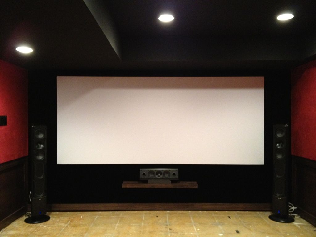

12x19.5 is plenty for two rows. If you are looking at a budget screen (below Carada in price) I'd recommend making your own. I think I made mine for maybe $150 and you could make it a tad cheaper and it's acoustically transparent if you were looking at a false screen wall or inwalls.
For reference the picture below is a 120" 2.35:1 screen in a 12'x15' room. That leaves me with about 15"-16" on either side of the screen after side treatments.

That looks great. What kind of speakers are those?
