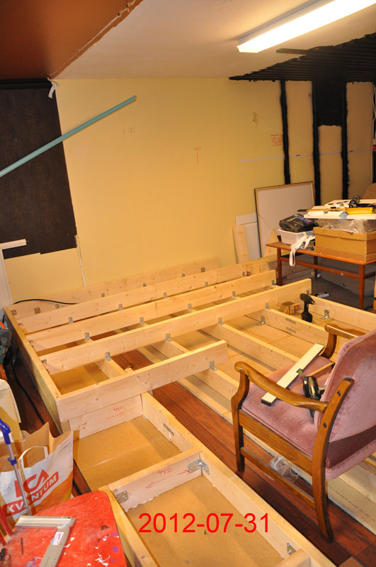

If you want it to double as a bass trap, you need to let air in somewhere.
I did mine with crossed layers of 145x45mm instead and my insulation required 450mm spacing. I myself is overly fond of angle brackets, so that's what I used and it seems rock solid.

I'm not too fussed re bass trap, but like the crossover design. I'm concerned about horizontal stability.

I'm planning to build mine with two layers of subfloor on top, to make it feel less flimsy. I wouldn't go so far as to rip down the joists I use to build it in order to allow room for two layers, but I'd try to use the dimensions that would allow two layers to come out to the right height. Horizontal stability shouldn't be a problem, especially once you screw (not nail) the subfloor to it.

Top was three layers of 5/8 OSB with green glue between layers, Stuffed with insulation, vents cut for bass trapping at wall riser intersections,

I like the way you used smaller timber and supported it in the center. Save money and weight.
