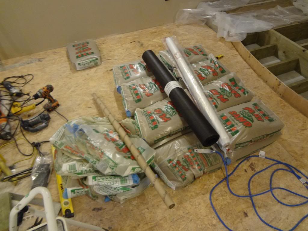

Productive day.
Finished hanging the backer boxes last night, got all the insulation up this morning and cleared out the theater room. Also got the smoke detector extended and putty padded.
AC guys came, installed all day. Drywall guys came, brought 100 sheets downstairs.
Plumbing inspector came, passed the in-ground rough-in inspection. Then I filled my holes with gravel
Mixed up some concrete
And 2 trips back to home depot later, finished concreting my holes.
I think that's probably it before vacation. Gotta pack tonight, then drink some scotch tomorrow night, then off on Friday.

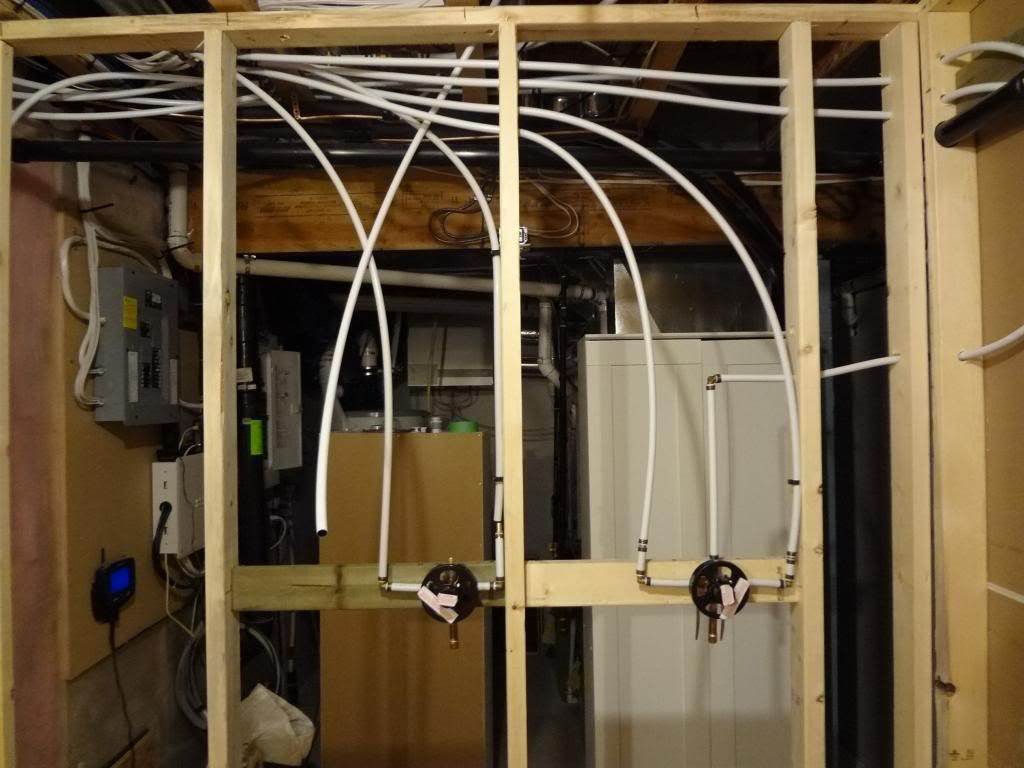

-Put down underflood heating in bathroom, covered by layer of self-leveling cement.
-Built wooden shower base

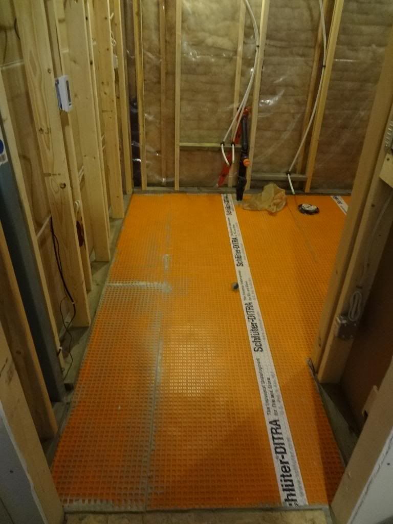

-Laid down the orange Deitra stuff that goes under tiles in the bathroom.
-Got all the rough-in plumbing done in the bathroom.

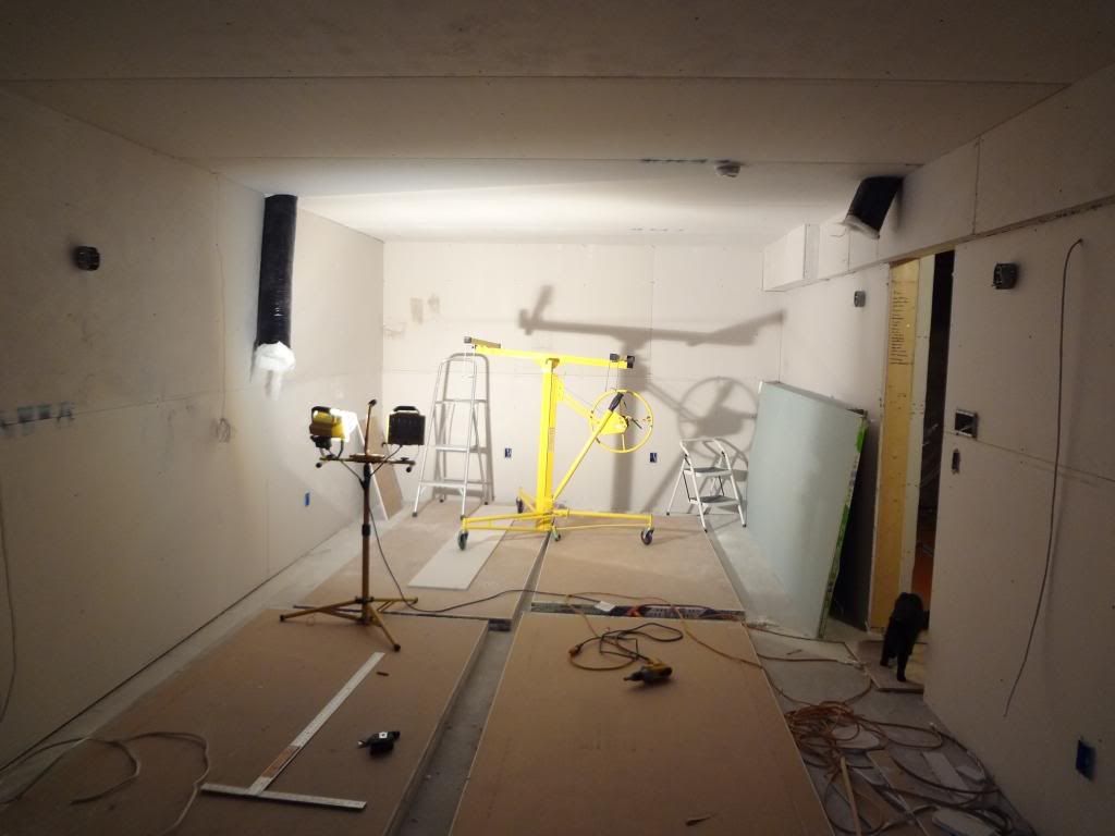

-Got second layer of drywall up (with green glue) on the theater room ceiling yesterday.

Then I spent the next 2 days finishing up the drywall: Green-board in the entire bathroom, and the second layer of drywall, with green-glue, in the theater room. I am pleased to report that we finished it all up, with several lessons learned:
NOTE: ANYONE ABOUT TO START THEIR BASEMENT, READ THESE LESSONS!! YOU WILL NOT REGRET IT!
-Green glue + leg hair = bad news
-When framing, make sure you leave your corner studs out an inch of so from the corner. This will help immensely when trying to secure your second layer of drywall at the corners...
-WD-40 is your BEST FRIEND when it comes to the Green Glue applicator gun. It took me a while to believe the instructions on this one. I was re-lubing every second sheet or so by the end and it made my life so much easier.
-When filling the GG applicator gun, totally submerge the tip to avoid air pockets. This means all the way past the orange tip, and past the screw-on tip attacher part.
Then on Monday, I was able to haul about 250 KG of scrap drywall to the dump, and start putting up the tile backer-board around the shower. Got it about 2/3 done i figure before it was supper/quitting time. Ceiling and 2 side walls are done. Back wall is half done. Floor and bench are not done yet.

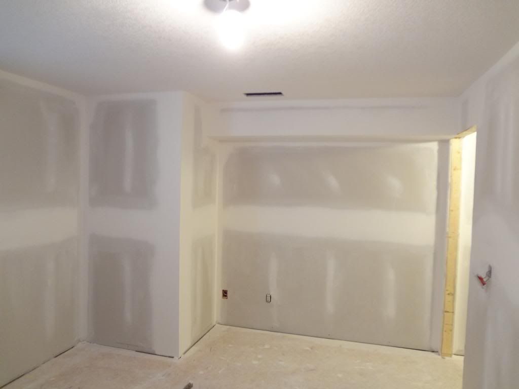

Drywall finishers have come and gone. We only got a rough-mud done in the theater room, since it will be covered by fabric panels anyways

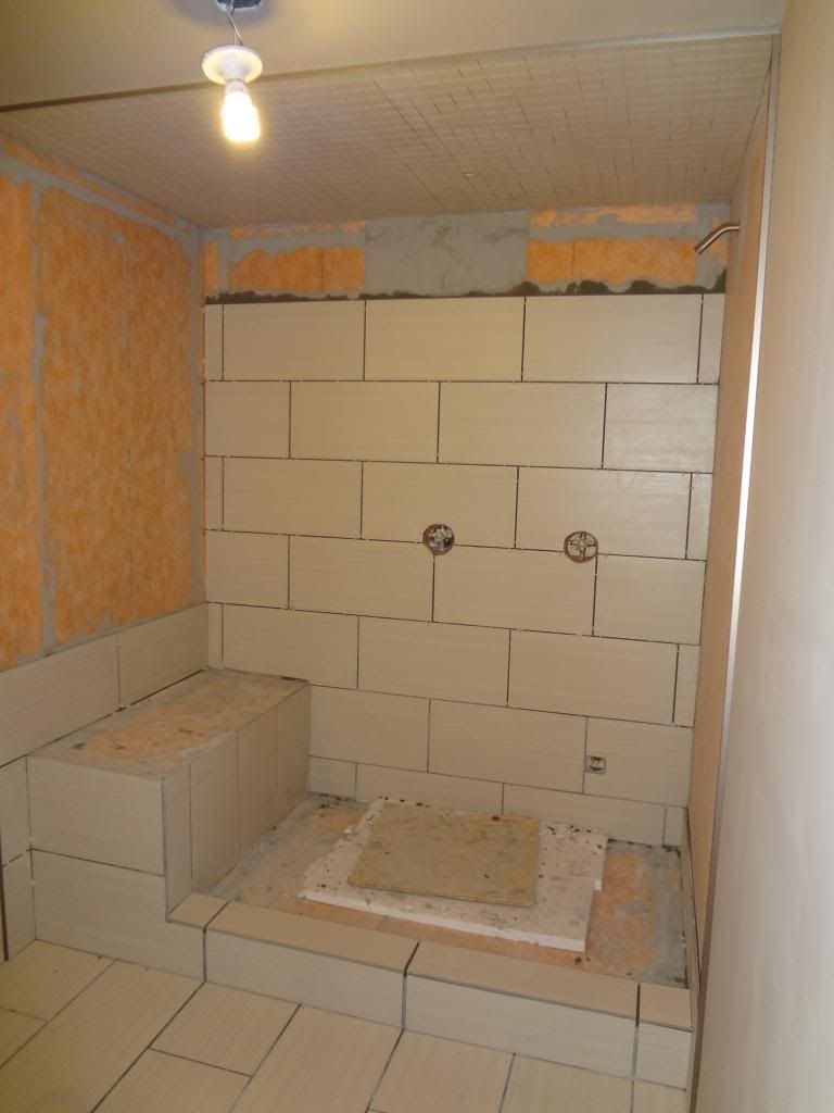

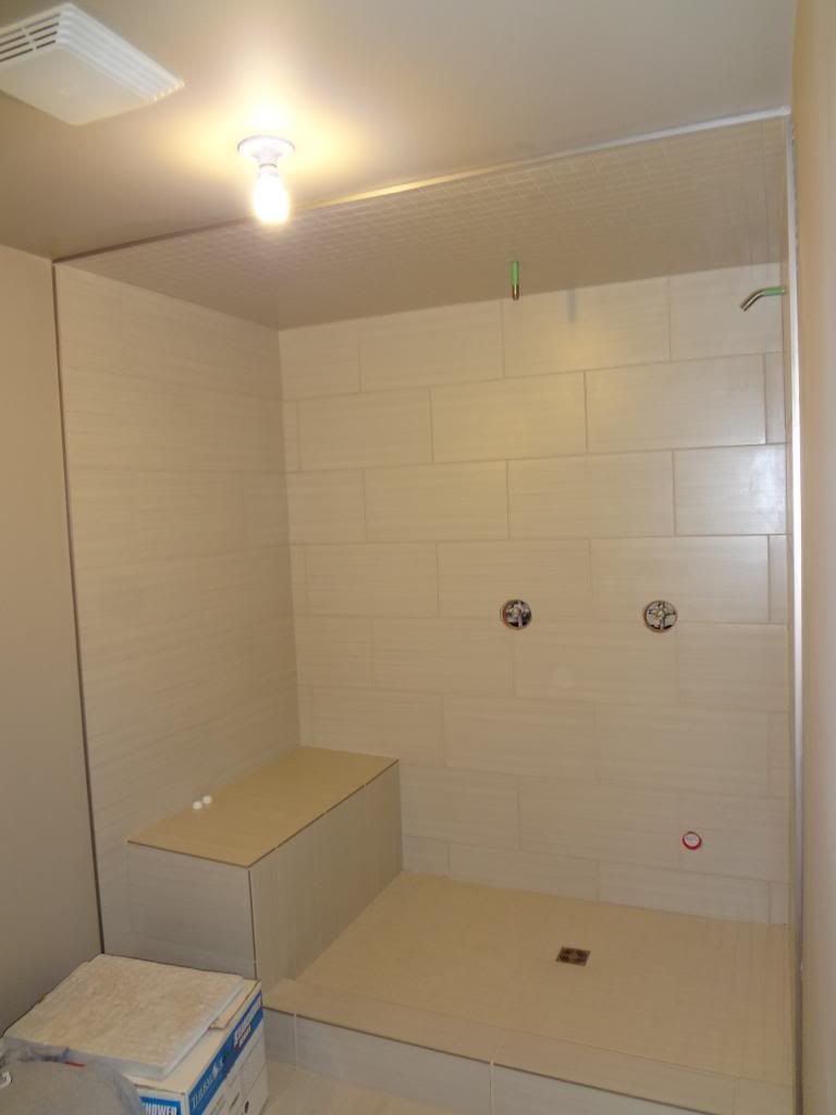

I finished boarding up the shower, put down the Schluter Kerdi tray shower base (sorry, forgot to take a pic of that, and too late now!), and put up Kerdi membrane on entire shower to waterproof it
We had bought the 72"x72" Kerdi shower back package, and cut it to fit our size. With the leftovers, there was enough to put on top of our shower bench as well, so I did that.

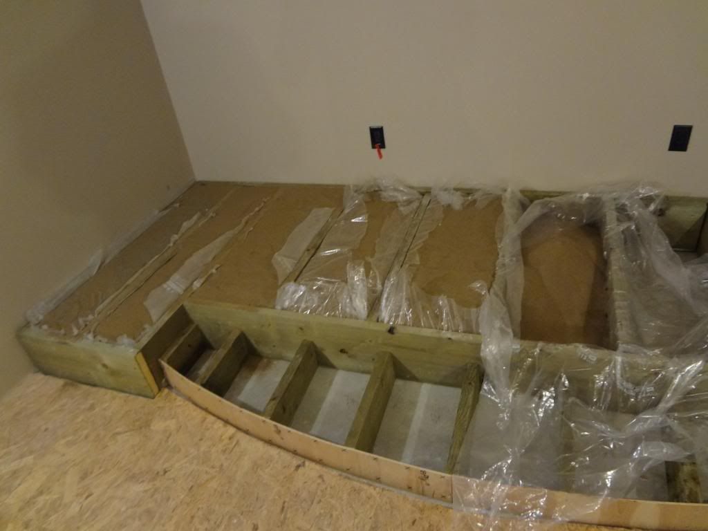

Built the high part of the stage with PT 2x10's. Still need to build the rounded part on the middle front. Yes, there is a 1/4" to 1/2" gap between the stage and the walls.

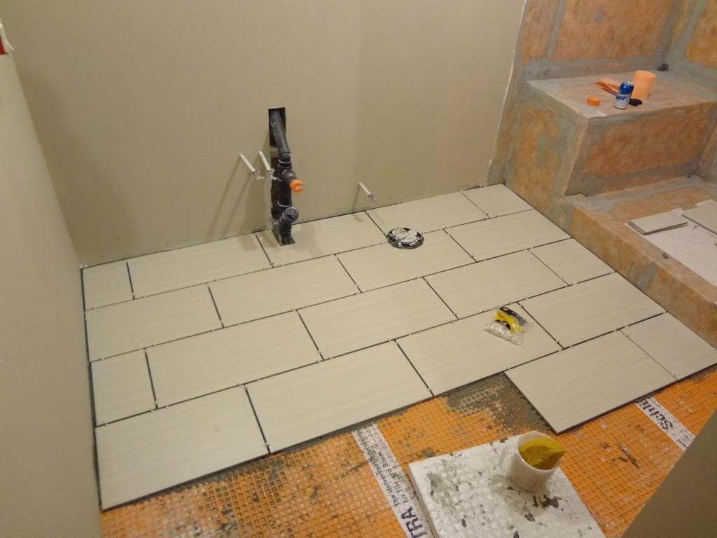

Started tiling the bathroom. Got about half of the floor done.

more tiling.... this goes very slow when you suck at it, and are doing it by yourself.

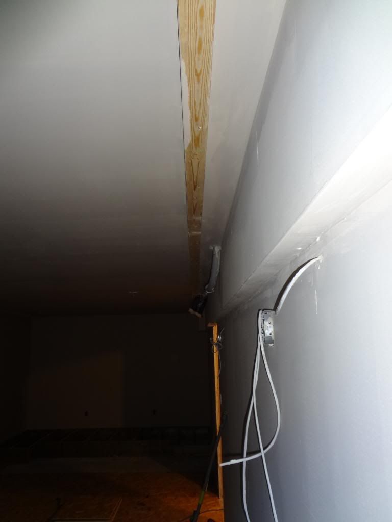

And here's a shot of the 2x3 I put up for the soffit.

Back from vacation, all rested and ready to get to work!! Just had to finish off the tiling and then put everything aside until the spring time when work slows down. a couple of hard days the other weekend, and I got the rest of the tiles up in the bathroom.
Now I can focus on work, right? nope. Got a letter in the mail from the city of Calgary, saying i need to get my final electrical inspection by the 4th of November, or pay a ridiculous permit renewal fee. So, I spent the last 2 days finishing up a bunch of electrical work.
Grafik Eye installed:
Wife painted the entire basement (aside from theater room) so we could get the plugs up without having to take them back out again later. Got all the plugs and switches in now. We didn't snug them down though, so they don't stick to the paint, Will do that right before inspection. No pic of this...
While I was doing other stuff, wife grouted the bathroom floor. Still need to do the entire shower though.

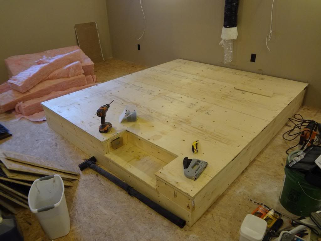

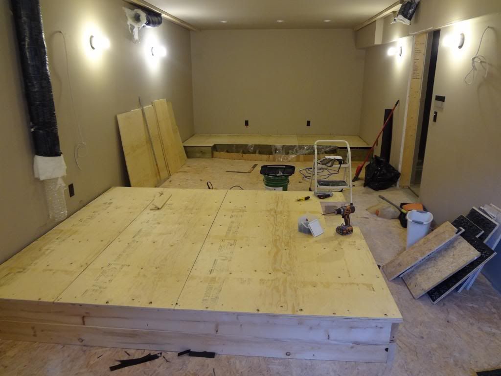

Then I took a break from the pot lights, and worked on my riser. I decided to make it 12" high. 14" would be ideal according to the riser height calculator, but I don't think i have enough clearance for that. Off to Home Depot to buy some 2x12x8's, and of course they don't carry them. Just 2x12x12, which are stupid expensive, So i sit and think, and in the end buy twice as many 2x6x8, thinking I'll just build upwards. Riser is 8' wide (well, 8'3" really), and 7' deep.
First layer:
And second layer on top of that:
Look at the step. I used a ton of screws to join the 2 layers together, and secure to the floor.
I need to order some recessed stair lights before I can finish it off. Apparently home depot doesn't carry those either....
Then back to the pot lights. Just have to put them in their holes and I'm done.

Also built the lower part of the stage. Actually turned out to be easier than I expected. Here's my procedure for it:
-mocked it up in SketchUp, and pulled off the dimensions for each of the pieces of 2x6.
-Transferred these dimensions to paper, cut the pieces of wood
-Scribed the dimensions on the floor, estimated how much dricore I should cut out
-Laid down my cuts to make sure everything looked OK
-Cut 5 1/4" strips of 1/4" underlay sheeting. rough placed the peices in place, and started screwing them in place.
-As I expected, as I started to tighten down the screws, the plywood flexed into a position I didn't like, as I didn't spend any time trying to cut the 2x6's at the correct angle. I just cut them at 90's. So, I took the brad nailer, and put in as many brad nails as physically possible after the ply was tacked with the screw.
-The brad nails held things in place enough that I was then able to tighten down the screw.
-And add another screw to solidify things
Final product.
Next weekend - buy 60 bags of play sand (30 ft^3 is what I calculated as needing). Buy some plywood. Do some heavy hauling, fill some cavities with sand, and cover with sheeting. Main part of stage will be sand. Front part and riser will be filled with pink. All will be covered with 2 layers of plywood, with roofing felt between. Sounds easy enough, right?

-Got the grouting all finished up late Friday night. Going to get a glass door guy in on our next day off to measure things up, and then we will get that ordered. Need to put on the fixtures etc as well still. Actually, need to buy some shower heads...
Went to HD on Friday and bought 30 bags of play sand (approximately half of what I need). Hauled it all downstairs, started filling the spaces
Ran out of poly, so went back to HD on Saturday and bought some more as well as picked up all the plywood I need.
NOTE: filling the cavities is a lot easier with Medium weight poly, rather than the heavy duty vapor barrier stuff.
Filled riser with pink
Put on 1 layer of plywood, 2 layers of tar paper, 1 more layer of plywood. repeat.
You can see that I've also now got the stair lights installed. Plywood runs 1/2" past the end of the riser everywhere.
I've still only got half the sand in the stage, but I've cut all the pieces of plywood and laid them on top (cats....)
Then it snowed on Sunday, so I wasn't able to get the rest of my sand. Maybe next weekend.

Small update:
Finished filling stage with sand:
Laid plywood overtop (2 layers with tar paper between), filled front part with pink:
Put down over-cut pieces of ply:
Made up an over-hang jig a la Big:
Traced out a line 1/2" past the base of the curved section:
Cut with jig saw, and voila, stage finito:
