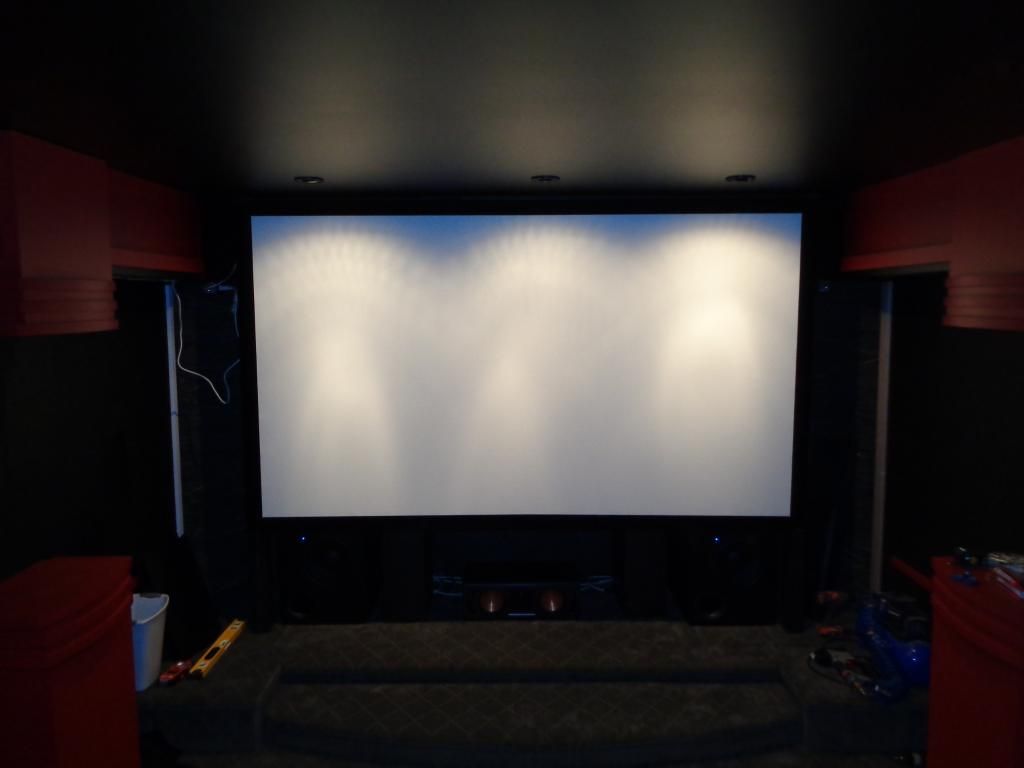

Quick update. Theater ceiling painted black again (along with some of the remaining exposed wood that needed painted black, such as the screen frame), flooring in the rest of the basement done, baseboards done.
I am going to buy the wood for the light trey this morning, then more or less taking the rest of the weekend off. I will get that painted and put up some time next week, and hopefully the rope lights show up so I can get that installed as well and tested out.
GOM showed up yesterday. Added it to the pile of stuff in my living room.
I guess I need to start thinking about constructing my fabric frames now, and getting all the low voltage stuff terminated and electronics installed.
And I guess I should order my screen soon.

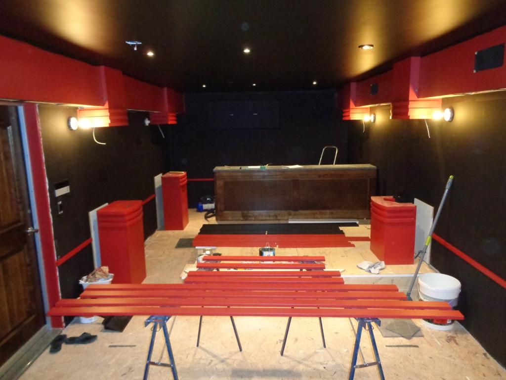

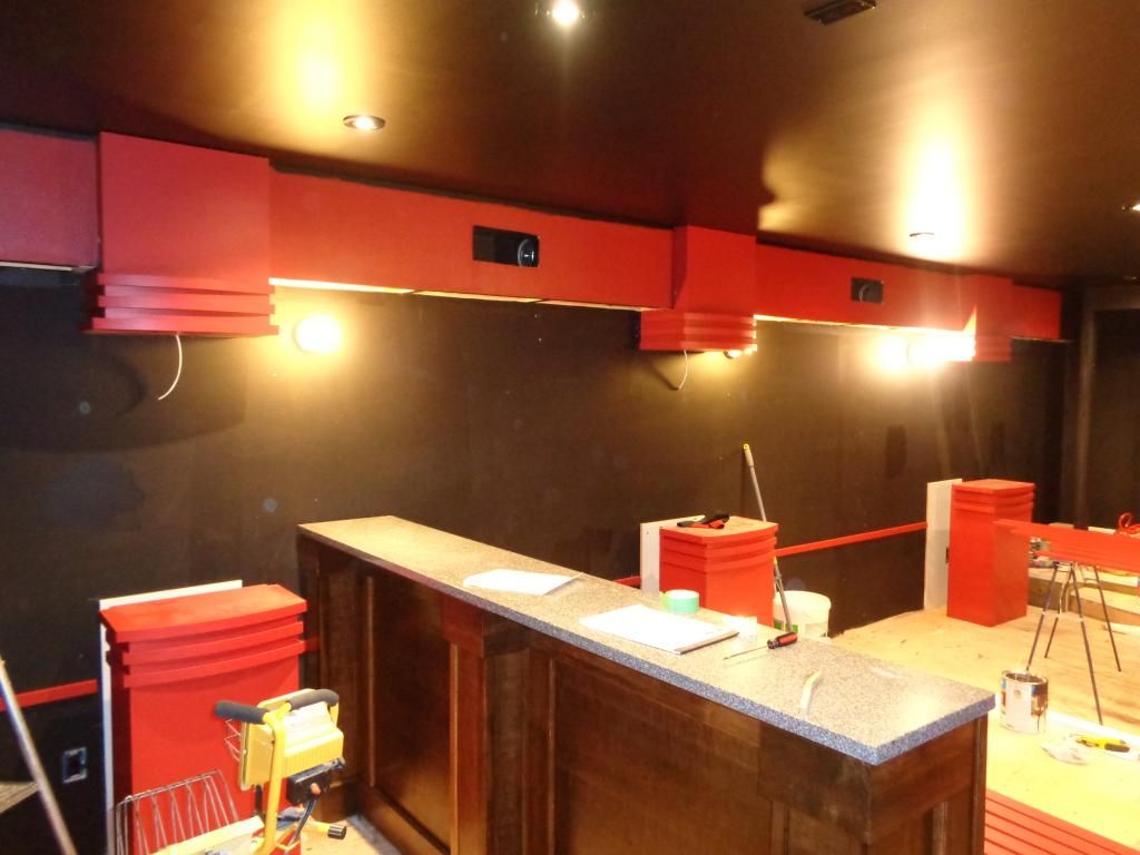

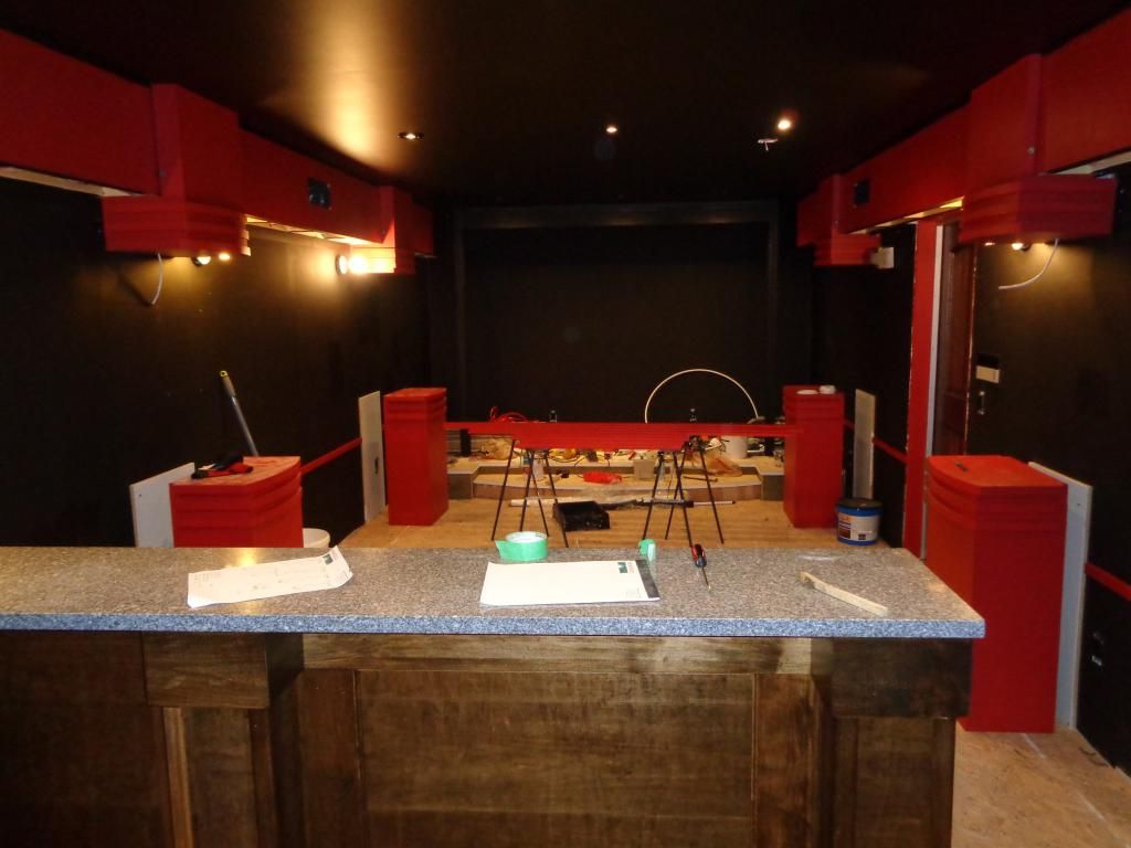

I learned something yesterday; red rope light does not project onto a black soffit.
In other news, I re-painted my soffits red last night!! Also have all of the trim and light trey pieces painted up, will install today (if I can duck out of work early enough) or this weekend.
I think i like them better red anyways...

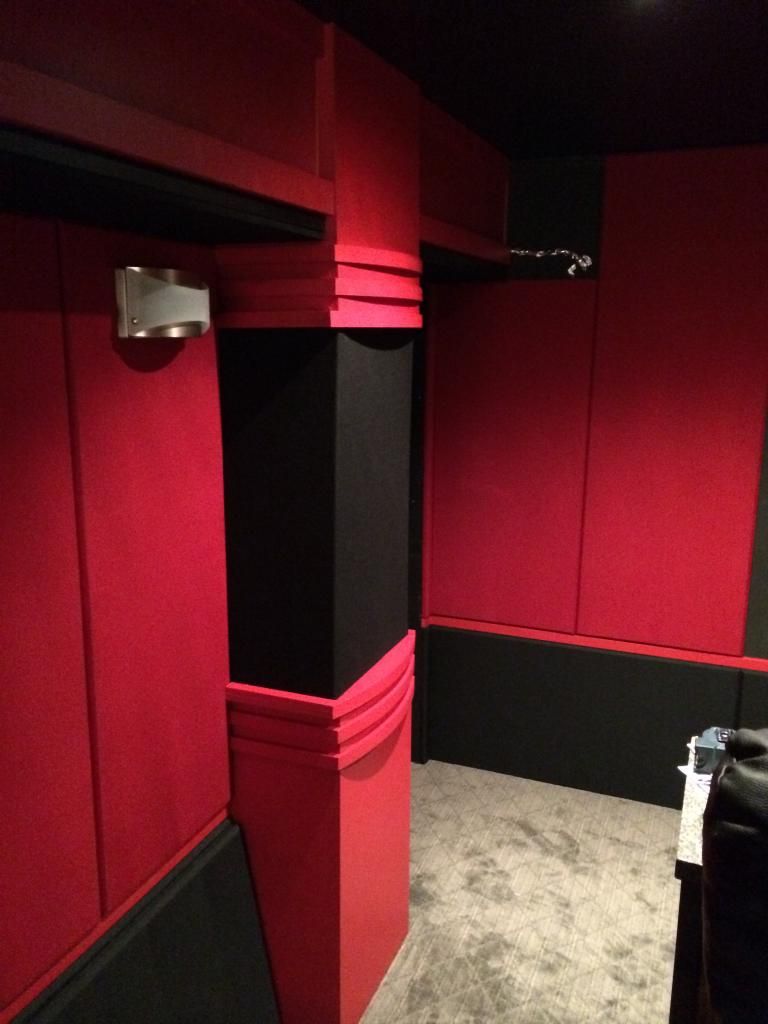

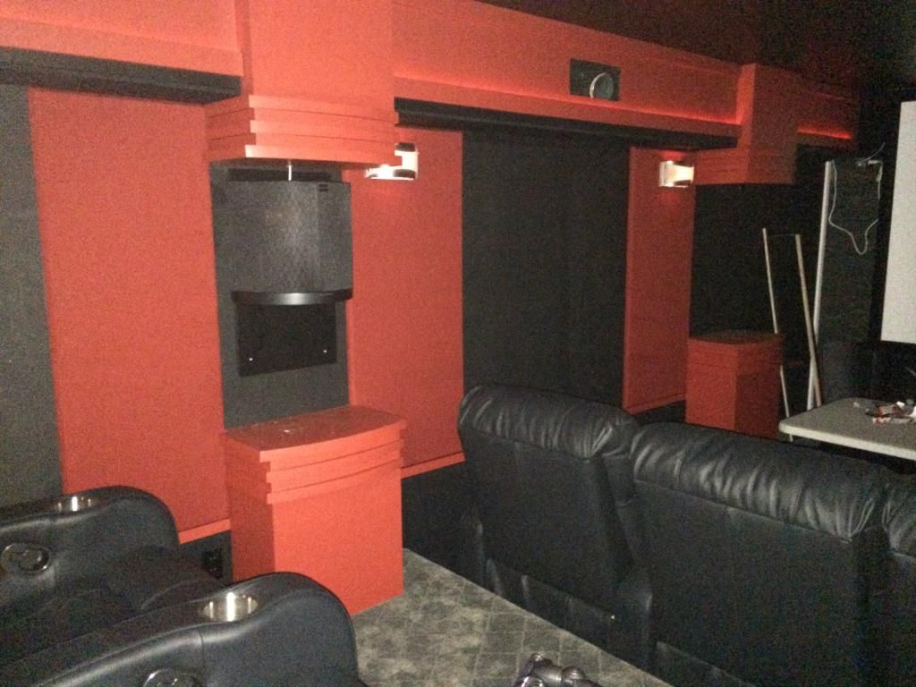

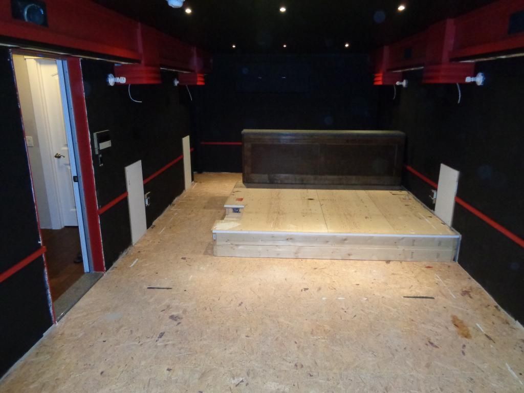

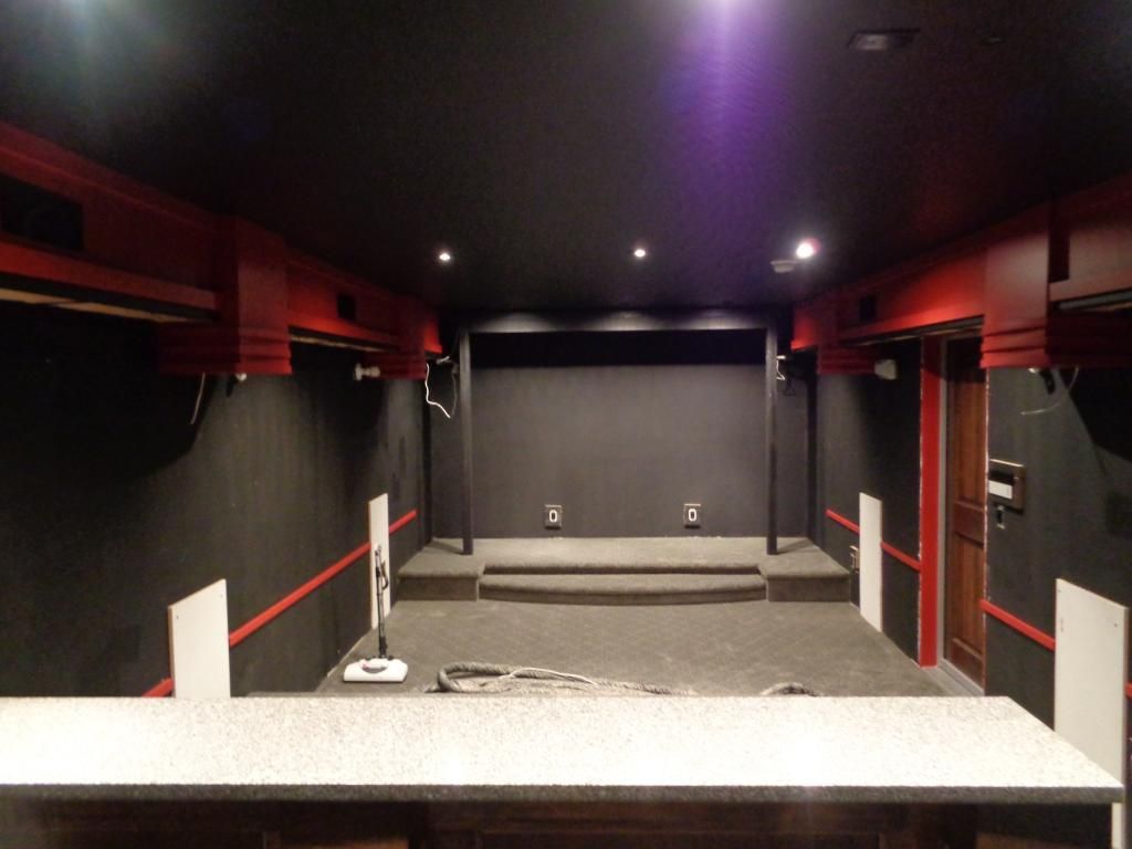

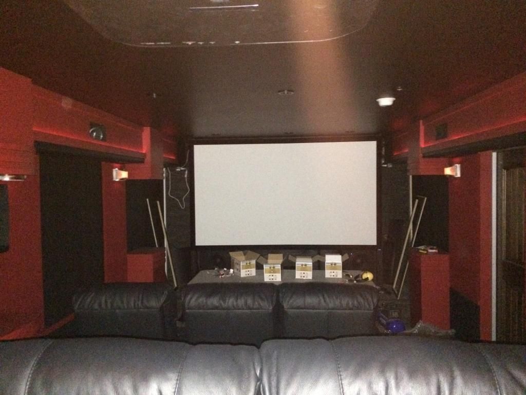

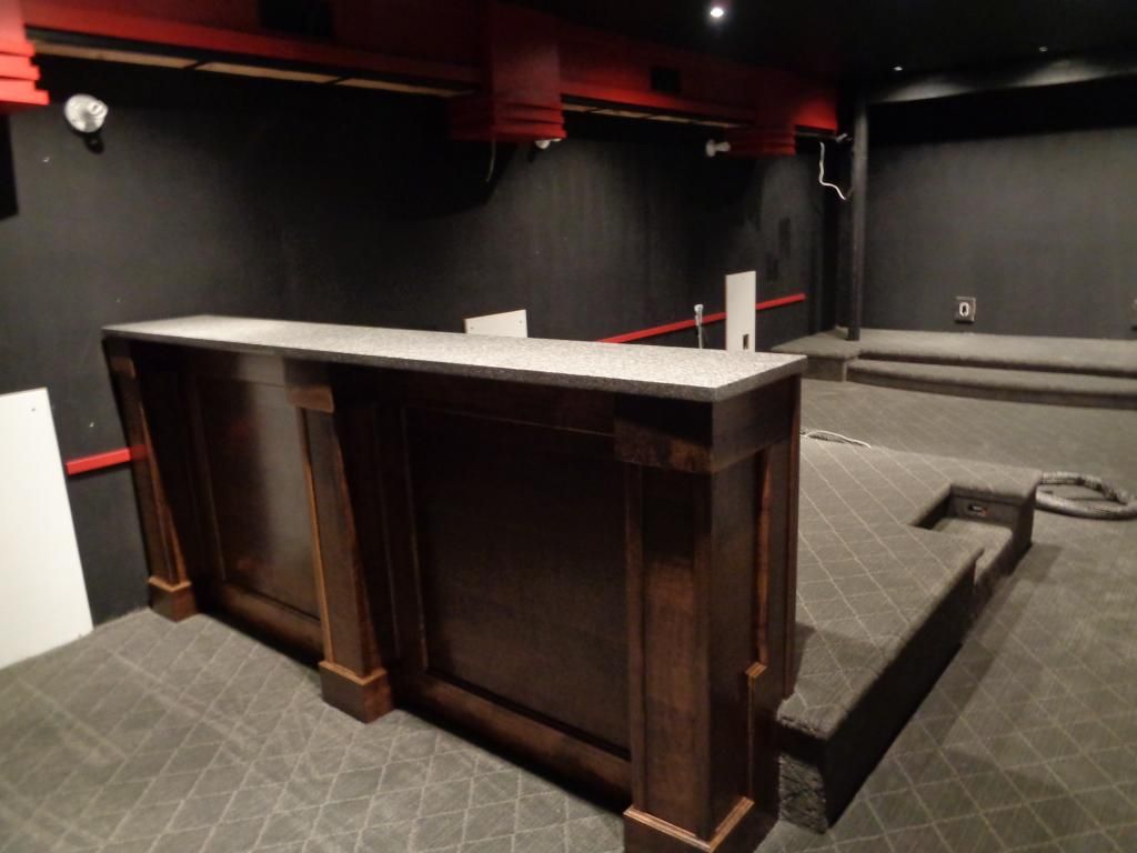

OK, time for another giant update. Been working on the basement on and off, had a trip to Vegas somewhere in the middle, and here's where we are at:
Theater all cleaned up and ready for carpet:
Carpet got installed when I was down in Vegas. Came back to this:

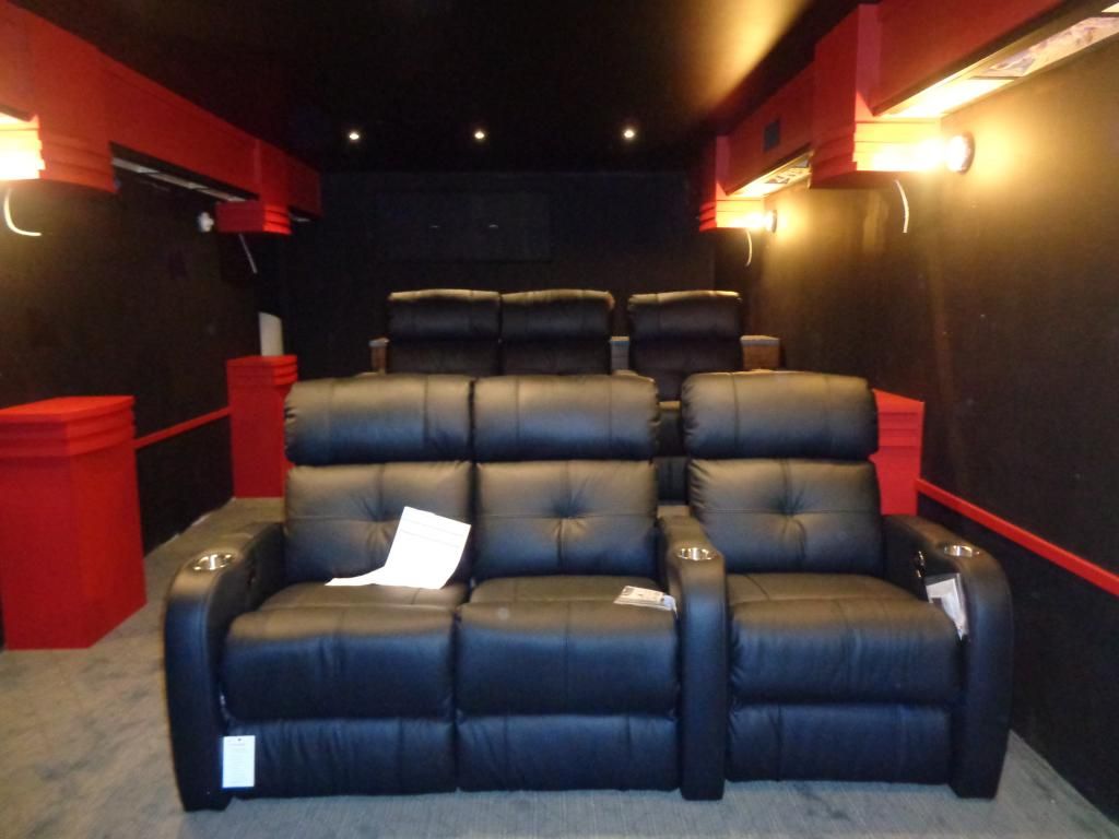

The other rope light came in while I was gone too, so my wife got that strung up for me. As pretty much everyone has said, it is incredibly difficult to accurately capture what the rope lighting really look like.

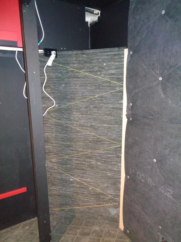

Picked up a couple of rolls of acoustic insulation (1" duct liner). First cut a ton of 2' corner pieces to build up my bass traps, then 2 layers of the insulation across the rest of the front wall.
At the same time that I was doing all of that, couches were delivered and set up .
It's starting to feel like a theater room!!!

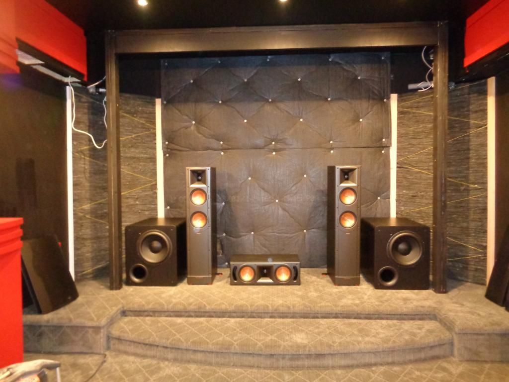

So I figured why not move some of the speakers from the living room downstairs.
I was planning on spending the entire weekend starting to build my fabric frames, but it seems that my wife now has some different plans for me... So I may get to pick away at it a bit, but we'll see.
Projector showed up last weekend, so that's also sitting in my front room. Ordered the screen from Seymour last week; just got notification that its built, and should ship out on Monday. I should have it by the end of this coming week. That is the last major piece of equipment that I am missing, so I'll have to fight the urge to set everything up once that comes in. It's gonna be tough.
Also ordered and received a small order from Monoprice, including a PJ mount, some banana plugs, etc.

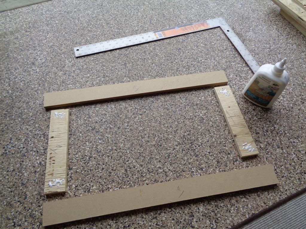

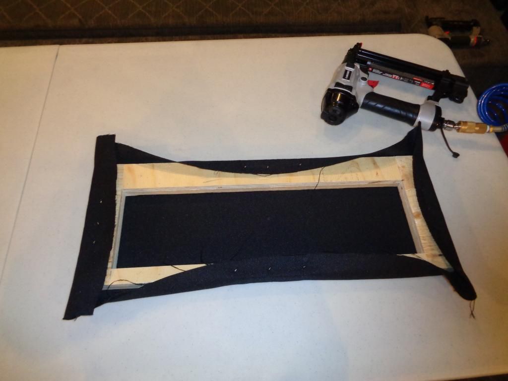

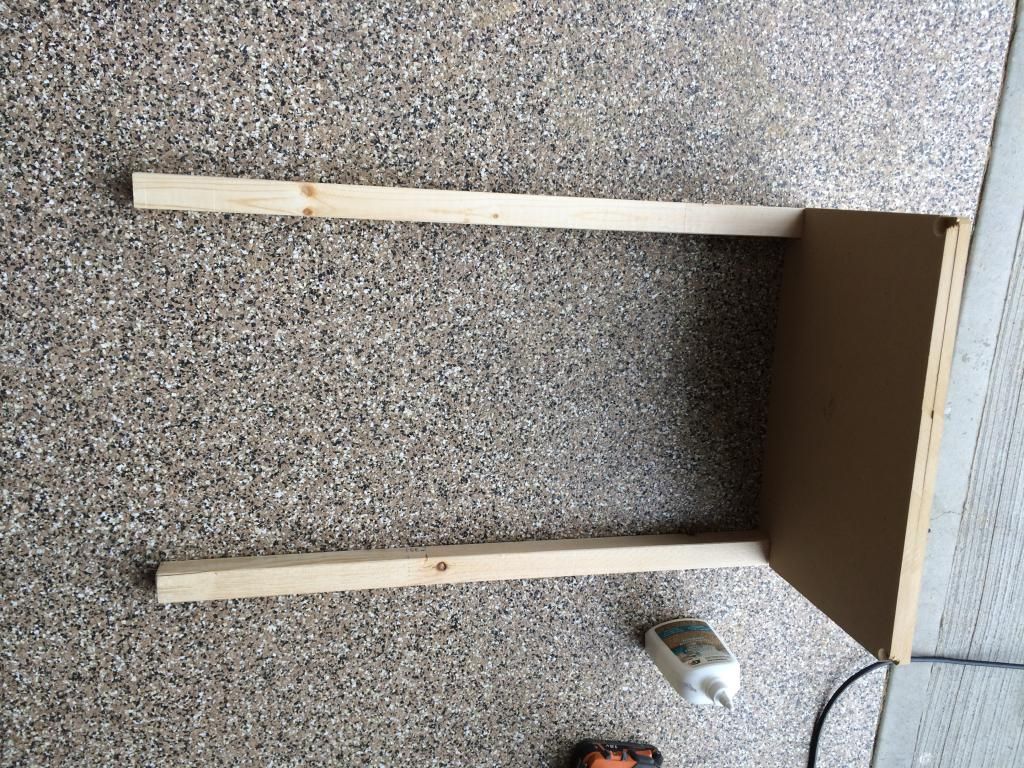

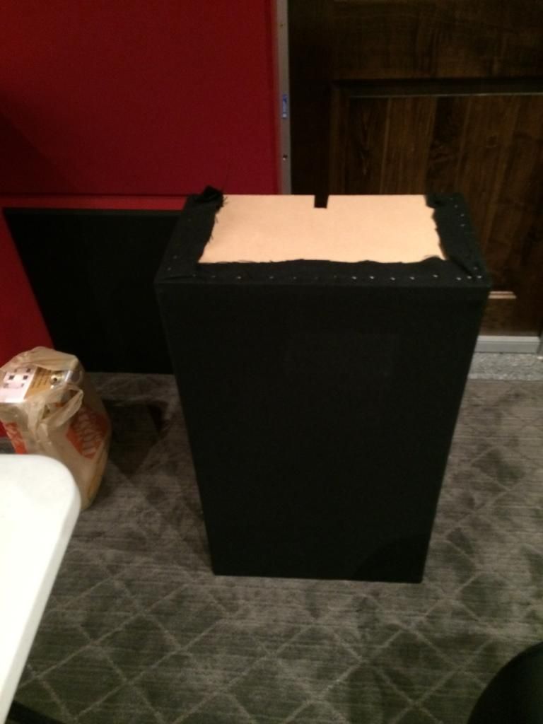

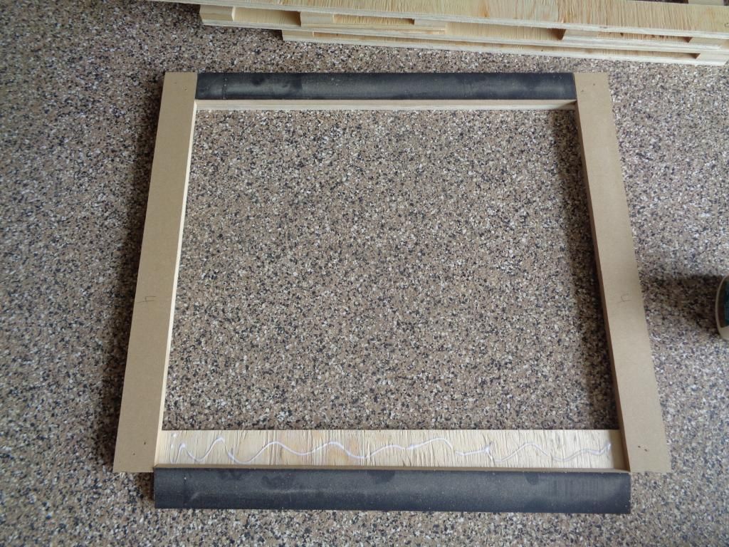

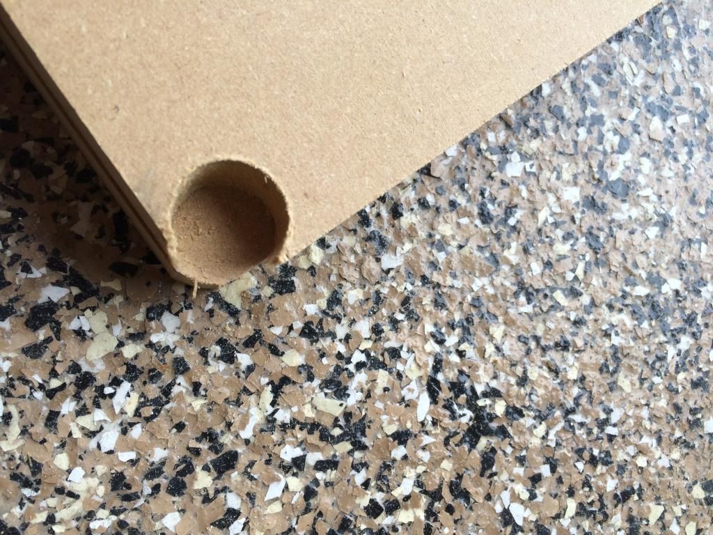

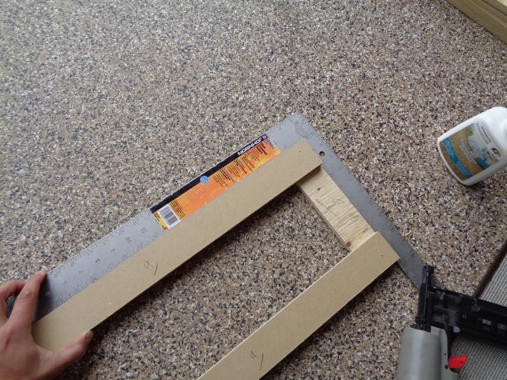

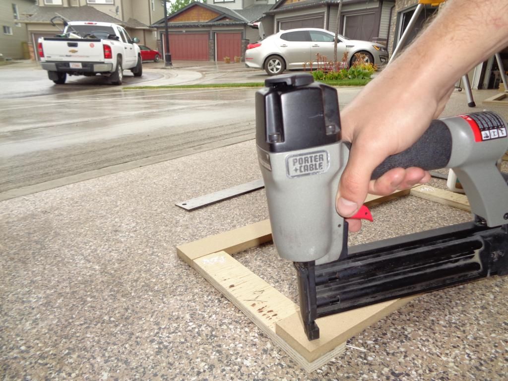

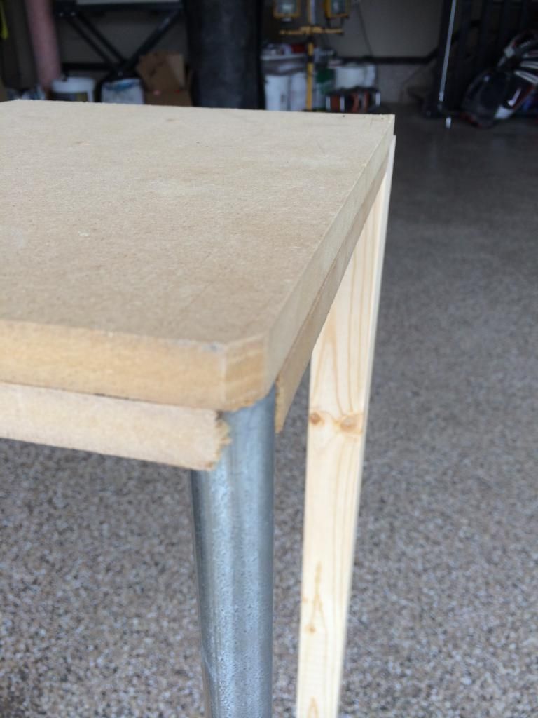

First couple panels built and installed. Here's a walk-thru:
Step 1: rip all of my scrap 1/2" plywood and mdf into 2" strips
Step 2: cut 2 pieces of plywood to panel height, cut 2 pieces of MDF to panel width
Step 3: Put some wood glue on the corners. Place PDF on top of Plywood, put 1 nail on each corner.
Step 4: Using a corner square, square up the frame, and put a couple more nails in.
Step 5: Cut MDF to fit inside gaps on the top. Glue, nail.
Step 6: Repeat for Plywood on bottom.
No picture. Just imagine it.
Step 7: Router a 45 corner on the MDF all the way around the frame.
Forgot to take a picture, but you can see the result in other pics.
Step 8: Paint the face black
Step 9: cut insulation (you can see routered edge here)
Step 10: Wrap in fabric
Step 11: Attach to wall with brad nails
Step 12: Repeat x 50
Yup, this is going to take a while.

Originally Posted by Waterboy77 View Post
Great job, its really coming together.
What insulation did you use?
Are they all for acoustics?
I'm using 1" Owens Corning QuietR Rotary Duct Liner. It's got the same overall NRC as OC 701, but a slightly different curve. Better on the high end, not as good on the low end:
http://commercial.owenscorning.com/a...e14d7284d7.pdf
125hz 250hz 500hz 1000hz 2000hz 4000hz NRC
QuietR 0.05 0.30 0.60 0.87 0.98 1.05 0.70
OC 701 0.17 0.33 0.64 0.83 0.90 0.92 0.70
Why QuietR Duct Liner? Simply because that's what I could get my hands on. Getting stuff shipped here (as I've said many many many times) is cost prohibitive. I've got a cousin who is in the HVAC business, so I was able to order this through him. I couldn't get many other products because they aren't stocked at the distributor warehouses, and they wont bring in that small of a quantity for special order.
Front wall has 2" of the duct liner. Front corners have bass traps. Bottom 2' of all other walls will be treated, and main first reflection points will be treated to ceiling. Other panels will remain untreated.

Worked on the theater pretty much the entire weekend. Got a lot done!
As shown above, I got the projector hung. Also got the screen in on Friday, got it assembled while I was waiting for some paint on my frames to dry, and got it hung. I must say, the Seymour system is super easy to put together, and works really well!
Also finished off all of the lower panels (black) all the way around the room. Time consuming stuff.

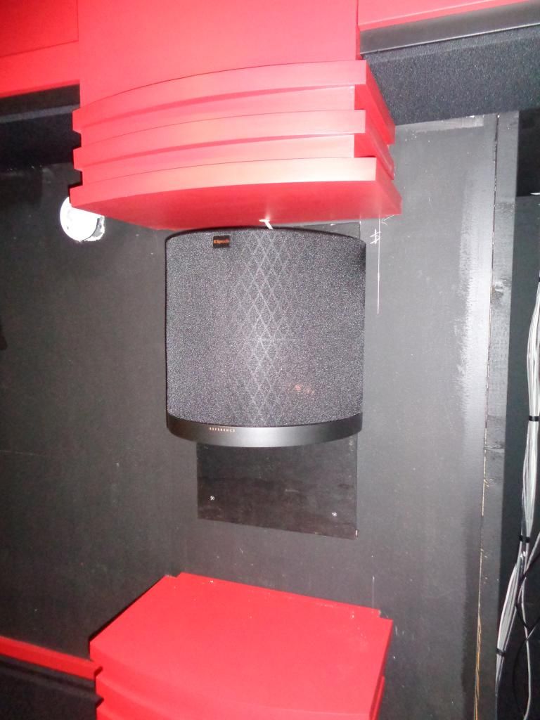

Got my surrounds hung and hooked up as well.
I didn't take any pictures, but you can kind of see it in the above picture; I got all of the panels along the bottom of the soffit done as well. For those, I took 1/2" plywood cut to size, and used a jig saw to cut holes in it. Same as many other people have done. Then wrapped in fabric, and installed. Looks pretty swell. I'll have to get a picture of it next time I am snapping photos.
Also built and wrapped my first red panel, just because I wanted to see how it would look.
Probably not alot going to get done in the next little bit. I have to work this week, then off for vacation for a week. Once I get back, it's right into the Calgary Stampede, so I'm guessing not alot will get done then....
ps. I watched a couple episodes of The Pacific yesterday.. WOW. I'm happy with how things are turning out. More importantly, so is my wife!

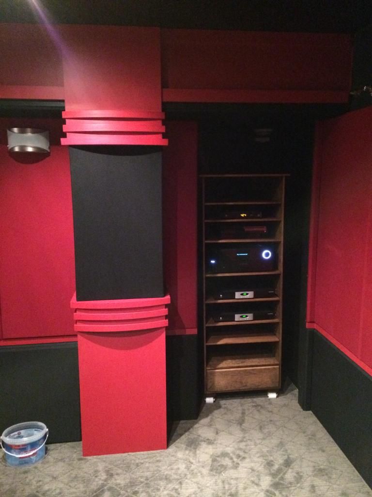

Back from vacation, and I spent all day Sunday working in the basement. I even managed to keep the projector off all day!
Basically worked on getting another set of panels built. Here's some iPhone pics:
Colors are a bit off, not surprisingly. I think I got 6 panels up, with another 4 built but not wrapped. I ran out of staples (5000 used so far) so I need to make a trip to HD.
Also got 5 of the 6 sconces put up, and tested them out. They appear to work just fine.
Looks like it's going to take another couple weekends to get all of the panels built and installed, then I can start thinking about building the surround speaker covers for the columns.

I've been pretty tardy in posting my updates. It seems summer has taken over progress.
But I'll update what HAS been done. Here goes:
Make some more red panels, but then ran out of fabric. Had to order some more, and it just arrived.

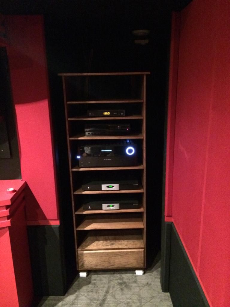

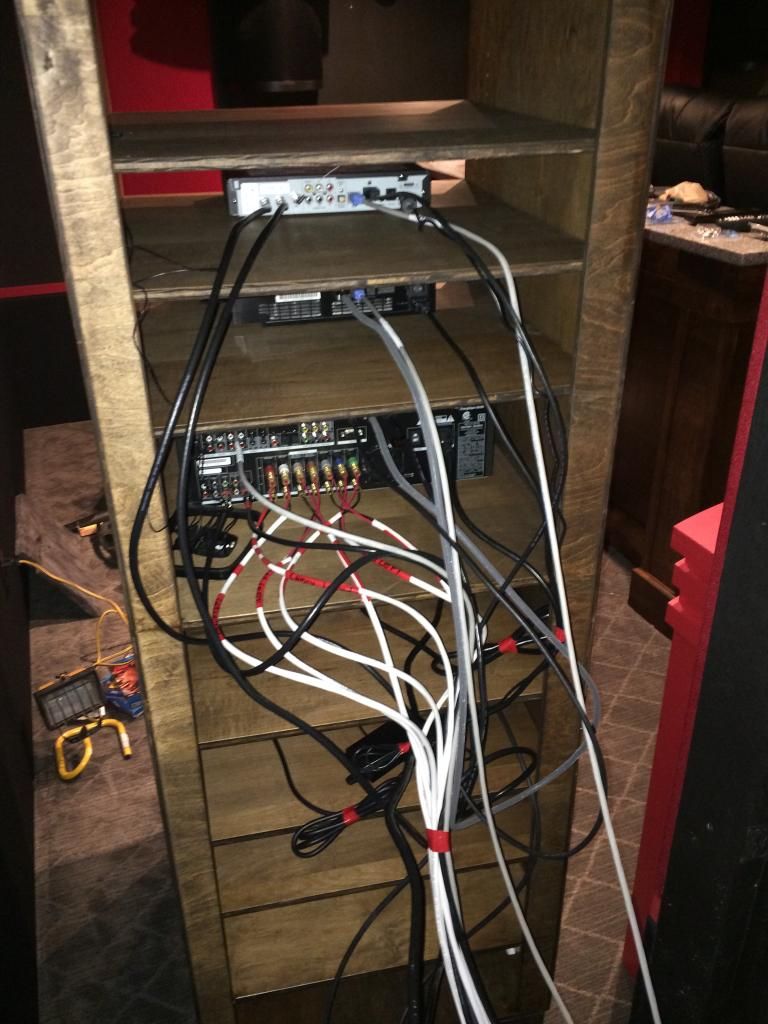

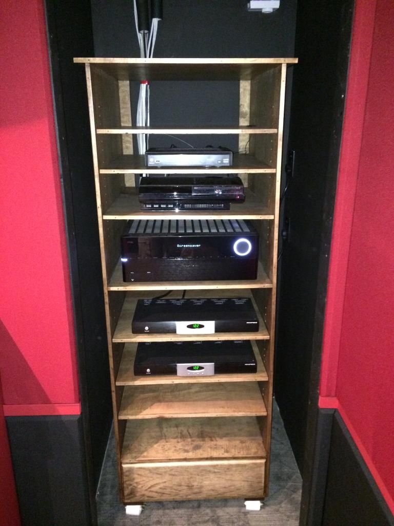

My dad finished making the AV Rack, and brought it down to Calgary. I stained it, and brought it downstairs. It's basically just a simple rack, middle shelf is fixed. The other 6 are adjustable.
In it's home:
Also got all of my Cat5 and COAX terminated at the wall and in the panel. Just waiting for an Ethernet hub to arrive before I can totally finish off the panel area.
sgolko is offline

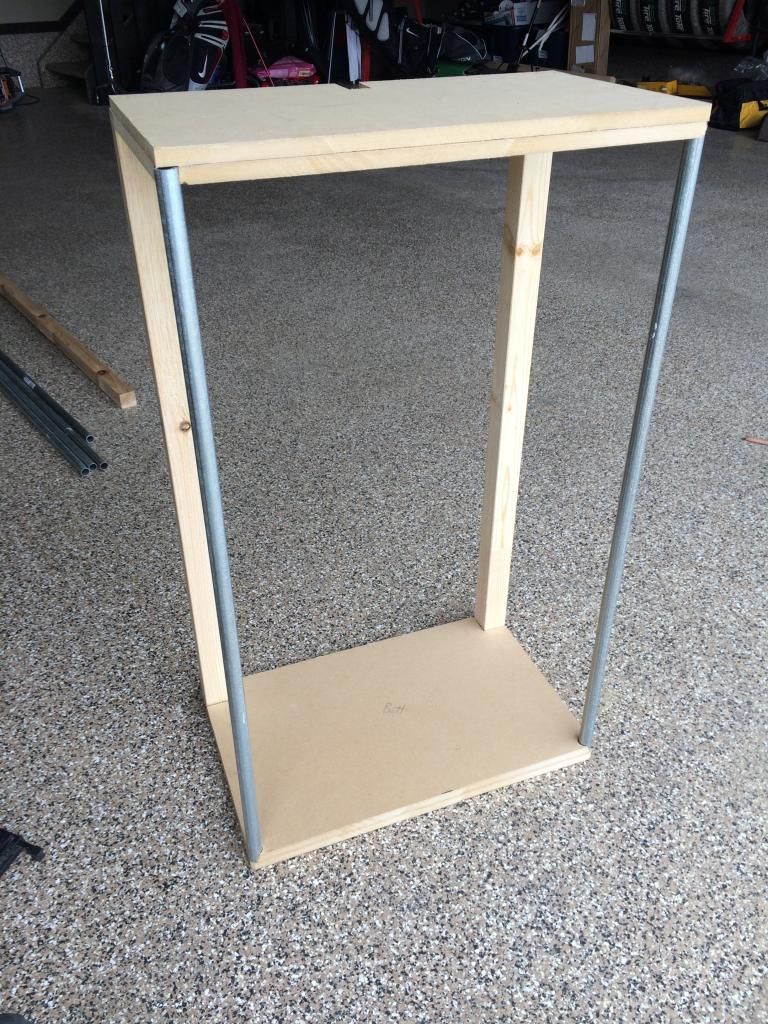

This weekend, I started and finished the speaker grill covers. Procedure as below:
-Cut 2 pieces of 1/2" MDF for the top and 2 for the bottom. On one top piece and 1 bottom piece I then notched out 2 corners with a 1 1/2" square (to fit a 2x2), and in the other 2 corners, I drilled out a 3/4" hole. It is fairly important to make sure that the hole is a bit further in than 3/8" (half of 3/4"), so that the edges start to come back in. Then glue/staple the 2 tops and 2 bottoms together. Round off the bottom peice so that it follows the contour of the 3/4" drill bit. They look something like this:
-Cut 2 pieces of 2x2 to 1" less than the total height between the top column and bottom column. Glue and staple to bottom MDF,
-Cut 2 pieces of 3/4" pipe (electrical conduit) to the same length as 2x2. Actually, make sure you measure the distance at the outer edge of the column. This measurement was usually different than at the wall. Fit pipe into the drilled corners, and attach the top MDF.
It's not the end of the world if the pipe kind of falls out of the corner holes.. The fabric will hold it all together.
-Wrap in black FR 701:
-Friction fit in between upper and lower columns:

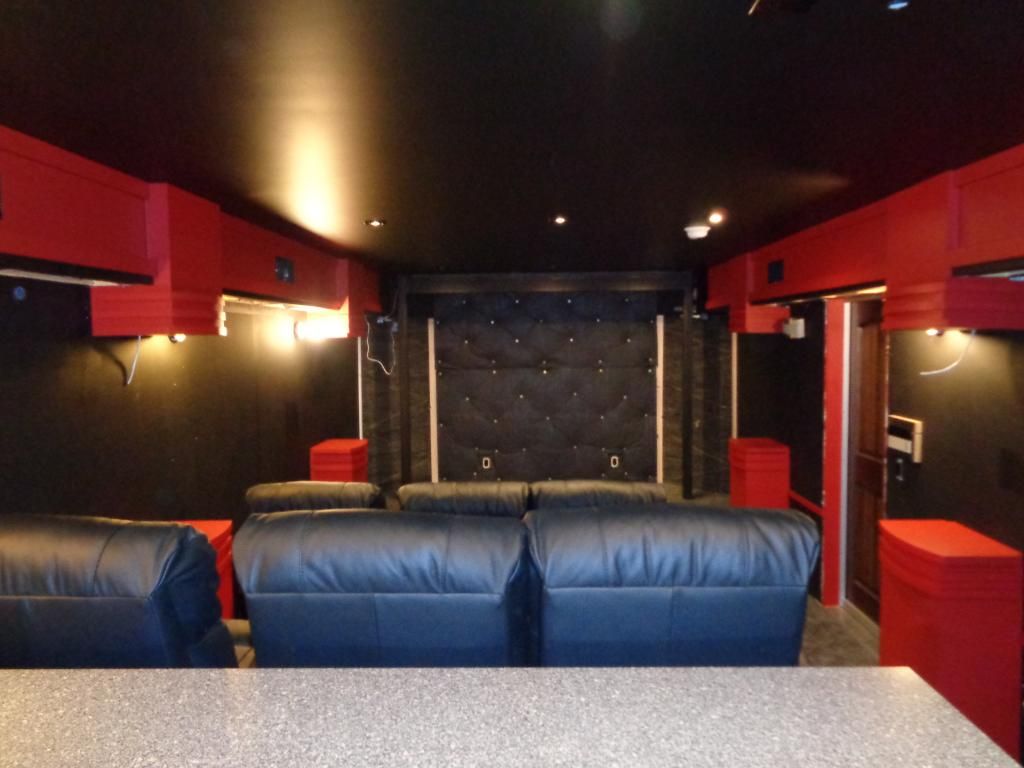

So that brings us to where I currently sit:
Pretty much done, right? Wrong.
Left to do:
-Finish the red panels (I think there are 5 left)
-Make some kind of a door for the AV Rack. Attach panels to it.
-Make black panels to surround the screen.
sgolko is offline
