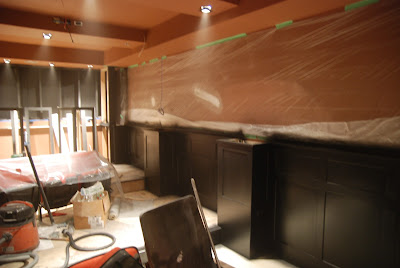

Like Big suggested--it doesn't take much room to squeeze the 3" cans in.
Here's what I have done:
Wahoo_envy is offline

The location is less than ideal; however, it was the only place I could fit them and maintain symmetry. I think when the columns and light tray are in it'll look good--and for $10 a piece they are the gimbal type. For me, I decided the wall wash effect was better than sconces or recessed lights installed through the bunker--only five of the fifteen lights planned require backer boxes.
