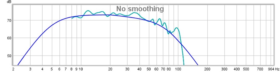

Originally Posted by Jacob B View Post
Fulminis, what did you end up doing? And how did it turn out, acoustically?
Jacob,
I ended up building the riser similar to picture I posted above. I had a contractor doing the work and he built it a cheaper way instead of the way I designed it. It is similar, but has no ports on the front. He also did me a 'favor' and bought denser insulation than i requested. It was one of many issues with the contractor.
Doubled up the plywood, used a lot of Green Glue and I'm happy with the solid feel. No vibrations, noises, etc. If I could do it again I would use a tighter grate. The carpet has a weird effect on the grate and I think it will wear oddly over time.
Here are some pics.
Here is another thread will some more pictures.
It took me a long time to get my IB system right and haven't tested with/without the riser port covered. I used a MiniDSP EQ and mic. I had some technical issues with software and then a laptop soundcard with issues below 30Hz. I also had some technical problems with my wife who took exception to the amount of time I put into this project. So I just got the IB calibrated a couple weeks ago. Here is the final graphs at the main listening position for both subs:
I am pretty happy with the results, especially in a room that is close to being square. I'll have to test with and without the trap at some point, but I have several other punch items I want to get to first.
