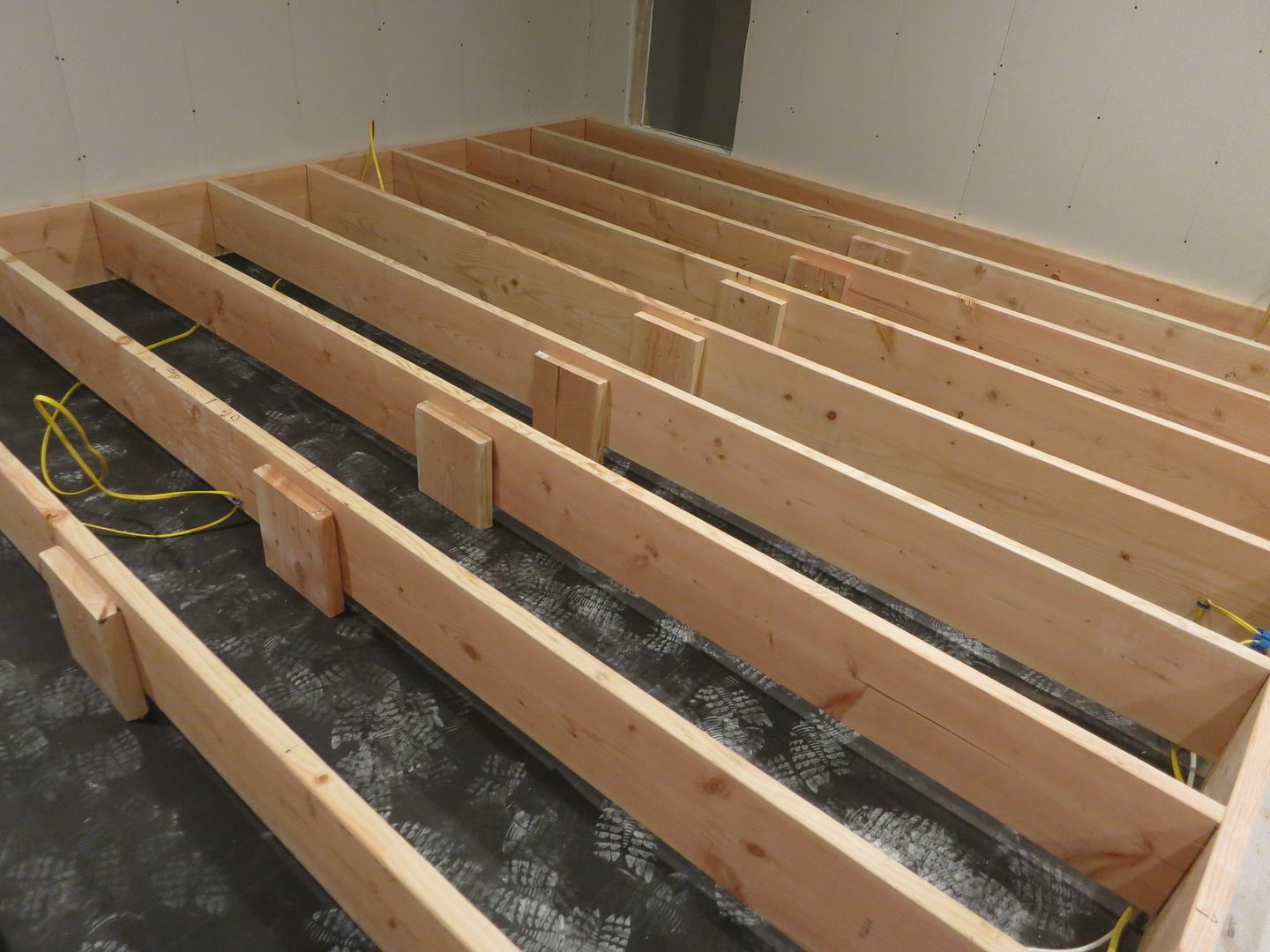

For a total boost of 12-3/4", I used a perimeter of 2x12s with 2x8 joists at 16" o.c., filled the entire thing with regular fluffy insulation and topped it with 2 layers of 3/4" osb. Because the joists are smaller than the perimeter framing, they are elevated off the floor, creating a single insulation-filled cavity. When used in conjunction with small hvac supply grills placed along the sides and rear of the riser, you're creating a rather large bass trap. Tuning your riser to address certain frequencies in your room is an entirely different exercise best left to a professional.
My riser construction is documented here.

^^^ +1. That is the same thing I did with mine. You'll get some conversation as to whether or not the insulation should go all the way to the floor or be suspended between the joists. My design called for it to be suspended. It has been done both ways by people on this forum, and seems to work fine either way. As Spaceman said, as long as you aren't tuning it, you should be fine.

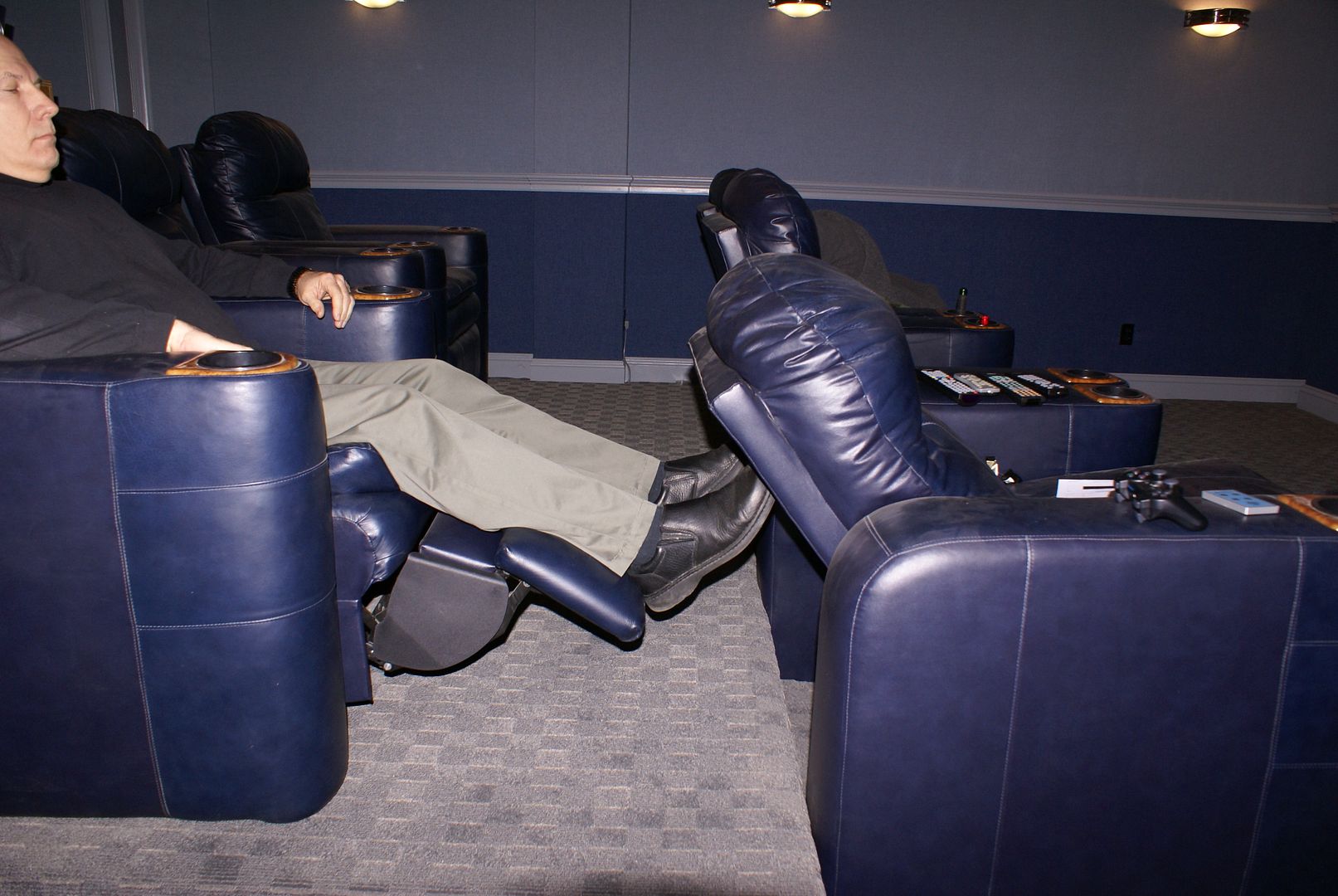

If you want reclining HT seating a 6 ft deep riser is 6-8 inches too short.
I am not sure why. I have Palliser Blades and the full reclining distance is 68" so I calculated the 4" off the wall. If somebody on the inside want's out, they can play like and airplane or real theater and squeeze back in. I want to keep the front row at 14 feet.
this is why
not sure why you want the front row at 14 anything over 12 is usually a waste, what size screen do you have?

this is why
I see, good visual.

put the back of the first row at 12-12.5 ft from the screen surface. build a deeper riser and pull the back row off the back wall.

Lesson's learned from a construction perspective - cut your top boards FIRST. I secured my top board to the joists first and then tried to trim to size. When I got to the edges near the walls, I couldn't cut all the way because my saw ran into the wall, leaving me with small "tabs." I ended up cutting those off with an oscillating tool, but it caused me a delay since I didn't have that tool in my collection.

From an acoustics point of view, the main thing is to build it solidly enough that it doesn't resonate audibly. Filling it with insulation (or sand) will help also.
I have seen people try to integrate bass traps into a riser, but in general that's not effective unless the air in the room can get to the absorbent material under the riser, which would entail using some sort of metal grate as the floor of the riser. More trouble than it's worth, imho, because even if it is successful having a bass trap on the floor is probably not the most effective place for them in the first place.

What is the black liner under the riser?

The black is roofing felt.
Don't expect to be able to move the riser - even if you build it on wheels. You'll want to leave the riser open in the area of the gas valve or whatever else. Cover the open area with an access panel - maybe just a piece of plywood covered in carpet. Leave holes or notches like a man-hole cover or sewer grate.
