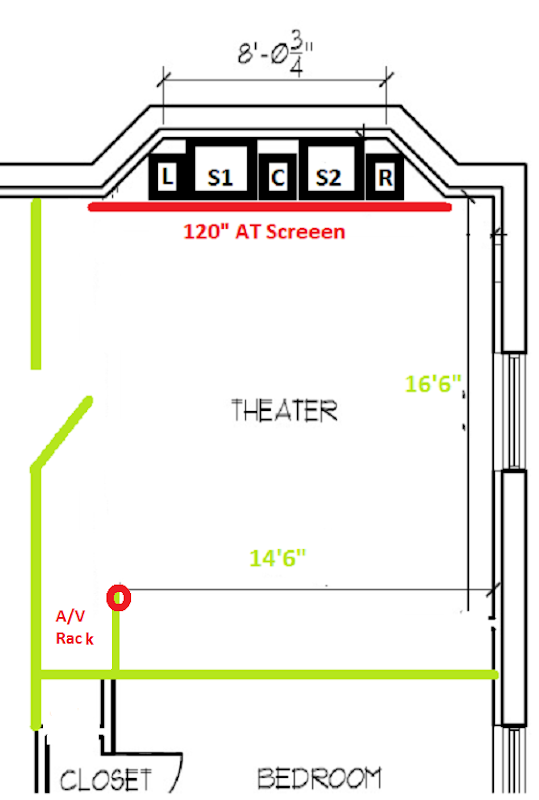

Here is a dimensioned plan of the space:
For simplicity, assume the top is "North". I think the most workable location for the screen is on the North wall. I'm hopeful the shape of that foundation wall will allow for enough room to put speakers behind the screen.
On the East wall, there is a window and the main circuit breaker panel. Keeping access to the window is not essential, but is desirable just for safety reasons (there are other escape windows elsewhere in the basement). Some form of access to the electrical panel is needed, of course. Are there good ways to hide such things without compromising the integrity of the theater? Is the fact that the East wall is offset from the center-line likely to be a problem?
The South wall's location is somewhat flexible (a guest bedroom will be on the other side of it). The drawing shows the preferred depth for the theater, but if it would help, that wall can be moved around some.
Here's the biggest challenge: The West "wall" is, as shown, going to be open to the basement family room. I don't think there will be an lighting issues related to this (light in that whole area can easily be controlled), but I just don't know what the sound implications are of having a (mostly) open wall on the left side of the theater are. I was thinking that much of it (aside from a "doorway") could be a half wall and a column or two where necessary for speakers. In general, for a variety of reasons (primarily the wife wink.gif ), it would be best if it could be open. Is this a deal-killer? Does having the open wall make treating the area as a dedicated theater pointless? Of course, I'm hoping the answer is "no" (although my bank account my feel otherwise biggrin.gif ).
I don't feel competent to build this space myself and was thinking about employing professional design services. However, before I dove into that, I wanted to try to assess the feasibility of this entire project. Any thoughts are greatly appreciated! Let me know if more dimensions/pictures would be useful; I didn't want to clutter things up too much on my first post smile.gif

On the seating front, I was kind of hoping (perhaps wildly optimistically) to get 2 rows in. I've not been able to find able to find a good guide on minimum room size (depth) for having 2 rows. How far does the back row need to be from the back wall? How close can the front row be? I know there are issues with being able to see the weave in an AT screen, but I've seen suggestions anywhere from 7ft to 11ft minimums (which is a pretty big spread with the space I've got available). I feel like there are so many inter-related variables for seating and screen size and I can't seem to lock down any of them to solve for the rest smile.gif
Regarding soundproofing, this area is right under the kitchen. Is there no point in even trying to apply some soundproofing to the ceiling? I've done some reading on various soundproofing techniques, but the effectiveness (or lack thereof) of partial measures has been difficult for me to judge.
I will try to put together a couple of design options on paper and see where that takes me.

The sound implications are going to be an issue, when the Mrs doesn't want to join you to watch your action movie. You'll be disturbing the
rest of the house, or you'll be listening at greatly reduced levels. Someone isn't going to be happy.... You'll also lose the symmetry of the missing
wall and accept reduced audio quality of any speakers you select.
A window plug will keep the window functional and offer light control.
Sound proofing is an "all or nothing" thing. The open side wall will undo any soundproofing efforts. Adding the missing side wall will be best money
you will spend in the room.
Ten foot viewing distance to the XD works excellent.

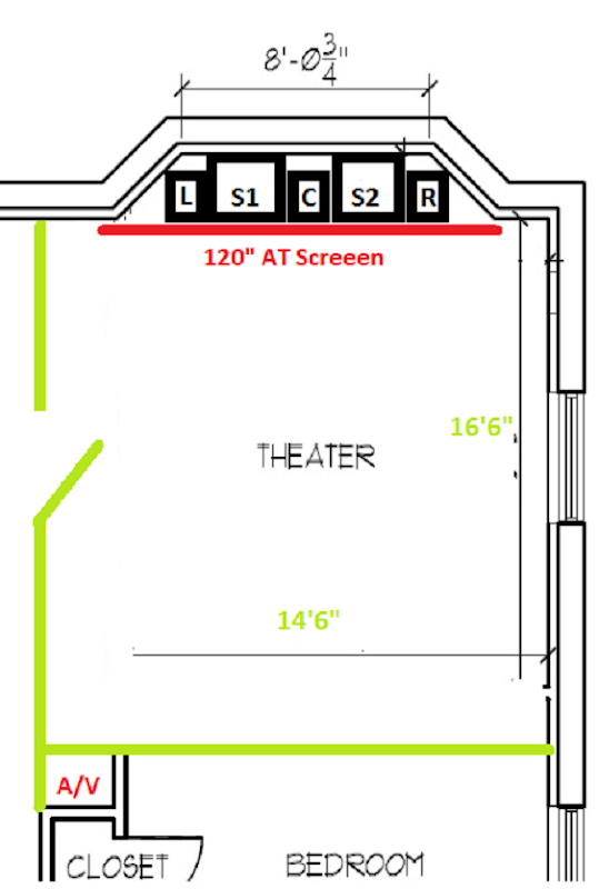

I'd suggest staking out a little more width, work in the av rack, and stick with a single row of seating.

I'd actually suggest flipping your room 180 degrees. Put the screen on the south wall. I think that little alcove on the north wall is useless to you if that's your screen wall. I might use it as a media rack and hang your rear surrounds back there. I'd also recommend walling off the west side because I don't think the counter offers much extra in the way of more viewers. They'd be looking at a pretty hefty angle, you lose more brightness on your screen, need more subwoofer power, and lose the possibility of sound isolation. If you want an equipment rack, you could put it in the northwest corner. You could actually build a closet in the northeast corner of the living room area. Lastly, 2 rows is really not feasible in this room unless you plan to use actual movie theater seats. I think I'd just go with a single row of 4 seats (loveseat in the middle gives you a little more space off the walls).

I did put the alcove to work, for a shallower AT space depth, and still have room for the speakers to be 6" off the back of the screen, and hide the subwoofers (which
shouldn't have ports or drivers facing the screen). The wing section can be put to work to hide some bass traps.
Rotating the room ninety degrees, so the east wall is the screen wall might work well with the room being kept open concept with a single row of seating. The bay window alcove could
recess the av rack into a straight side wall. The rear surrounds could be in ceiling, in the family room. You lose the window but you can use a standard screen, with a standard exposed
speaker layout.

Thank you for the sketch of a layout, that was very helpful. I'm hoping to put together a couple of revised plans myself this weekend to play with these ideas some more. On the (long) list of things I'm still trying to get my head around, how far towards the edges of the room/screen should the L/R speakers be? I had hoped to use the alcove as you showed - as a way to place the speakers behind the screen without losing much room depth. The edges of the alcove, however, could potentially negate that if the speakers need to go all the way to the edges of the screen (or the screen size will be limited, of course).

So, I've played around with some potential layouts and ideas, and I think I'm converging on one of two options that are actually pretty similar, except for their orientation.
Option 1: This option keeps the screen wall on the North wall, as originally planned, and draws heavily from Tedd's suggestion (thanks!). The L/R speakers are 9 feet apart and partially fit into the alcove. I wasn't sure what a typical depth for speakers was, so I assumed 2 feet (and 1 ft wide) and then tacked on another 6" to the screen. Presumably if speakers are not that deep, I could move the screen a little closer to the North wall. The seating position (one row) is 11 feet from the screen to where your head would be. I've assumed as 120" wide 2.35 AT screen, which might be a little big, but I figured I could size that out a little more accurately once I had some of the other variables figured out. If it gets smaller, however, the L/R speakers would be outside (or partially outside the screen) - is that a problem? I spaced the speakers to have a 45 degree separation with respect to the seating position.
As you can see, the side surrounds are a bit of a sticking point. I put in two different options in terms of alignment for them, but I assume they will be symmetrical. The left surround is shown in a column on a short wall extending off of the planned hallway wall. This is a preferred location from the standpoint of the rest of the basement layout, but looks a little tight in the theater. How far should the surround speakers be from the seats? Also, I wasn't sure what dimensions were appropriate for those speakers either, so as shown, they are 1 foot deep and 2 feet wide. Perhaps an in-wall speaker rather than a column would open things up a little more? The right surround speaker is also shown in a column, but is further away by virtue of having some additional horizontal space in that part of the basement. That wall could be brought out to make it symmetrical, of course (or the column extended or something). Seems like there is less of an issue on the right side.
The West "wall" could potentially be moved out some, but there is a pole that is dictating some of the other wall positions in the basement (shown in the South-West corner of the theater). While most of that side would be open, I was planning to run a soffit to help define the West edge of the space (and possibly hang a curtain as Jeff suggested if that could help improve sound quality).
I didn't draw any rear channel speakers. From some of the numbers I ran, it seems like there is not enough distance from the seating position to the back wall (about 2.5 feet, I believe) to have much separation for those channels (60 degrees)? Will in-ceiling speakers improve that? Should I just accept a wider-than-optimal separation as a consequence of the room? How will that impact the sound from those channels? It may be possible to move the South wall back a foot or two, but that is not preferable. This narrower distance probably eliminates any form of second row seating, also, unfortunately.
Option 2: This option rotates the room 90 degrees, and I am really falling in love with this approach (thanks again Tedd!). Again, the L/R speakers are shown 9' apart, 30" from the East wall to the screen position, and 11' from the screen to the seating position. As shown, the screen is a retractable 2.35 120" AT screen. This approach leaves a lot of flexibility on some form of additional seating and I hope with full side walls, greatly improves the audio possibilities. I'm not sure what to do with the alcove and whether leaving it open will cause sound problems, etc, but that seems like a minor issue at this point.
There are two main sticking points with this option. First, a minor one - there is a window in the wall in the area where the center speaker would go. Since I do not believe I need to have access to this escape window, I think either some kind of blackout shade/tinting or window plug should address any light issues. The window is just under 3' from the floor. I don't think it will cause any problems with mounting the center speaker because the speaker should be completely in front of it, but thought I would mention it.
Second, a major (and potential deal-killer) sticking point is that there is an electrical panel (which will need to have a sub-panel placed on one side or the other when we finish the basement) pretty much right behind the left channel speaker. I've been wracking my brain all weekend trying to figure out how I can go with this orientation option and still allow relatively easy access to the panel. If it helps, here's an actual photo of the space, towards the North East corner (you can just see the pole in the bottom right of the picture):
Any thoughts? Can the left speaker be mounted in such a way that it is easily moveable? Additionally, if I did a screen wall (which I would prefer over the retractable screen), is there some way to move the screen out of the way and/or get behind the wall easily? I've seen a few threads discussing hinged screens, but even that isn't complete, as there is still the lower portion of the wall in the way. Maybe curtains on the edges and not having the screen wall go all the way to the North wall? I'm not sure if that will leave enough room to get to the panel. The panel has to be accessible - I'm sure code requires it and also, if a breaker trips, I don't want someone stumbling around in the theater in the dark trying to get to it and walking through the screen eek.gif
As always, thanks again for everyone that has chimed in so far, your help has been invaluable, and more input is greatly appreciated!

Okay, with some time to further consider all of your helpful input, I'm starting to feel like this is doable and that the electrical panel won't be a deal breaker (and my bank account is starting to cry wink.gif ). If you'll indulge me, I have a few more questions that I haven't been able to find "best" answers for:
1) Would it be possible to mount the screen on some kind of sliding mount? It will overlap the electrical panel access by only a foot or less, and if I could just push it aside when needed, that would be ideal. I was thinking maybe re-purposing a drawer slide or something. The only problem I can think of is the potential for rattling? My concern with the cleat mount that Tedd proposed is that, not knowing how heavy the screen is, I fear it might be awkward for one person to remove it when needed. Maybe that isn't the case?
2) What is the proper speaker width behind an AT screen? I had read many places that 45 degrees was the ideal separation for L/R speakers, but that would tend to put the speakers at the edges or even outside the screen at many common viewing distances. I've seen a lot of recommendations for having the speaker well in from the edges of a 2.35:1 AT screen and one or two mentions of having them at the edge of where a 16x9 image would be on such a screen. But that results in much less than 45 degree separation. Any advice on the "right" answer (or at least where I might look to get a better understanding of the tradeoffs)?
3) If I ditch the AT screen and just go with speakers outside of the screen, any suggestions on how to mark where the L speaker would go for when it inevitably gets moved to access the electrical panel? I'd at least want to be able to reliably put it back where it belongs smile.gif
4) Earlier on, some of the proposed designs people provided included space for the A/V equipment/rack. I was already planning on having an equipment rack for other whole-house A/V stuff in another part of the basement (near my wiring closet). Is there any reason any A/V equipment needs to be in (or nearby) the theater room, beyond maybe a Blu-Ray player? Are there any issues with speaker wire lengths? I'm pretty comfortable with the video issues, but know little about restrictions on speaker wires.
As always, all of your feedback is greatly appreciated! Hoping to sketch up a new design this weekend, but it might be tough with some out of town travel.
Screens aren't heavy. And the Mrs could help. I'd be more concerned about damage to the screen then weight.
2) What is the proper speaker width behind an AT screen? I had read many places that 45 degrees was the ideal separation for L/R speakers, but that would tend to put the speakers at the edges or even outside the screen at many common viewing distances. I've seen a lot of recommendations for having the speaker well in from the edges of a 2.35:1 AT screen and one or two mentions of having them at the edge of where a 16x9 image would be on such a screen. But that results in much less than 45 degree separation. Any advice on the "right" answer (or at least where I might look to get a better understanding of the trade offs)?
Optimally, the L and R will be 30 degree spread, off center, for a 60 degree spread total in total. But those numbers can flex as the design should be start with seating and placement of eyes and ears.
You are way overthinking a lot of this.
Hdmi cable length can sometimes be tricky. My personal preference is to have the av rack outside the theater. No light pollution from av gear, no noise, and no heat from gear. I've had my av rack up front which I considered a mistake, then in the rear side wall (much better) and my last rebuild has the av rack
right outside the room. Any theaters in my future will be done this way.

Originally Posted by DavidK442 View Post
Have a look at pocket door hardware.
Will do, thanks! That could be a lot simpler than the drawer slide configuration I was envisioning. Is rattling/shaking likely with suspending the screen that way?
The screen getting damaged was definitely another concern I had. It seems like it would be very awkward for a single person to move it and Murphy's Law clearly dictates that the screen will need to be moved when I'm not around to help smile.gif . That's why I was trying to find a way to allow it to slide the foot or so to the right that would be needed. I think the pocket door/drawer slide approach could work well, but I worry it might rattle being nearby (but admittedly several feet above) the subs.
The reason I'm trying to nail down the L/R placement is because we'll have to add a subpanel to the electrical panel to finish the basement. The subpanel will probably go to the left of the existing panel. If the speakers an can be "inside" (the L speaker being to the right side of the existing panel), then that isn't a problem, it just comes at a cost of a narrower spread between the L/R speakers: ~7', which is about 37 degrees at an 11' seating position. I don't know if that is unacceptably below the 45-60 degrees that have been recommended. If so, and the speakers need to be wider (closer to the corners), then I will have to go with free-standing speakers, rather than in-walls/behind-the-screen types. So the speaker placement is actually going to dictate the screen wall positioning/construction. That's why I'm trying to figure out which way I need to go with the speakers.
It's what I do biggrin.gif . Still, I'm glad I've asked because I've learned a ton from everyone!

Originally Posted by djkest View Post
Here's what I would do. I borrow about a foot from the bedroom and from the adjacent room, full wall with sealing door. This allows you 2 full rows and plenty of width. Front soundstage will be a little narrow but doable.
That is in line with what I was originally envisioning, but there is a column in the South-West corner (didn't show up that well in the original figure, sorry about that), so I can either take some space from the bedroom or take some space on the West side, but I can't do both:
Regardless, an unfortunate design constraint is that the left wall can't be built/room cannot be completely closed off, as dictated by higher power wink.gif
Foxtrot4 is offline

That's not a problem.
Just integrate that post/beam into the AV closet. You lose 1 set in the back, but it's not a major issue.
Also, tell the [higher power] that the theater gets to be the way you want it, and [it] can dictate the other rooms. smile.gif It's your house as much as [theirs]. There are lots of benefits that [THEY] would appreciate to being able to close the room off. Light control, noise control.

After playing around with the design some more, here is the latest plan:
Still have the 11' seating distance, which seems to match up very well with the 120" screen width. The bar/second row is just a doodle to see how it might fit.
A big question now is with respect to the center channel. If I put it behind the screen, in this configuration, it will have to be a very short depth - basically in-wall (4-6" deep), as I just don't think I can give up the 30 or so inches needed to do a true false wall. Here is an elevation of the screen wall:
As you can see, the window is pretty much exactly where the center channel needs to go. Is there any way, short of building a full wall in front of the window, to put an in-wall speaker in this space/in front of the window? Could I just put up some framing for the speaker itself, leaving most of the window exposed/semi-accessible? Is that going to cause sound quality issues? And would those issues be worse than positioning the center above/below the screen?
And, speaking of sound quality issues, I'm guessing the alcove on the North wall and the lack of any real back wall will have an impact on the sound quality - are those likely to be major problems? Are they things that can be compensated for? I know four real walls make so many of these concerns go away, but I just don't see that happening...
Seems like there are always more questions with this project smile.gif Still, I feel like the plan is starting to come together biggrin.gif
Foxtrot4 is offline
