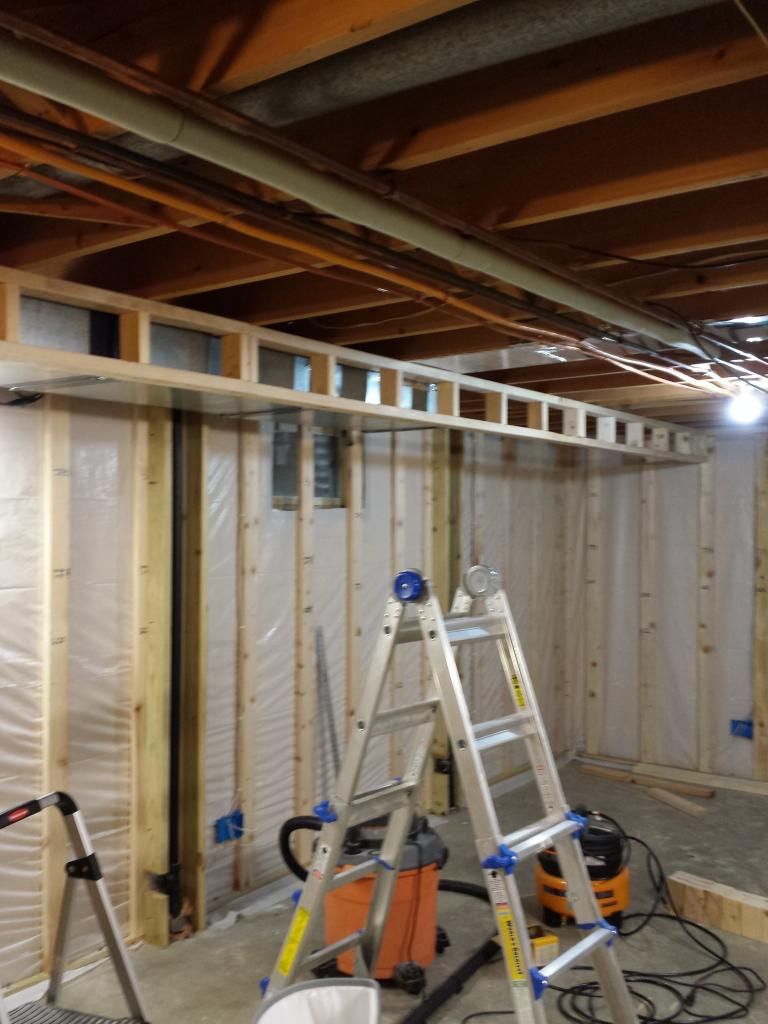

I added top plates to the ceiling for all the new interior walls, but framing had to be put on hold. I kinda forgot about a remodel permit... (which I should have today). This weekend I'll have all the wall framed with pictures posted smile.gif
I won't be doing any work today or tomorrow since I'm on vacation (me and the wife's 10th wedding anniversary!)

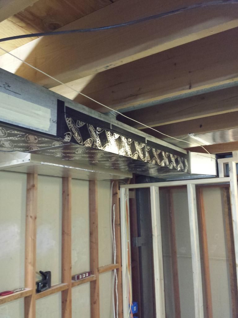

I'm very close to being done with framing!
I put Dynamat on the duct work. Made a huge difference if you knock on it now compared to before! It used to just rattle and ring endless it seemed with just a slight tap

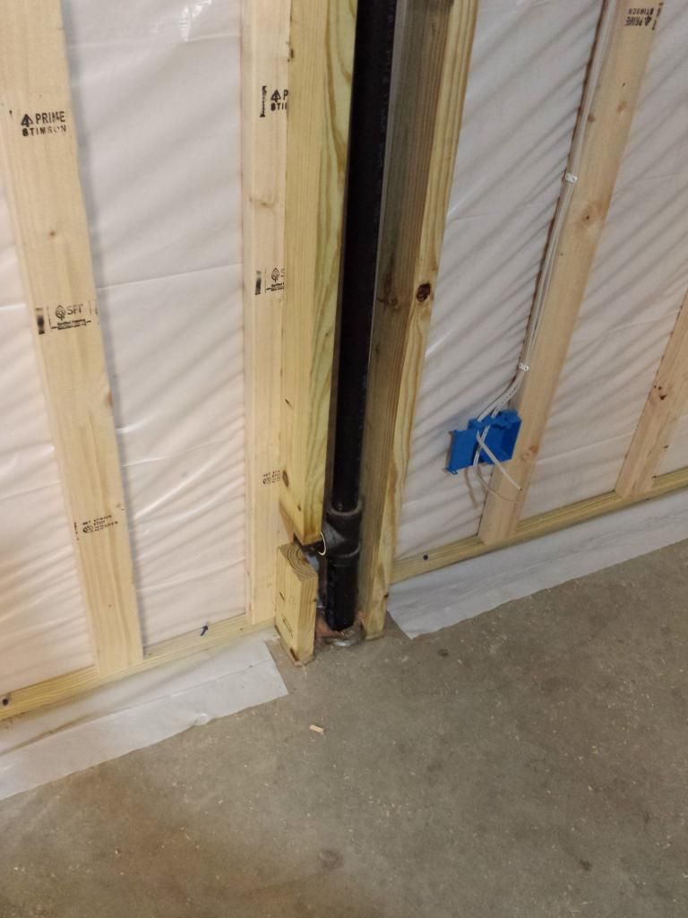

I also had to frame around this PVC and there were two of these
My goal is to be done with framing TODAY. I want the rough-in inspection for framing, electrical, and HVAC done by mid-next week at the latest. I need to get the drywall going and soon.
thanks for this I have a similar set up. Are you going to box the bottom of the duct as well? how do you drywall that off?
There's going to be tongue-and-groove pine on the bottom of the soffit that will be removable.

Dynamat is good stuff.
FWIW we have duct work going across our room. It was framed and rocked when we bought the house. When we ran wires we had to break into the rock. It's just framed and rocked, no insulation, and I can't hear any ill affects.
If I had the choice I'd wrap in insulation for more reasons than one.

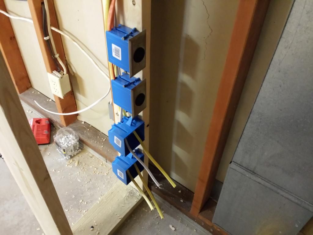

LED lights are up
Think this is enough juice for the amp rack
Rough-in inspection is tomorrow morning. If all goes well I have help lined up for drywall in Thursday.

Orange wires= good!
