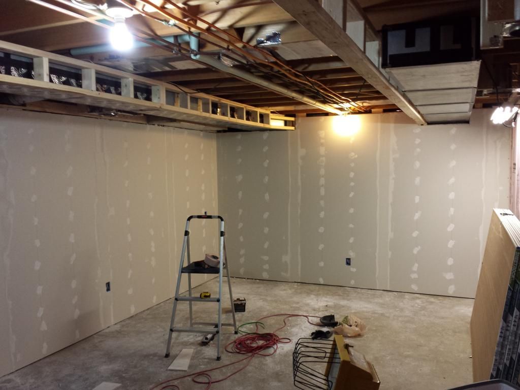

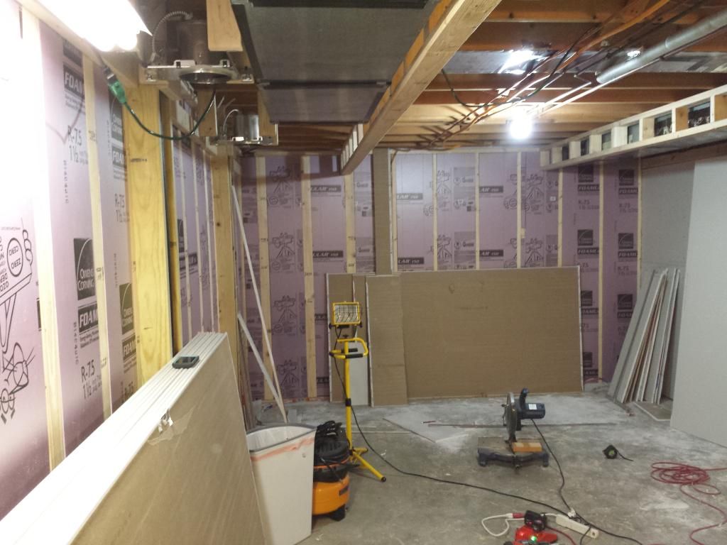

All the double-layered 5/8" is up
Tomorrow is the 1/2" on the other two cinder block walls

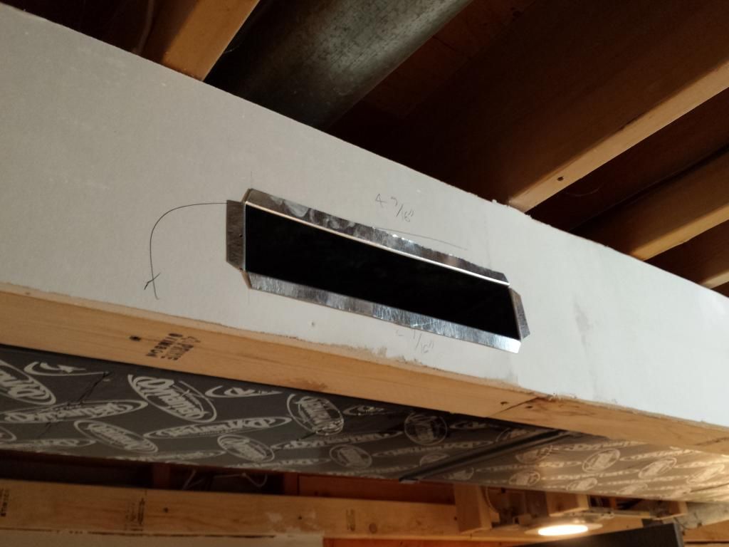

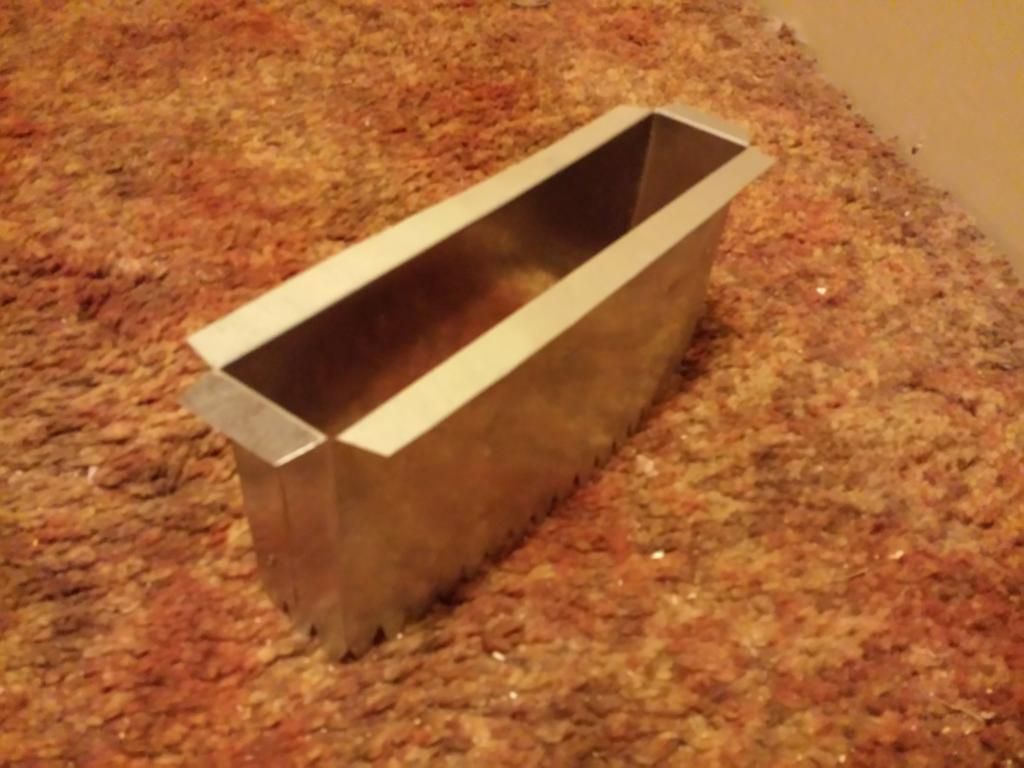

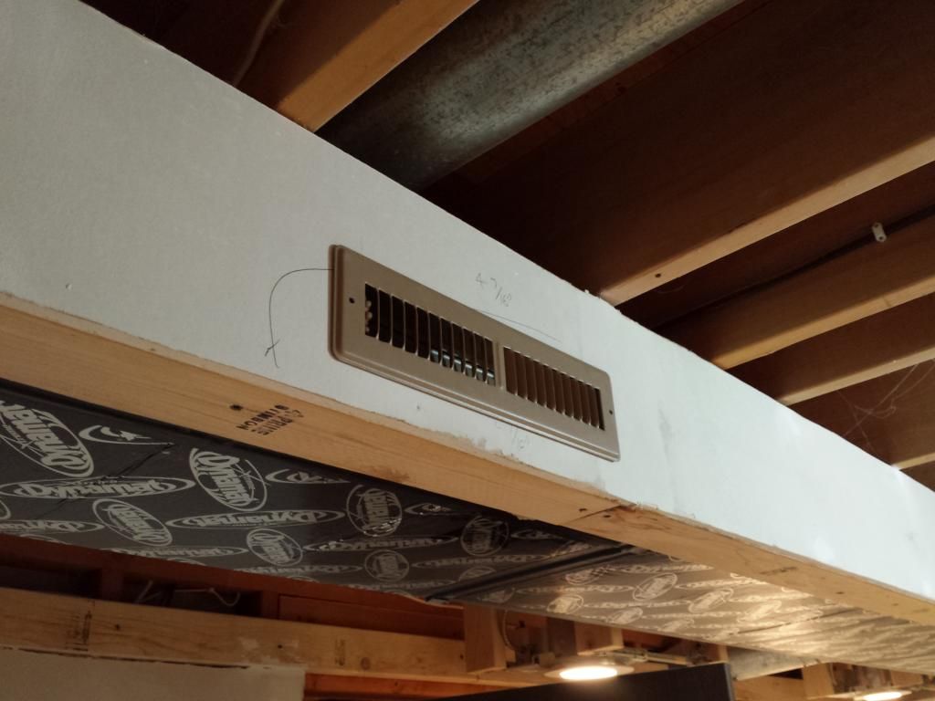

If I can ask, please get some good photos of how you finish boxing the vents - that will be critical for me.
JRock3x8 is offline
Lucky for me my dad was in the heating/cooling trade for years, so he'll be doing that! I'll take some pictures of what he makes for those.
JRock3x8 likes this.

still curious to see how the bottoms get boxed off

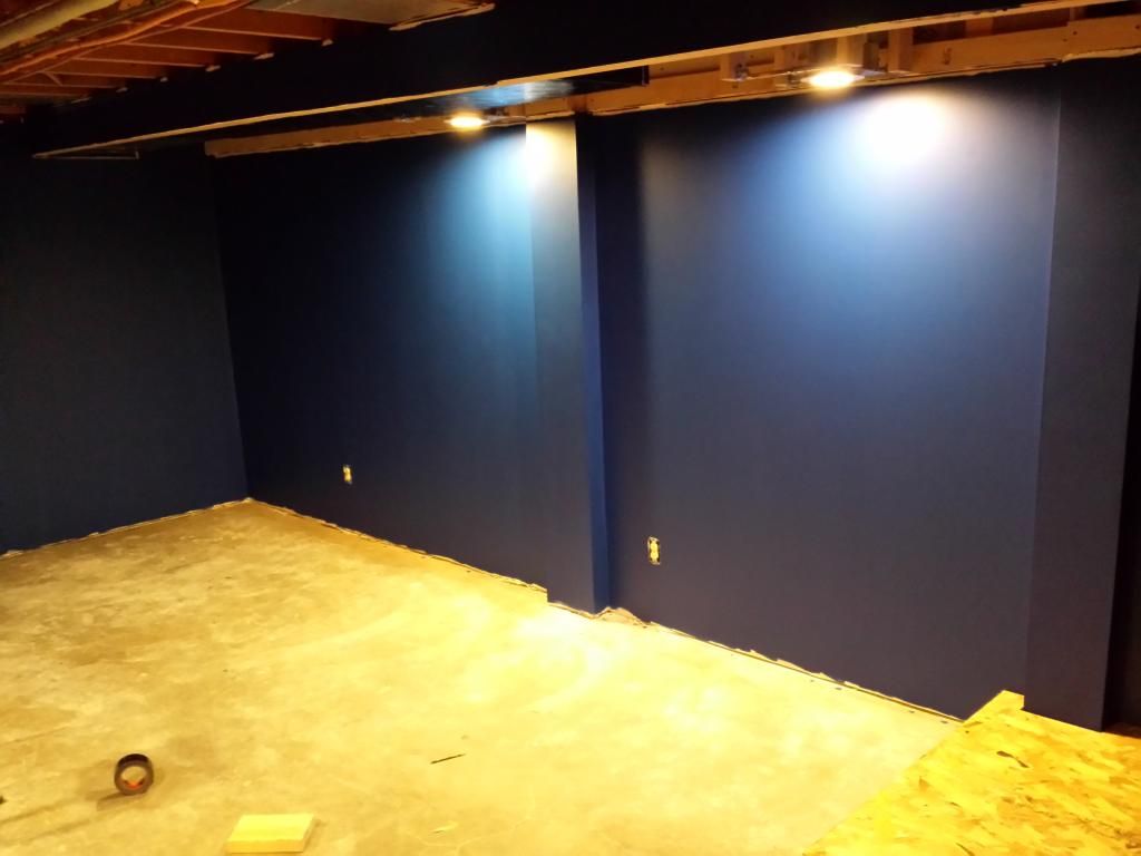

Originally Posted by lukeamdman View Post
first coat of paint is on!
pics!
so do you just drywall across the bottom?
That will be tongue and groove pine so that space is accessible.
still not following that at all but I am assuming you will photograph it when it goes up.
You can see on the outside wall behind the soffit there is a 2x4 that's mounted horizontally. The drywall goes right up to it. The bottom of that 2x4 is the same distance to the ceiling as the bottom of the soffit to the ceiling.
I'll attach tongue and groove pine at the bottom of that 2x4 and it will span across to the bottom of the soffit.

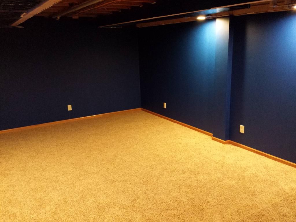

Riser depth is 6' 4"
I installed the base board trim last night, and carpet is being installed right now!

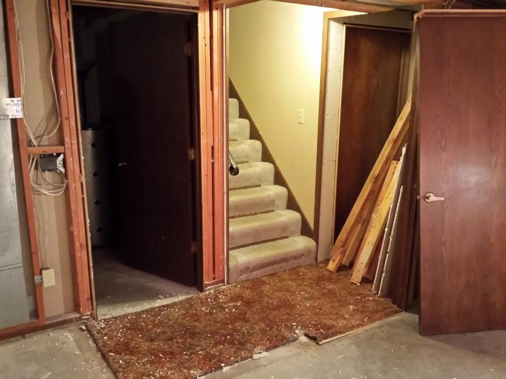

Liked: 1481
Originally Posted by stormwind13 View Post
And money says the entire sound system and video will be up and running before the end of the day.
Ha, nope! I did get one Othorn in there to run some sweeps, but that's it.
First things first, I removed that dang hallway at the bottom of the stairs.
