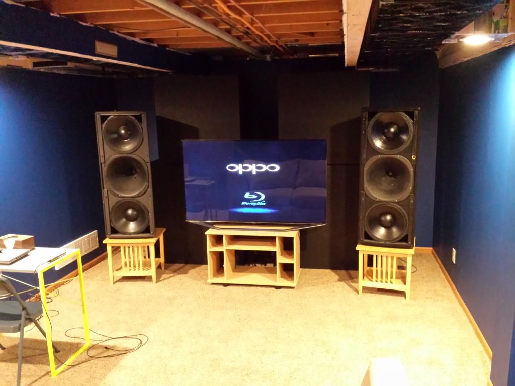

Next on the list is acoustic treatment...and a lot of it. Cash is low right now, so it's not going to move very fast. For now I'll be doing what I can with the OC 703 I already have.

I'm not sure. I'm new to the whole acoustic treatment stuff.
Right now the bass is way too "boomy", and the treble echoes on and on endlessly. That's what I expected with zero treatments though.
The biggest issue, which I'm not sure can be fixed, is the sub 40hz bass for the front row. It's about 15db less than the back row! Everything in the front row sounds weak/thin/lame.
lukeamdman is offline

You need to move your subs. Boomy is harder to get rid of. You can hang a bed comforter on the walls and get rid of the echo for the most part. But you'll need thicker treatments for lower frequencies. The thicker the more they generally dig lower.
You could consider bass trap riser, bass corner traps. Or you could try some of those funky traps with all the holes cut in them like Nick****achi did. You might even want to do front and back walls as bass traps. Or move your seats a little. Sounds like your sitting in a null.

Put some pictures up of the room and where everything is, you'll get some feedback. It's tough to tell from your current pics where everything currently is.
You already carpeted your riser right ? Did you stuff pink fluffy? Put a grate or two or a single long grate along the back wall. You should be able to cut the carpet and have it look good/hidden under grate edges.

Moving the subs had no effect on the front row or the "boominess". Additionally, the front row can't really move anywhere else.
The entire back wall will be covered with 4" of OC 703, with several inches of an air gap between the wall and the insulation. There will also be bass traps in the front two corners from the floor to the ceiling.
The first reflection points will have 4'x4' panels of 4" 703. All the floor joists in the ceiling will be stuffed with cheap fiberglass insulation.
For the rear wall behind the seating I'll have to wait and see how things look after all the above is done.

You might need to look at adding a balancing sub or two to help get rid of that null. It doesn't need to crazy. A 15 or even a pair of 12's in the back of the room or placed along the side walls will go a long way to smooth out the response.

Yeah it's definitely something with the room. If you could spread out or relocate your subs it would make a huge difference. Since you have horns, using a smoothing sub might be problematic without DSP.

Moving the horns closer to the walls actually reduced output across the board for the whole room. I moved them around for a few hours taking measurements before they ended up where they are now.
Just the thought of adding any more bass gives me a headache...even if it is something small.
I think the acoustic treatment will help quite a bit.
