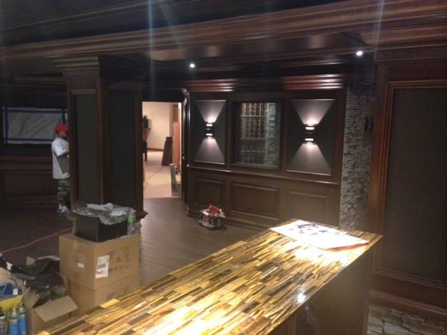

Sorry to leave you all hanging for so long! Got busy of course, and haven't been on the forum much lately. Thanks for your patience.
The room is in fact done. You can check out some photos on the Erskine Group Facebook page. It's not the one you've posted above, it's the one dated August 9th on their page:
https://www.facebook.com/pages/Erski...34577633257657
Of course, they did a fantastic job. The room looks, works, and sounds great. Special thanks go out to Steve Kujala, Adam Pelz, Justin Vogel, and of course Dennis Erskine. These guys had to deal with a lot of challenges on this project and handled it all very well. I'd recommend them higly!

what, no pictures of the racks?

No, but the soffits are pictured, and hidden inside the soffits are the painstakingly run wire chases.
