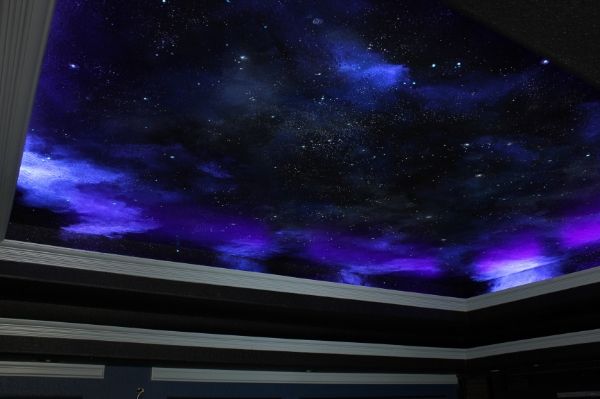

Ceiling progress-This is the first "layer" of the mural after the first day of painting. The muralists need another 1 to 1-1/2 days to complete it.

Very nice Job guys. Thats a sweet looking room, and that ceiling / mural is fantastic

Love that ceiling!!! It's beautiful. Wish I had the talent to paint the daytime murals too. smile.gif
Looks like the room is coming along nicely!

We used your paint today to create the glow stars. We'll get some pictures up next week.

Nice! How is the glow with the lights off? Whenever I've mixed white paint with it... the glow is diminished. Were you guys able to get a good glow out of it? If not, I will be in Dallas, Houston and San Antonio this coming week and can get you more paint, if you'd like.
Shoot me an email if you'd like some.

Hannon Designs finished up the ceiling mural on Friday and I got to see the finished product for the first time today. I think 7channelfreak was a little worried I didn't like it because I initially didn't say much. I think that's because my jaw was on the floor.
The first 3 photos are all taken from the same angle, but with different lighting.
Under normal light (no black light, no rope light)
Rope light only
Black light only
They used a variety of techniques to provide different effects under different lighting conditions. Some of the stars are done with regular white paint so they show up under normal light. Other stars are done with glow in the dark paint so they charge under black light and are visible in the dark. They also used a glow in the dark paint that only shows up under black light but disappears when the black lights are off. Some of the "clouds" or atmosphere were created with this paint. Under black light, it gives the illusion of distant lightning or some type of solar storm. I'm beyond impressed with the finished product.
Atmosphere effects under black light
Close up under normal light (a little overexposed)

That looks so sick! Very nice!
