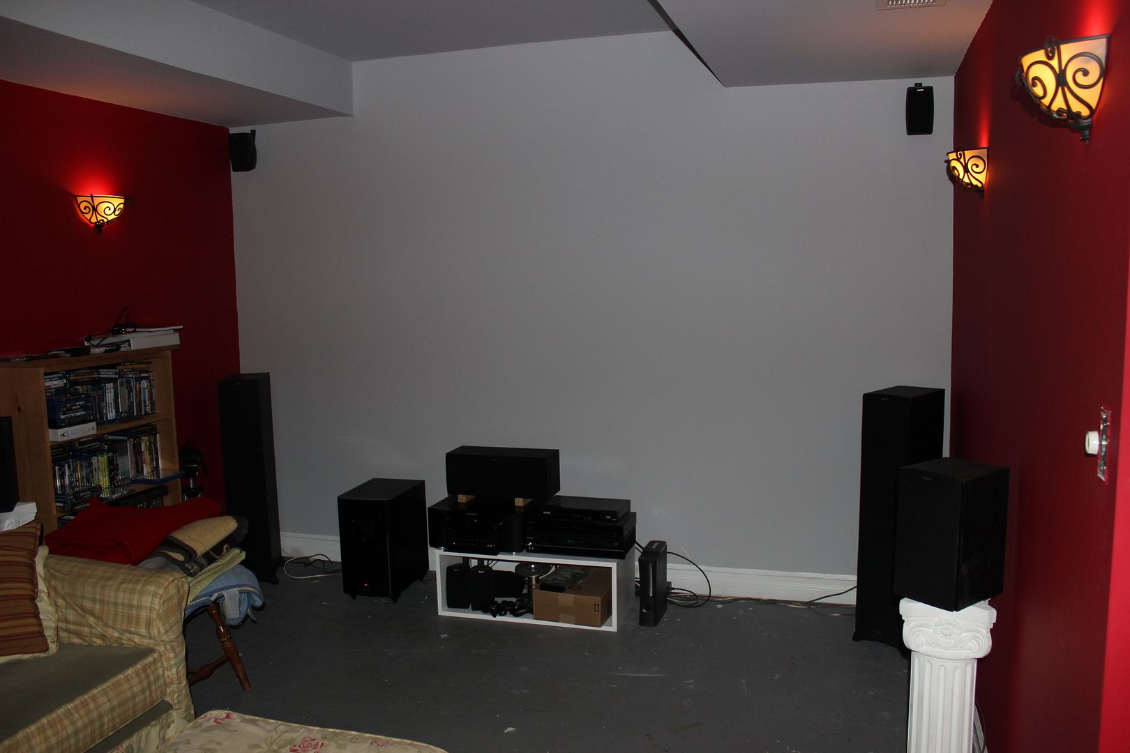

My house has a finished basement with one large room and a bathroom. As it is currently configured, the large room is not very useful for my purposes. I'm thinking about partitioning the large space into two rooms and a hallway. One room would become my office (I'm currently using a bedroom, which is less than ideal). I'd like to put a home theater in the other room.
I've measured the basement and modeled it in SketchUp. The proposed floor plan I'm currently working with results in a home theater room that is 11' wide, 18'8" long, and 8'7" high. Ideally, I'd like the room to be wider, but I haven't figured out how to do this without compromising the office on the other side of the wall to an unacceptable degree.
I've never built a home theater before, so my questions to those of you who have are:
(1) Is 11'W x 18'8"L x 8'7"H an acceptable size/ratio for a dedicated home theater? At times during the modeling process, I've wondered if the proposed room is too small for a theater experience, and I haven't yet carved out a space for the A/V closet.
(2) What diagonal image size can I realistically expect from a projector for this room? While it appears that some projectors would be capable of, say, a 125" image with a 17' throw, I don't know that the definition would be acceptable from a 1080p source unless one was sitting near the back of the room.
(3) How many people can I expect to comfortably seat in a room this size? There are four people in my immediate family, and I'd like to be able to seat some friends as well. The guy in the SketchUp scene makes three look like it'd be a crowd.
Thanks in advance for your insights.
Current basement:
Proposed basement:

 If you are willing to consider using part of the office as an equipment/projection room you could increase your throw a bit and potentially use your big wall for the screen.
I considered that, but don't think I can gain enough distance. It's hard to tell from the images, but assuming the "front" of the basement is where the man is facing, the space is wider than it is deep. I could get the most throw by eliminating the hallway from the plan, but then of course I still wouldn't be using the larger wall.
The other potential issue is the bulkhead that spans the basement, which lowers the ceiling height from 103" to 88". If the projector were mounted somewhere behind it, then it would have to be at least 15" lower than would otherwise be the case. I don't know enough about projectors to say if that's acceptable or not.

 I went through a similar exercise, and the most helpful thing I did is tape it out.
Thanks, this is a great idea. I'll probably do it tomorrow.
