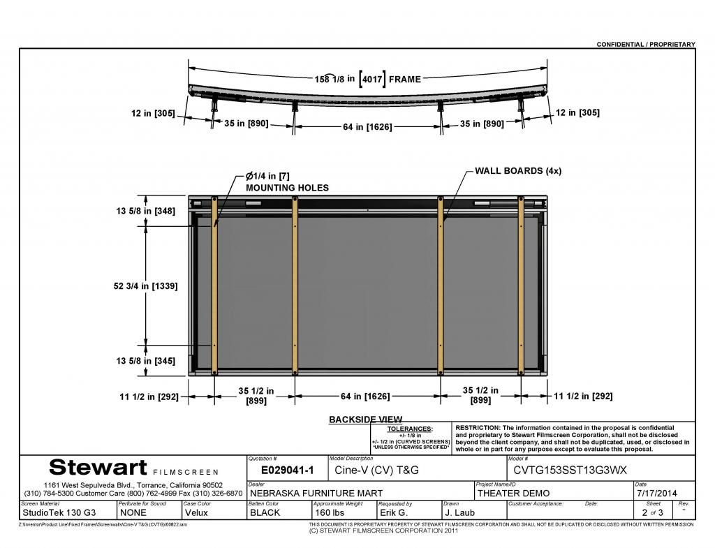

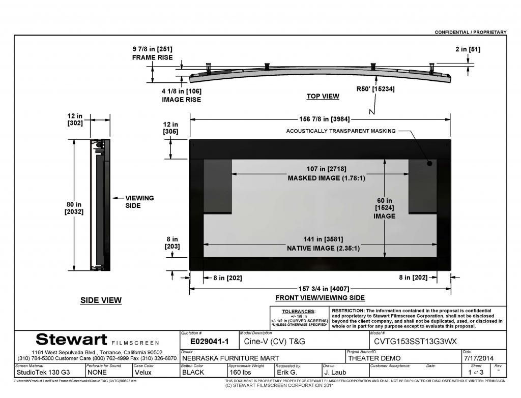

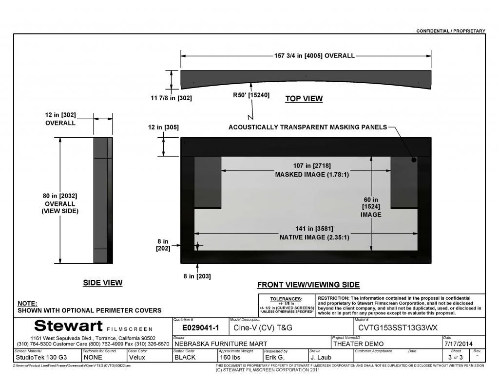

That's what I am doing, but I only have about 18" on each side, so it's not going to be a big visual feature. I am doing it to get a more polished look without the screen edges visibly pulled away from the wall when the lights are on. With the lights off, you'd never see it.
The chord height (also called frame rise) of the arch is just under 10" for a 12' width of screen if it has a 50' radius. It's closer to 13" with a 40' radius. The best way to think about frame rise with a curved screen is if the frame was sitting face down on the floor and you measure from the floor to the highest point of the arch at the midpoint of the frame.

I don't remember Vic's screen coming out 10 inches on each side. my memory was about 6 inches.
I just put a 600 inch radius and 144 wide screen into two different calculators and got a rise of 4.3 inches. Certainly not 10 inches.

I'm having trouble uploading the engineering drawing for my 12' wide (approx.) Stewart Cine-V curved screen for some reason. I'll try again later. Given the same size screen and radius, the only difference in how much the screen sticks out would be frame thickness.

I guess I somehow envisioned a more extreme curve. But in that picture that is posted, it looks like everyone would have a nice angle regardless of where they sat. Like I said, I have never seen one so I can't say what the advantage might be.
You're talking image rise, which doesn't account for the frame. Frame rise gives you the total depth a screen flares off the wall.
Here are the engineering drawings for my curved Stewart Cine-V. 2.35:1 aspect ratio, 50' radius curve. 141" image width x 60" image height. As you can see, image rise is just over 4" and frame rise is almost 10".

If your question is in reference to the drawings above and the frame rise / image rise differences, that's simply driven by all the CAD and rendering work I'm having done in the background. I bought my Cine-V second-hand and, based on the serial number, Stewart was kind enough to forward me the original CADs and a CAD DWG file for scale reference / placement in the renderings so the object didn't have to be modeled from scratch. So I've been knee-deep in the same considerations as Beast is going through right now with the exception of curved vs. flat because I'm already committed to curved for a handful of reasons.
In the end, I'm going to be building a curved screen wall to get a slightly more tailored look for when the lights are on and to jive with some of the things I'm doing on either side of the screen with the finish carpentry.
