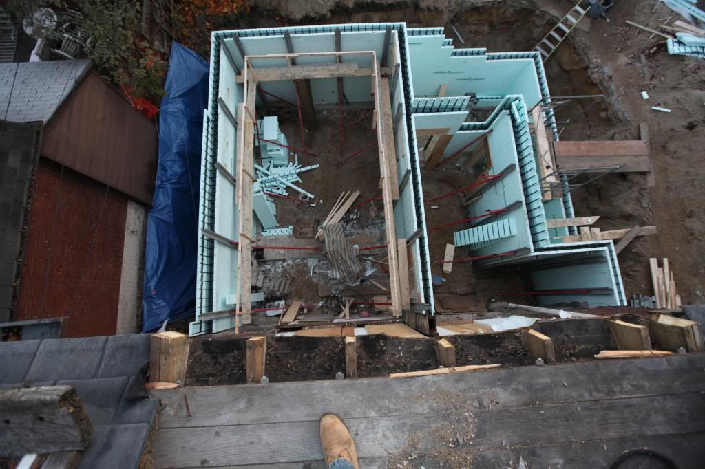

0017 Foundation ready for braces and concrete.
0018 Aerial view.
0019 HT walls ready to pour.

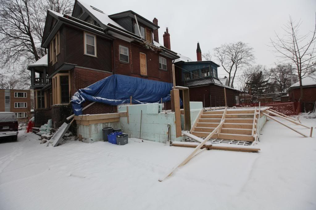

0026 Exterior stairs.
0028 After cleaning all the snow out of the forms with our bare hands, we poured the 1st floor and stairs.
