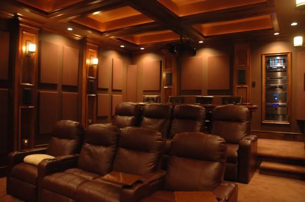

do a desk height sit at bar with desk chairs. Think of it as a 12-18 inch deep drink ledge 30 inches tall. get some nice plush executive desk chairs in material to match your seating.
IndyGreg did in his project, but his pictures are MIA
found another example instead
http://www.avsforum.com/t/1360031/bar-behind-seating-ideas/0_40#post_20942364
BIGmouthinDC is online now

The picture I showed you had a second riser just like yours.
I also think the naked projector doesn't look so bad, if you build a great room people aren't going to care where the projector is.
The idea you kicked around looks like a 42 inch tall back bar, I propose a 30 inch tall version sitting on your riser.

ctviggen's Avatar
Posts: 2,091
Quoted: 74 Post(s)
Liked: 31
The only problem is the noise. Fan noise drives me crazy. Consequently, I'm typing on a fanless computer with no moving parts. I'd prefer to keep the projector hidden, but I realize it's a choice between increased cost versus increased noise. Even fan noise that starts at a reasonable level becomes tough for me after a while. Dust and age are deleterious to fan noise.
Bob
ctviggen is offline
