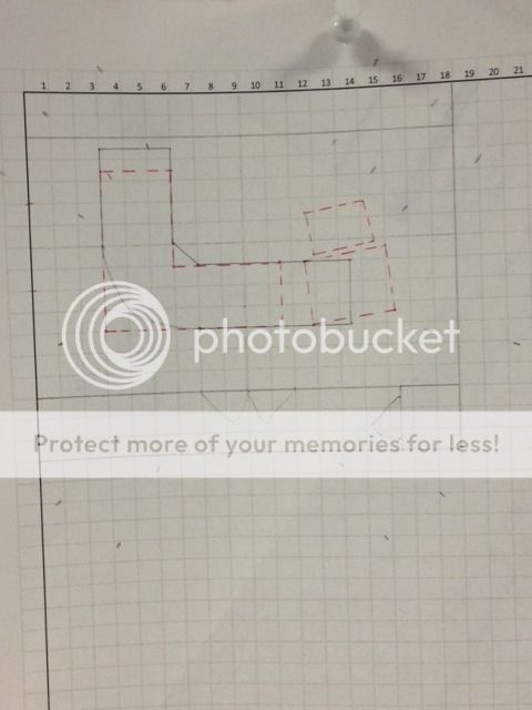

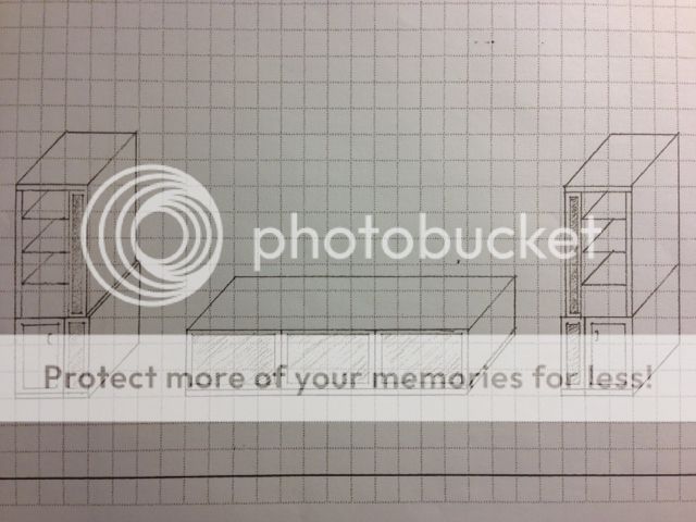

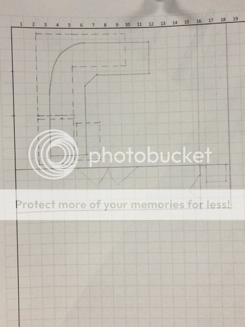

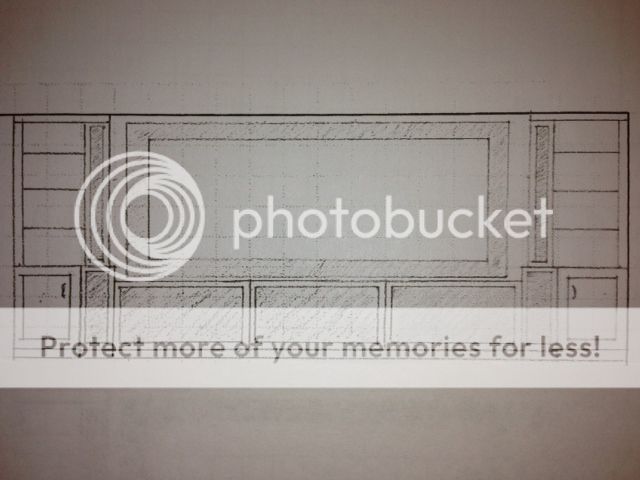

The finalized screenwall sketches that started it all...
And a couple of crude attempts at a fully enclosed room before throwing in the towel and focusing on plan #1
Fully enclosed plan #2
Fully enclosed plan #3
