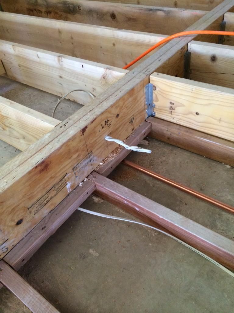

So here goes, via photo bucket , thanks for the idea....
Initial framing of the floor area

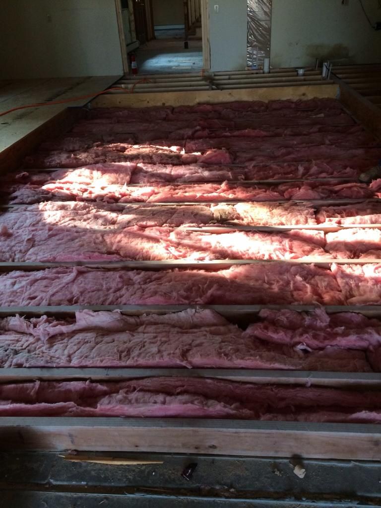

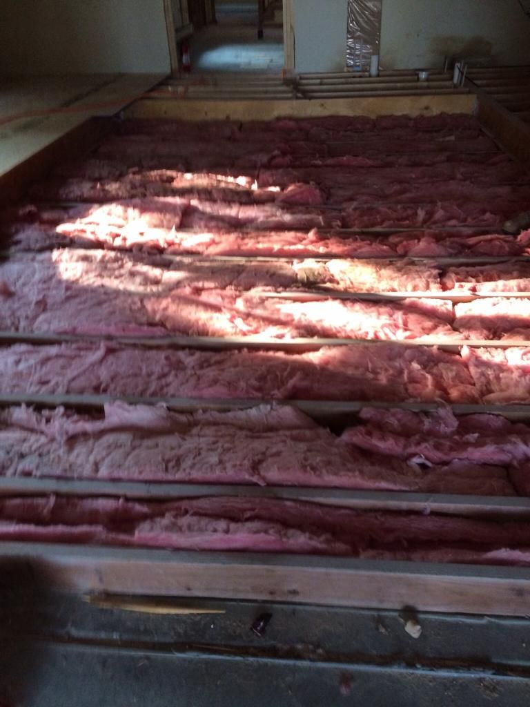

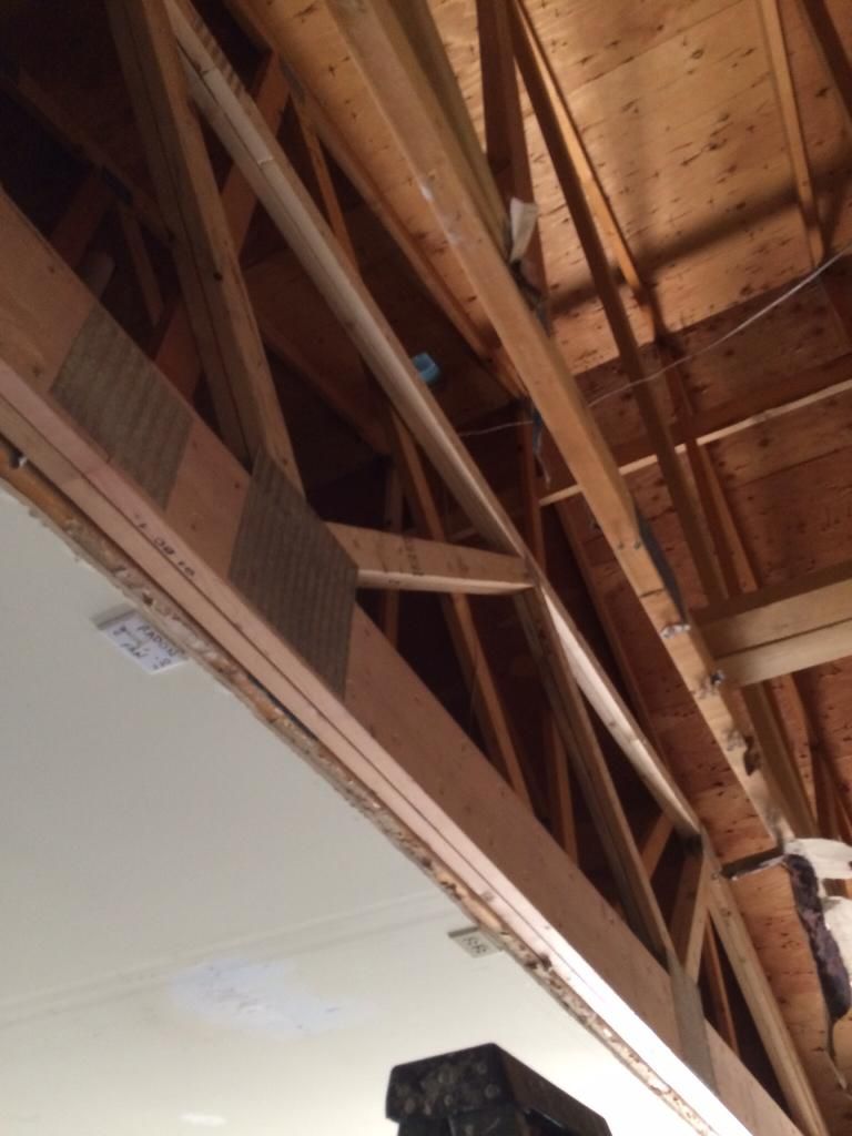

Been a slow week. I am getting small bits done in between the main remodel on the whole house. This week we managed to get the plumbing, heating and electrical rough in done.
We then put in the main support rafter for the walk-in closet upstairs. This weighed in excess of 350lbs, and was a VERY snug fit. It was installed the old fashioned way, with a pulley from the colonial days, some ropes, blood and sweat!
I then set about insulating the entire floor area with the insulation that came out of the ceiling that had been ripped out, only had to go to Lowes for a couple of more packages, it's good to recycle where possible. I even packed out the adjacent floors for the pantry, walk in and half bath....
Yukichon is offline

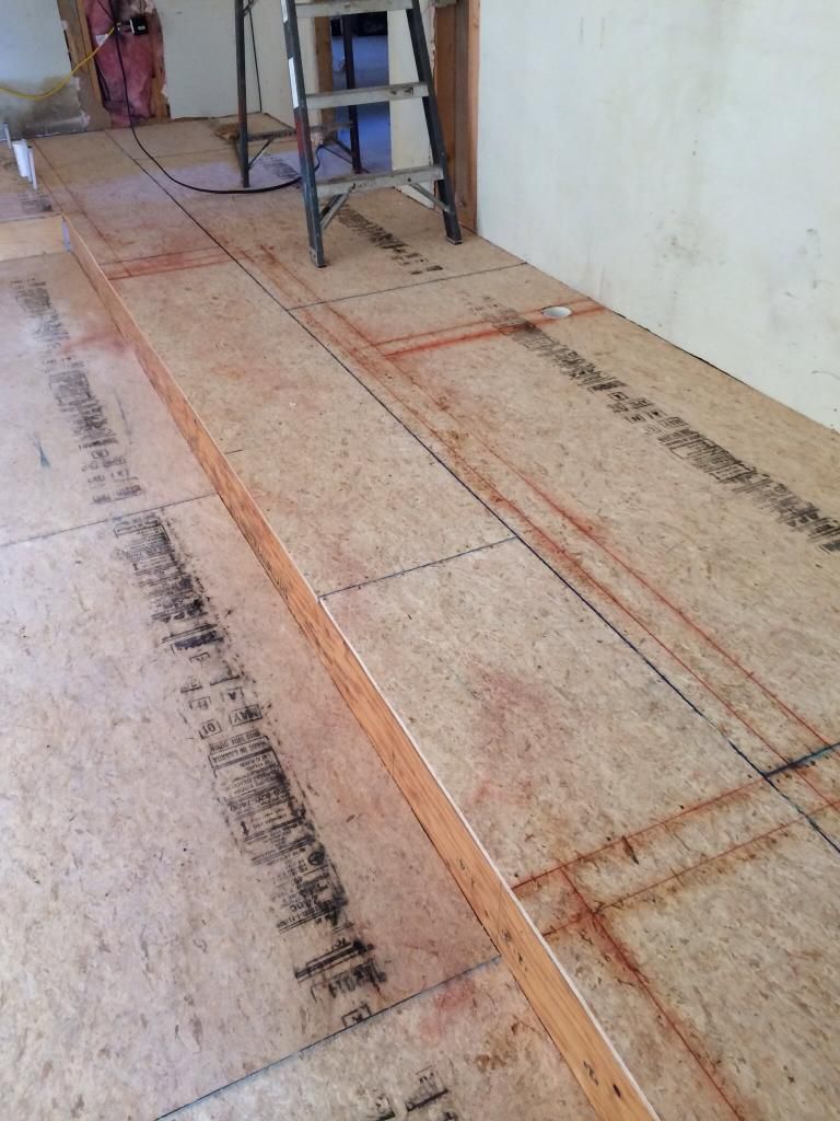

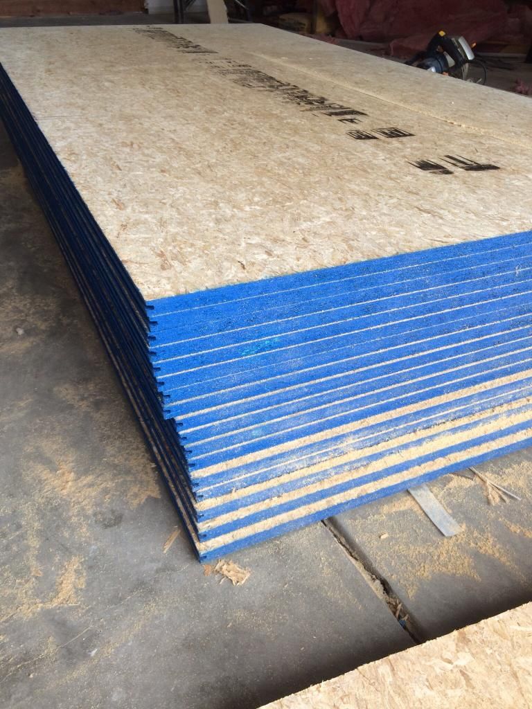

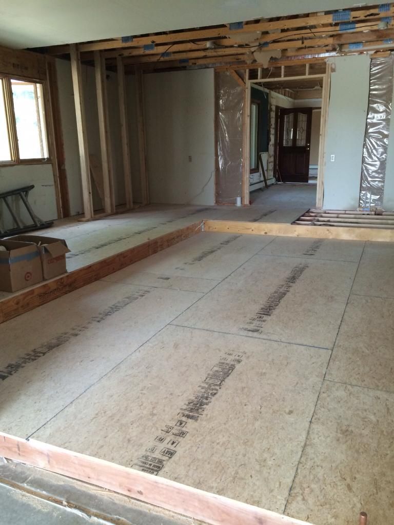

We then put in the 3/4" OSB flooring. It feels pretty solid, so do I really need to double it up?
Also, another question.....I'm probably going for the JVC RS4910U and was wondering how far back my PJ placement should be. I'm thinking of 140" 2.35:1 screen. And whilst the ceiling is open i want to make sure I have dome good securing points between the rafters.

I didn't double up the OSB on my flooring and it's solid as can be.
RE: projector placement and bracing, I'd put breaching in down the entire middle of the theater. This gives you options down the road.

Those were my sentiments, better to be safe than sorry I suppose....the floor does feel solid but it seems for soundproofing some people go two layers with GG
I used 3 sheets of 3/4 AC plywood sandwiched with green glue. Joist are 16OC rather that 24.......underneath riser is 1-1/8 plywood Serenity Mat and another 2 sheets of 3/4 AC sandwiched with green glue......
Does the floor move YES! When four sealed 18" sealed subs move air, whole room becomes a trampoline! And I love it!

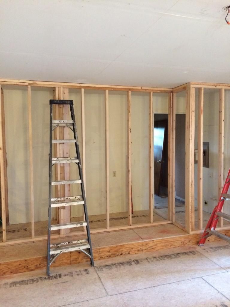

Small update......yesterday we marked out the centre for PJ placement and fitted 3/4 OSB with 2x4 supports on between the rafters all the way so we can install PJ at any point
We then started to build the false wall to house the LCR and subs behind the screen. We could only get away with 22" depth so this will lead the sub size.
Q: what height should I place the LCR's at?
