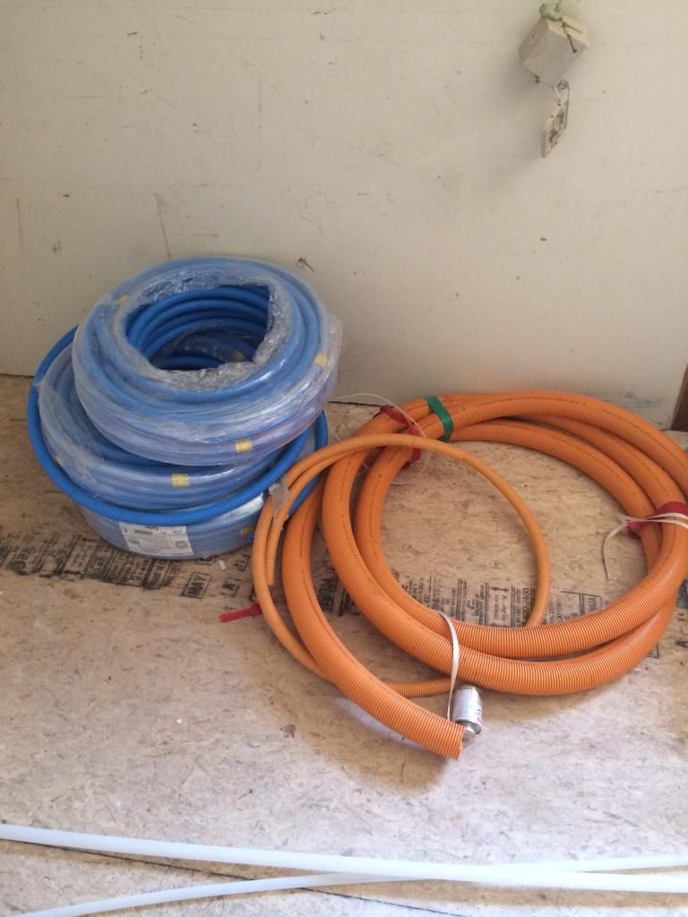

Today we started to run cables through the home. Most media related cables will be terminating in the AV Rack that isn't framed yet. Got my speaker cable delivered (monoprice 12 awg) and my sub coax, as will as the HDMI from MediaBridge....both companies provide very reasonable prices
We are running 1.5" and 2.5" tubing for all cables so that they can be swapped out easier (hopefully)

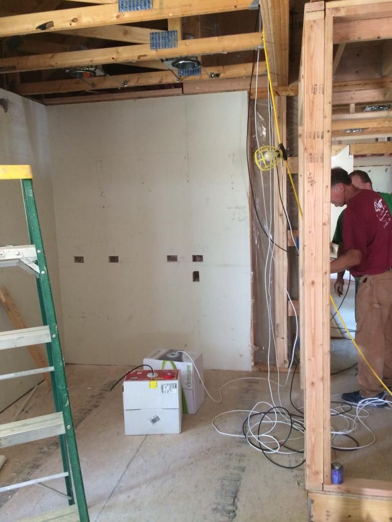

Here is a shot of the tubing running to the area behind the screen where hopefully I will have three 1099's and two stonehenge subs
....going to have to DD + GG the rear walls to help alleviate sound leakage through to the rooms that back on to it, luckily it's just a walk-in closet and a pantry
