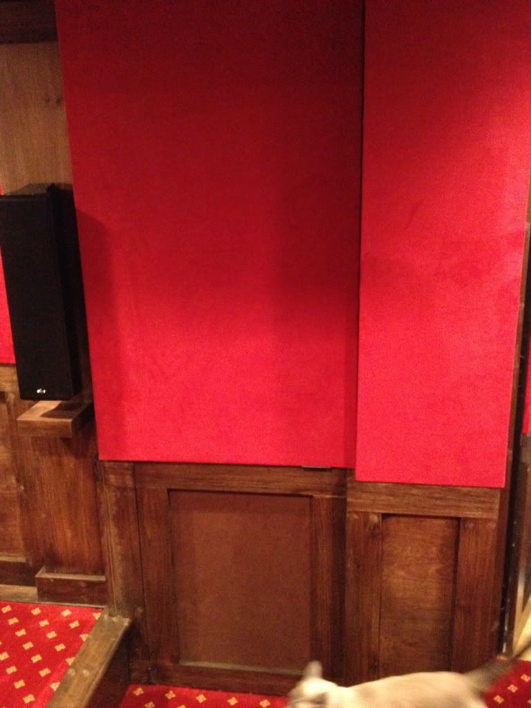

roccoleach is offline

Mine are split, I have one rack at the back of the room behind the bar with the amps etc., the servers are in another rack in the basement, the only fan noise I can hear is the projector......
Expat444 is offline
