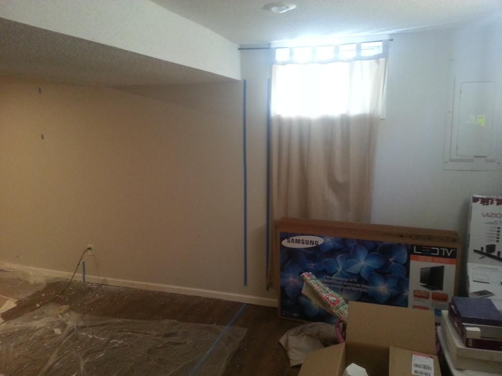

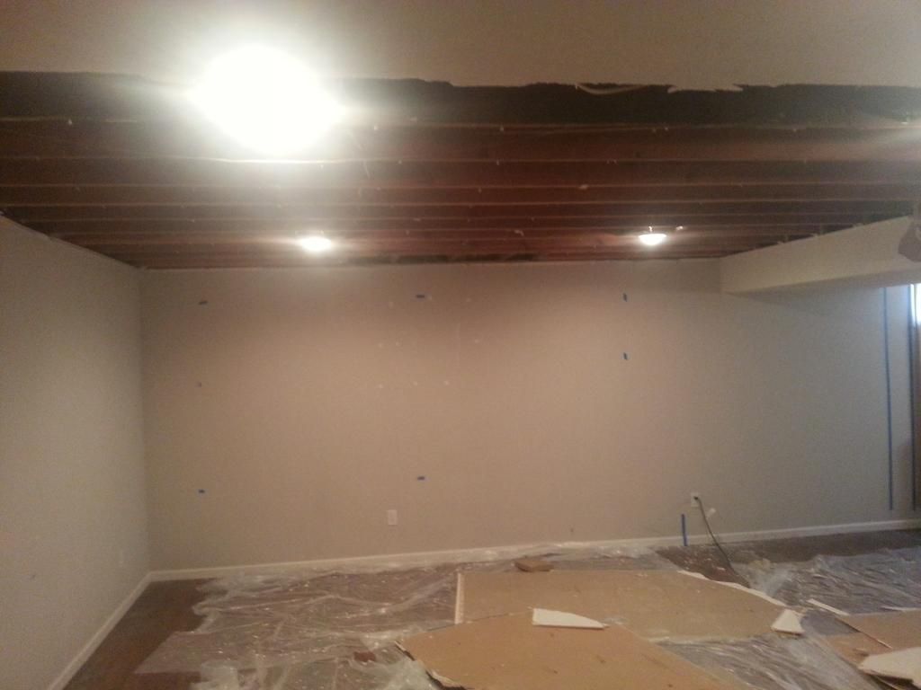

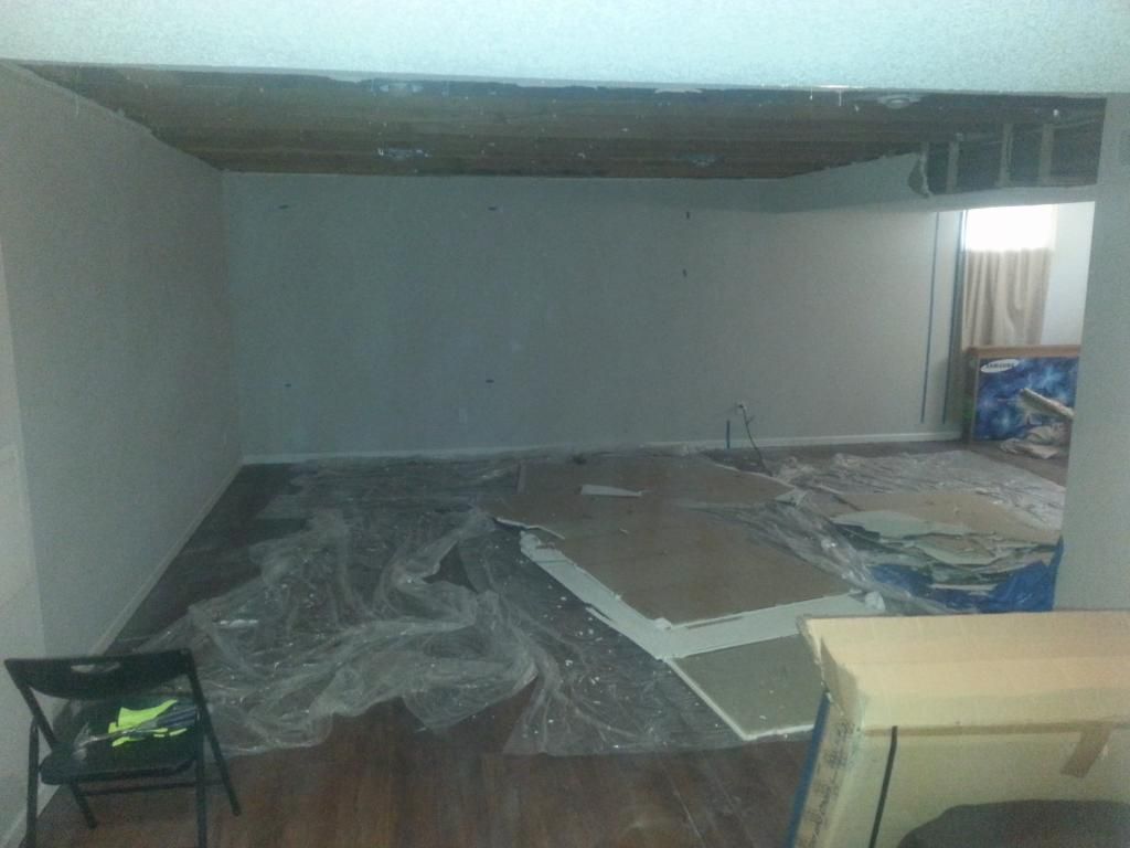

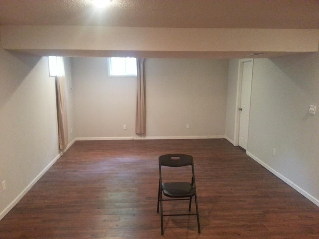

So, here are a few pics of the room I took a while back when I had my original plan to have the theater going the one direction, before the bar idea and all of that.
Of course the plan has changed since then.

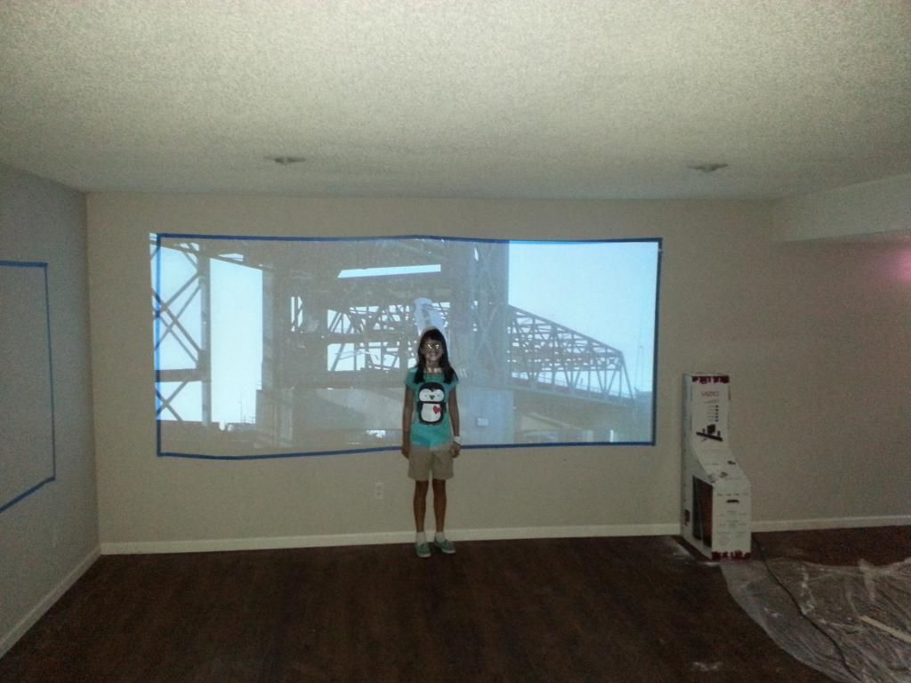

I have had my projector (Panasonic AE8000U) for about two weeks now. I finally opened it up today to try it out a bit and because I need to get going with the rebate for it. I took a picture with my girlfriend's daughter on the wall where the screen will be. The size I had taped out, poorly, on the wall (not the same wall as the picture above) is approximately 140" diagnoal, scope. So...yeah, my theater officially has one piece now. You can also see a little off to the right where I had started tearing out some of the ceiling (demo is some of the DIY I'm okay with).

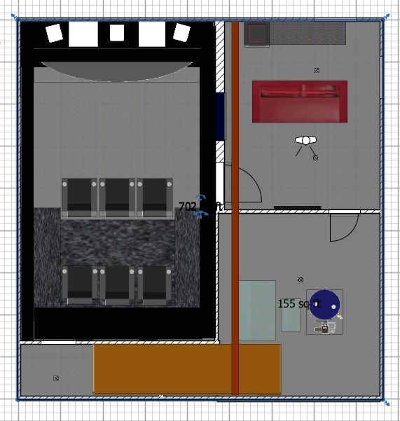

Originally Posted by ChldsPlay View Post
Okay, as I mentioned I changed the design a little bit, but there's a cost.
This is the updated layout that I'm looking at:
As you can see, there is a bar area to the right of the screen. In theory it would look a little something like this when finished:
Now, the current plan is to have a curtain pulled in front of the bar area when there is dedicated movie watching (and not an excess number of people):
This is pure brilliance! Failure to find a way to pull this off would be a tragedy and a crime against nature, not to mention home theaters everywhere!

Might be a minority of 1...
If you did the second row as bar seating, you could get a more compact seating arrangement.
And if you treated the HVAC soffit as the screen soffit, then perhaps something like this, is
a possibility.

Can't say I am a fan of off-center seating and no symmetrical reflective side walls
for the front three channels.
Maybe there's a good reason that the top of Mt Olympus isn't crowded...
And math should play a role in a home theater design.
Could we have a layout of the furnace room?
You mention packing them in, have you considered how hot and stuffy that space will become, with a
crowd in there? You will need to address creature comfort.

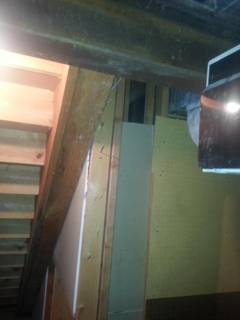

Well, I don't think I'll be packing them in very often, and even then it's not going to be a ton of people, that's why I don't mind losing the bar. Here is a layout with some of the utility room filled in:

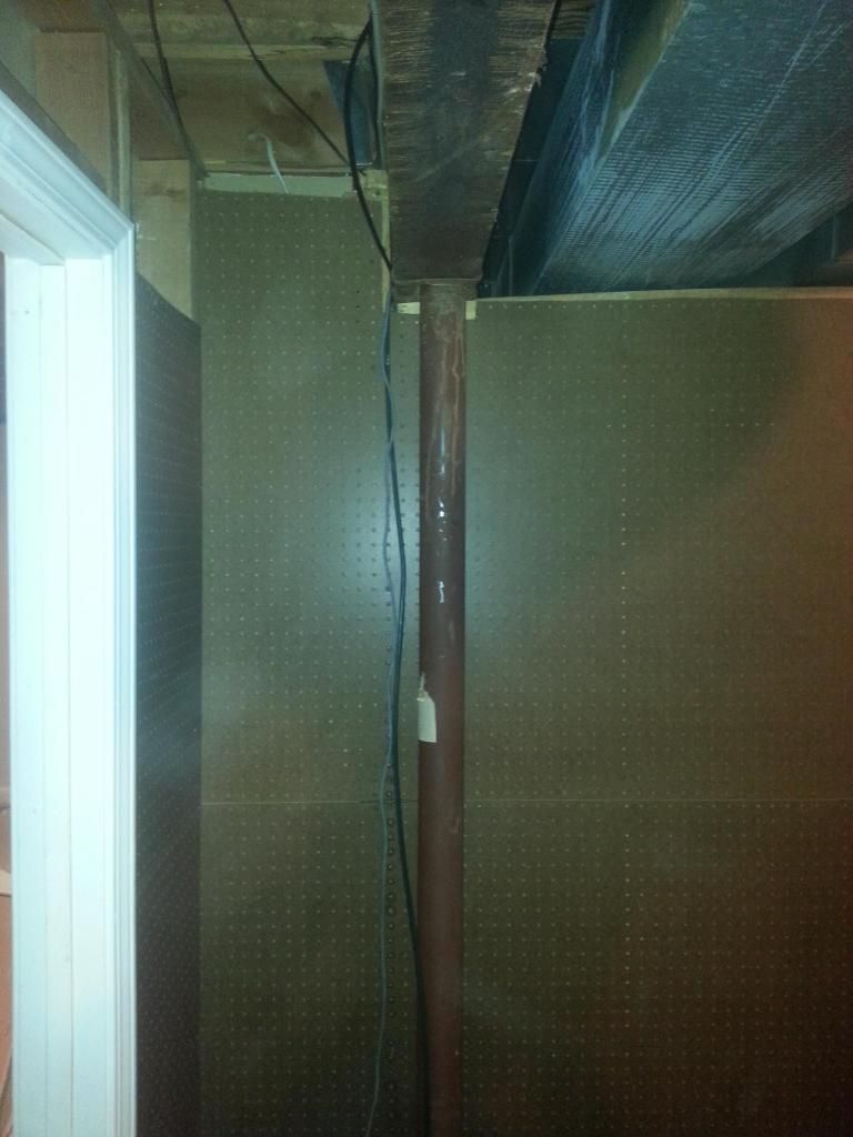

There is an I-beam that goes across that room and the one next to it. There is a support pole in the utility room next to the wall to the other room. The foundation wall has some shelving on it as well. I may be able to widen the theater room by 5 inches if I move the wall in towards the furnace. I don't think that would be worth the effort unless I did sound isolation and needed the extra room.

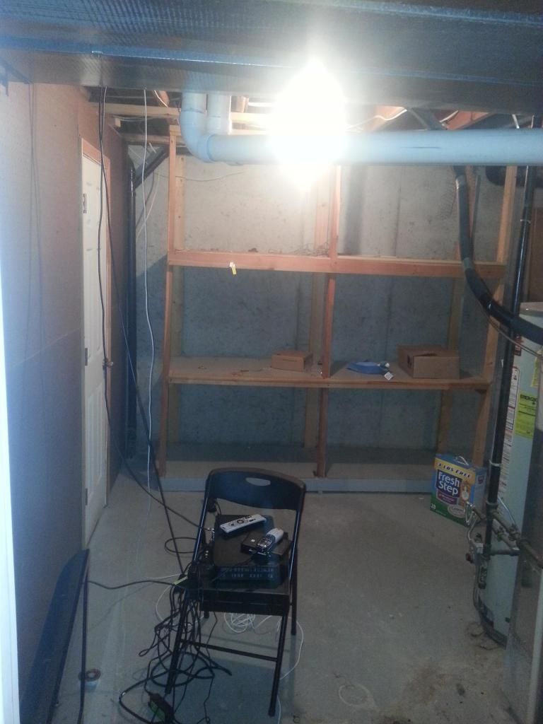

I asked about the furnace room wondering if there was room to have a shallow U shaped panel, for
a couple of flat screen hdtvs. The sliding panel could be gasketted at the ends, to keep furnace room
noise out of the theater.
And since sports are 16x9, maybe a removable bottom masking panel would allow for taller 16x9 image with
a pair of stacked flat panel hdtvs slid into the room, but still let you have a large scope image setup.
Now you put the bar outside the room, and avoid oils from the popcorn maker ruining your screen. You also put
highly reflective surfaces like those marquees outside the room. You still get the bling, but avoid the performance hit.

That's an interesting idea. My screen will only leave about 12" on either side when scope. I just checked, and I would have just about 30" per side when masked to 16:9. I know one TV would be able to work in that space, but the 2nd one I think may be too wide.

Now seeing the layout of the furnace room, I'll reiterate my suggestion to rotate the theater 90 degrees clockwise. Incorporate the beam/duct as part of a ceiling and soffit detail, move in the furnace room wall to gain width if needed. Cover the windows and make a nice screen wall.
The benefit of doing that is that you can then place your casual bar/seating area at the landing, so you don't have the stairs to contend with in terms of soundproofing or flow through the basement floorplan. Much more natural to land in an open area, with the theater closed off beyond - rather than land in the theater and move through to the casual space...
At least give that a quick scribble to see what issues it raises. Moving the furnace room wall shouldn't be a big deal, especially if you can see behind it (unfinished) now to know what's in there that could cause problems...
Jeff
I will look at it again tonight, but I do think there are some pipes and such that drop lower from the ceiling close to the wall that would have to be moved. And there is a support pole under the beam right along the wall. I'm not sure how difficult it is for any of that to be moved. My only other concern with that would be how much it would impact my available screen size with a lower soffit up front, and limiting the seating.

I took that extra 5" of width from the furnace room, for a short section of wall, on my last drawing.
So sell three tvs and buy two matching tvs... Call them a mistake and move on. You have a $40K budget.
Design right and you can start to shave costs elsewhere.
Or just do a single hdtv on the sliding panel to start with, but make the panel full height, so you have the option
of a future upgrade to a pair of hdtvs.
Oh, the 40k budget sounds high I know, but this is not going to be a DIY, so it will go bye bye very quickly. It's already going to be between 15-20k for equipment and seating. Then I have construction, installation, automation, etc. for the rest. One extra TV is fine, and if I have to, I will just drag it in when needed.
It appears I was smoking something when I went to measure my room initially. Not only was I a foot off on the one length, I was also a couple inches short on the ceiling. That means I have even less headroom now, and unless I can completely rearrange the ducting to eliminate the soffit at the back of the room, I don't see soundproofing being a real option because of the extra headroom it will eat up.

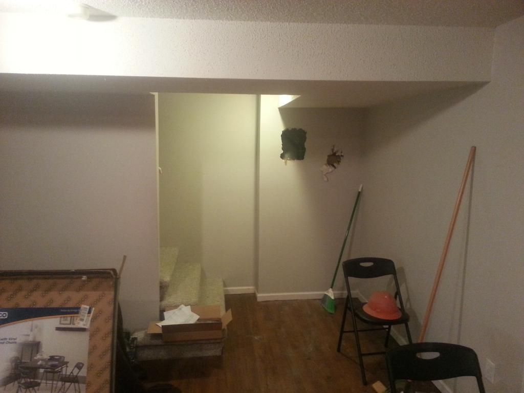

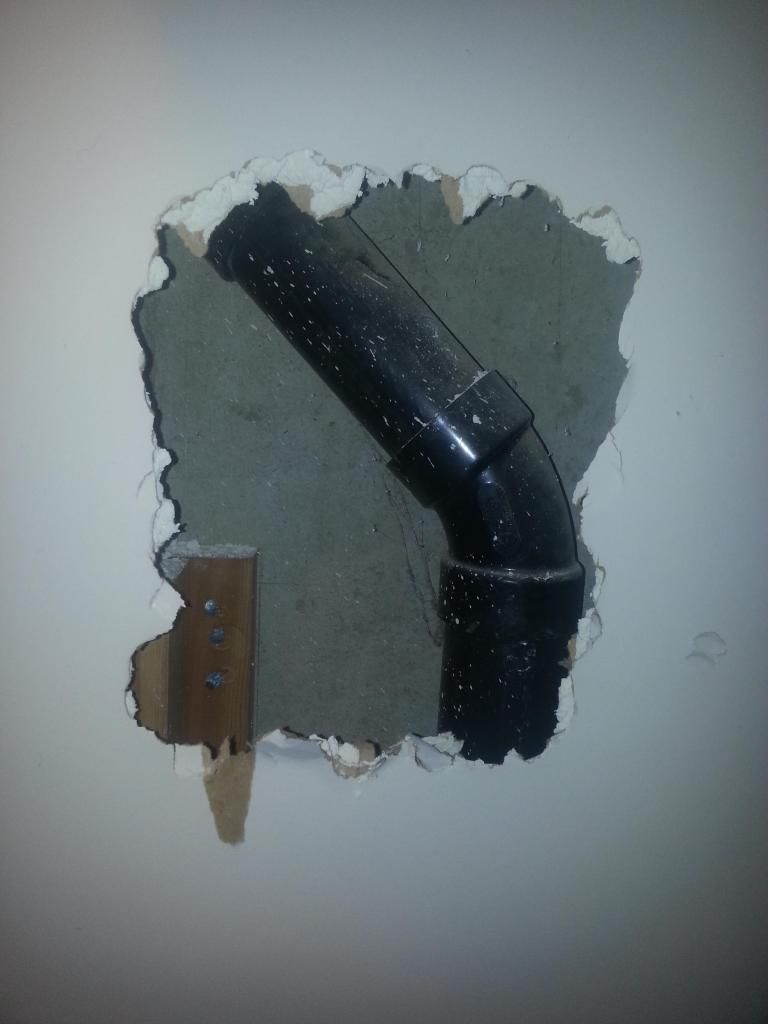

Still working things out, but I started some real demo today. Gotta make sure I know everything I'm dealing with.
This is going down the stairs to where the theater will be:
That little jut out from the wall at the bottom of the stairs has me worried, because I plan to wall off the opening and put a door in. I am not sure I can meet code with that section sticking out. I had to poke some holes to see what was back there. Not sure I can do much with this pipe. I suppose I could push the wall I build out a little, but I would hate to lose the inches Maybe leave the door off the hinges for inspection?
Started taking down more of the ceiling.
Here's a shot of where the bar area was going to be. The blue tape running up the wall (and on the floor under the tarp) is where I was going to build the wall behind the bar.
Now some shots of the utility room. I'm hoping to move some the ducting that's going into the back of the theater (seen in the first pic below) and be able to move the wall in to the beam.
Hoping things start moving forward a lot more soon.

So, I am concerned about the area under the stairs. I plan to extend the wall and put a doorway there to enter the theater. The problem is, I am worried about my ability to get anything of any size in or out of the basement. Now, ideally I wouldn't need to, but you never know. Any suggestions? Someone suggested a barn door, but I worry about acoustics, and there will be back speakers on the wall there too.
