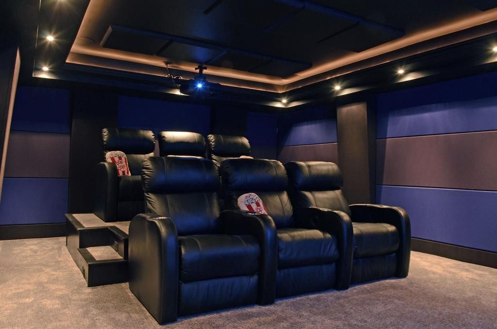

The Hodor Theater build

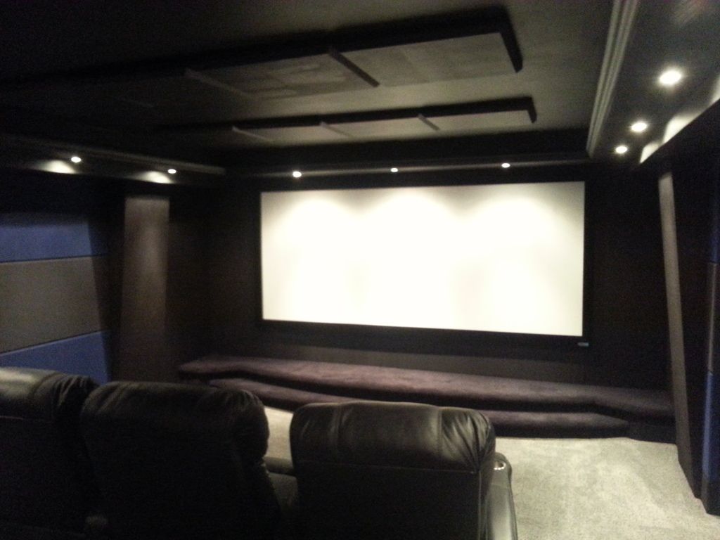

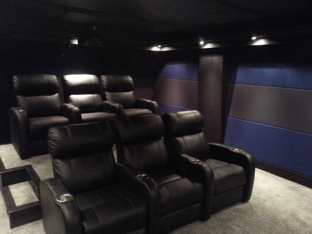

Edit 5/26/16 - Updated pictures post repairs:
Edit 5/6/16 - After a pipe burst in January caused a lot of water damage and meant the removal of all the carpet, fabric panels, and the tear-out of some drywall, the theater has been restored. I took advantage of the situation and ran some extra wiring for more ceiling speakers (previously wired for 2, now for 6). Four speakers are installed, and my receiver was upgraded so now The Hodor theater has 7.2.4 Atmos and DTS:X capabilities. Jeff Meier (umr on AVS) completed an audio calibration on 4/30/16. My long overdue first AVS get together is set for 5/21/16 with a showing of Deadpool. No new pictures for the updated theater because it looks essentially identical with the exception of 4 hard to see speaker grills in the ceiling.
Edit 6/15/15 Theater is essentially "Done" for now. Minor odds and ends to take care of and automation to be implemented. 4K and Atmos to come at a later date.
Edit (11/6/14) Layout/Treatment Plan by Acoustic Frontiers added (also attached to bottom of this post).
Edit (8/23/14) I figured I'd go ahead and make this a build thread since it's going to be happening (hopefully sooner than later). I think now that, outside of a few details, I've pretty much got the final layout figured out. Projector has been purchased, screen is figured out (exact size TBD), and starting to get a pretty good idea of ways I might go with audio. Now I just need to find someone to help me build it. I don't have much intention to make this a DIY, though I will help where I can. I'd love to do sound isolation, but I'm not sure the budget allows. Several people have said they think I should be able to with my budget ($40k for everything), but I'm not sure if that assumes a lot of DIY work or not though. Hopefully it gets off the ground soon and things can go smoothly.
Below is the original post.

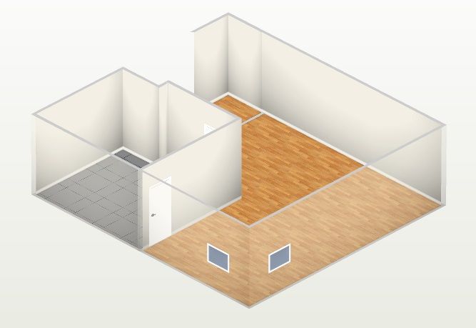

So I have a room that is L shaped currently, but I plan to build a partition so I have an enclosed space for the theater. That space is about 26' x 14'. The biggest issue is ceiling height (in the basement) which is 7'9" except for an area with ducting that drops to 6'10". This area is about 3' deep and starts about 14' from the wall the screen would be on. I would like to do 2 rows of seating, but I worry about having enough headroom for the row that would have to be raised some. Do I have enough room to get 2 rows in before getting to the lower section of the ceiling? I am looking at a 120 - 130 inch screen (2.35). I am also wanting to put in a bar behind the back row, and am worries about headroom there also. Any ideas or comments?
Also, I was considering a AT screen. I have talked to a couple places about my setup and one guy said he would suggest in wall speakers, and another said towers are always the better than in-wall. Is that true? I asked the guy who suggested in-wall and he said it depended on what kind of in-wall speakers you used and some were.
I also wondered if the L and R speakers were usually behind AT screens too, or if it was just the Centers usually? If the L and R are behind the screen, are there any issues when there is masking for 4:3 and 16:9 content? Does the masking affect the sound?
Thanks for any help.

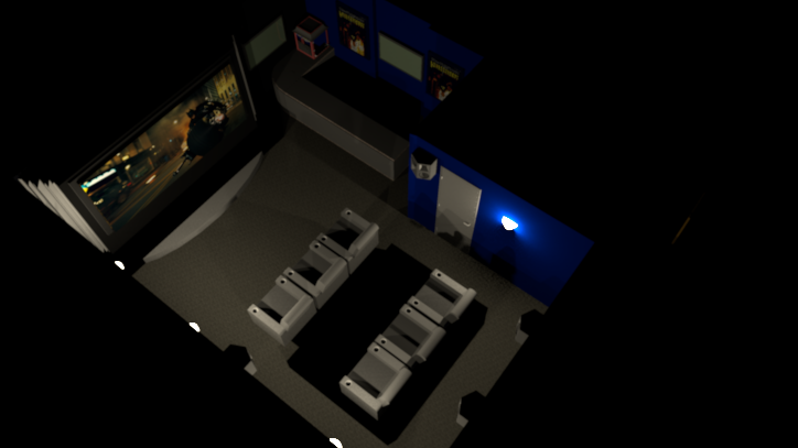

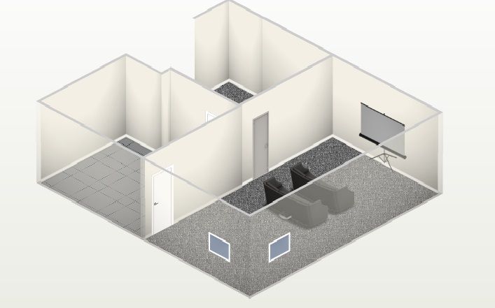

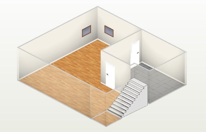

Here is the basic layout as of right now. The small room is where the water heater and all that is.
This is kind of how I was thinking, with the additional wall. Sorry for the rather poor layouts, but that's just what I could do quickly online.
The area with the ducts is just behind where I have the seats, coming from the utility room across to the outer wall.
With 235 screens it's normal for all three to be behind the screen, but doesn't have to be. Masking should be acoustically transparent as well, but I would try to avoid having both a screen and a mask in front of a speaker.
If speakers are typically behind a 2.35 screen, doesn't that make it difficult to avoid them being behind the masking as well?
Also, I wasn't thinking the second level of stadium seating would be on a full height riser, but something smaller like 4-6".

There's a good bit of user preference in seating distance, but generally the sweet spot for 235 is around 1 screen width back. That works pretty well with most scenarios: a screen about 10 feet wide - because you don't normally want to sit closer than that with an AT screen, so that you don't see the weave in the fabric or the holes (perforations) that make it acoustically transparent. So if the first row of seats puts eyeballs at 10' from the screen, and the screen is a foot or more from the wall, the second row doesn't fit in front of the low part of the ceiling. The rows can be pretty close together if you don't use recliners - I don't know exactly how close, maybe 3'? Probably 4'. Get some chairs down there and lay it out - see what's acceptable to you. If you want recliners, expect a minimum of 6' for each row ( seat back to seat back) 6.5 is much better.
It is hard sometimes to get all the speakers from behind masking. Most people don't mask all the way down to 4:3. If you are going to, I'd recommend putting L and R outside the screen entirely.
A short riser works, but it forces the screen higher in order to maintain unobstructed sight lines. That's going to make the screen smaller, most likely.
There's a lot to balance.

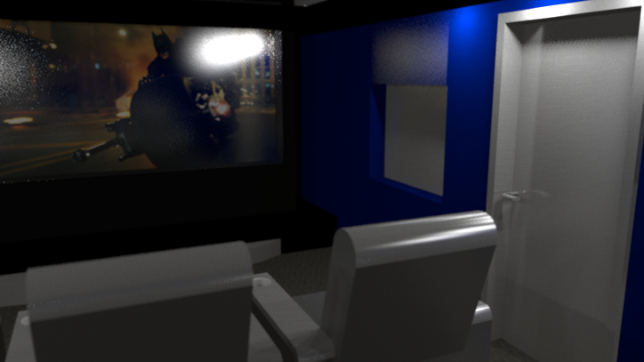

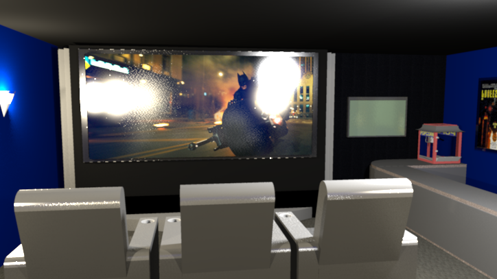

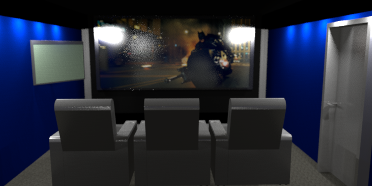

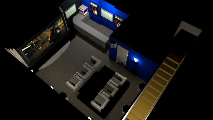

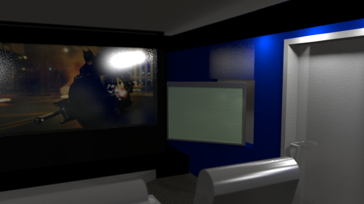

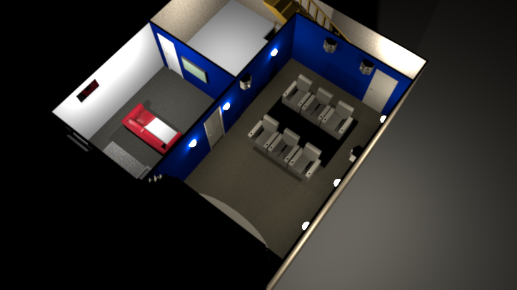

Okay, as I mentioned I changed the design a little bit, but there's a cost.
This is the updated layout that I'm looking at:
As you can see, there is a bar area to the right of the screen. In theory it would look a little something like this when finished:
Now, the current plan is to have a curtain pulled in front of the bar area when there is dedicated movie watching (and not an excess number of people):
Now I like the concept of all of this, especially the extra TVs by the bar for football season, however my biggest worry with the design is the acoustics. I don't like not having symmetry at the front area, and I worry about the impact on the reflections. Does anyone have any ideas on what I might be able to do to either improve the acoustics of the room, or to keep one of the extra TVs should I decide to eliminate the bar and wall off that area (basically I'd bring forward the wall that's behind the bar in the layout so that it's flush with the other wall making a rectangle? My other concern is with the false wall, if I've brought the screen too far forward (It would put front row seating at 10-11 ft.).
ChldsPlay is offline

Your current design will not work well at all for acoustics. There really isn't anything you could do to improve upon that.

That's what I was thinking. But how much of a difference will it make? I've never had a dedicated theater, and all previous home theaters were definitely not in spaces that were ideal acoustically either.
Is there any way to still have an extra TV in there somewhere if it is walled off where the curtain would be? I'm not so concerned with the bar as with having an extra screen during football season.

The difference will be quite significant. The question would be, why do you need an extra screen in a room that is a DEDICATED theater? You can always consider a split of the video signal on one screen if you must have it in the room.

Well, I do plan to watch football in there too, and I always have multiple screens when I watch football. I suppose I could always just drag a TV in there on Sunday afternoons.
Then I could make it something like this:

Why close off the 2nd area? Is that leftover space the mechanical room? I'd make that area your bar with seating and one or more TV's... Keep the theater for movies and for "serious" game-watching, but have your bar area for more casual viewing. But I'd rotate the plan 90 degrees. You don't want to have to come through the theater to get to the rest of the basement. Have the bar / casual space at the bottom of the stairs, the theater on the other side.
Jeff
ellisr63 likes this.
jautor is online now
post #24 of 384 Old 08-20-2014, 11:32 PM - Thread Starter
ChldsPlay's Avatar
Location: Olathe, KS
Posts: 1,372
Mentioned: 31 Post(s)
Quoted: 609 Post(s)
Liked: 317
Jeff
Yeah, the empty room is the mechanical room, and where the equipment will go. Flipping 90 degrees isn't as good of a space for the theater because of ducting and beam. That was the original plan, but was scrapped because of that.

Okay, so I've pretty much decided to wall off that side and forego the curtain and bar. I will use that room as a snack room with my popcorn machine and fridge, and sort of a spillover for when there are a lot of guests over. I'll throw in my old sofas (if both fit) from my old house and setup a TV so that kids can watch whatever they watch and maybe play on the Wii. I hate not having an extra screen for football, but I can drag one in there on Sundays if need be. Though, I want to ask about having a TV mounted to the side wall (possibly in a recessed area built for the TV). If the mount had an arm on it so it could be pulled out and turned towards the seating, that would work. When not in use, it could be covered somehow, perhaps with an acoustic panel of some kind? Would that work acoustically, or still cause problems?
Sort of like this:
but probably on the other wall that is to be built.

I had considered a track, but I think that's a little more than what I'd need, or want to do. I don't want to block the projector screen. What I was thinking about with hiding in the wall would be like this:

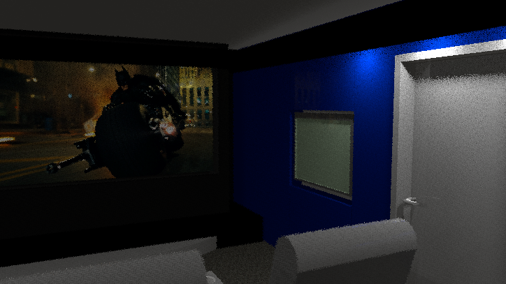

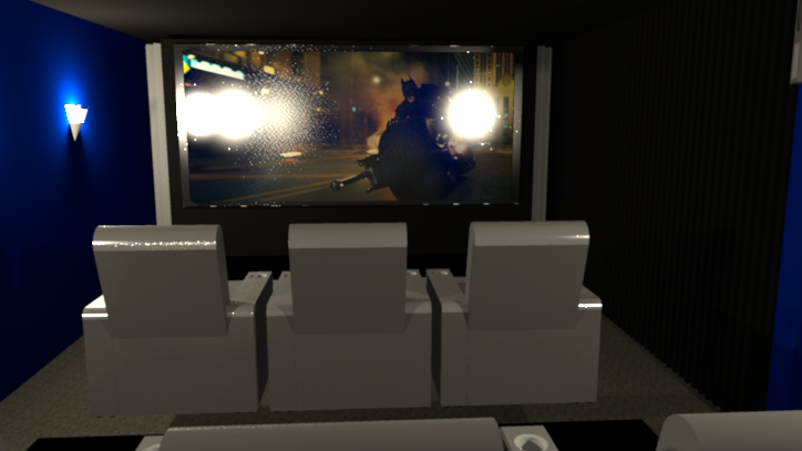

Build a recessed area into the wall that will be constructed:
Mount the TV in the recessed area (pull out mount).
Pull out the TV for football (or whatever):
When not in use, return TV to flush position and cover with acoustic panel:
I have no idea if that would really work or what kind of impact it would have acoustically, but it's an idea that floated into my head.
post #30 of 384 Old 08-22-2014, 03:04 PM
damelon's Avatar
Location: Woodbridge, VA
Posts: 2,146
Liked: 269
I would think this isn't bad, except you don't need the wall where the TV is. You sound like you are big into fantasy if you want multiple screens going. Some projectors and such will do split screen too but you're better off going with just a single screen, and if you really need to glance at a second game, use a laptop with a streaming device (Internet service, slingbox, etc) Which will meet your goals and really cost you nothing. (no construction needed!) You can put another TV outside of the room with a bar if you really want, make that whole side space one open area, maybe with a bar, a tv, poker table, or something. A "Lounge".
Two walled off rooms like a theater & mini theater, both of which being sort of single-use dedicated spaces, is a waste of space imo.
damelon is online now
