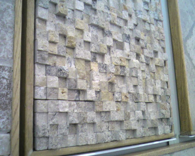

Originally Posted by price3 View Post
Has anyone ever used stone as a diffusing medium? I have some left over from a fireplace and could use it in a strip on my rear wall if it would be beneficial. This is the only pic I could find:
Also, if making soffit bass traps, with 1/2" sheetrock covering loose insulation should I cut vents in or leave it sealed?
Originally Posted by nathan_h View Post
Stone would be better than a flat wall, but to be predictably effective would need to have bigger peaks and valleys than in that photo. That looks like a visual flourish but not an effective sound treatment.
You want something much thinner than half inch Sheetrock covering a bass trap. Examples: fabric, foil, paper. If you look at some of the build threads here you'll see some creative solutions. Example, one whole side is left unsheetrocked and is covered with fabric.
Originally Posted by Ethan Winer View Post
That won't work very well for various reasons, mostly because there's not enough depth. More here:
All About Diffusion
A soffit as you describe will not work as a bass trap because sheet rock is too dense to let bass waves pass through to the insulation inside. You need to make a wood frame, then stretch fabric (or staple cardboard) to the frame.
--Ethan
Kinda related, while doing tile work in my basement I saw these in the store and they reminded me of the diffusers I was reading about while doing some of my acoustic research 1+ year ago.
Yea, they look like them somewhat but depth is too shallow and I'm sure their pattern does not follow some 7th order function...
Wonder how heavy they'd be if built "properly".....100's lbs?
Since I'm in a log home I was looking for some more natural/organic material for diffusors than the metal/plastic ones I've come across.
Some of those commercial wood ones are really neat looking, and with science behind them.
The DIY wood ones seem like lots of work....(this is from a 3 year old thread with Ethan also in it, http://recording.org/studio-construc...mparisons.html)
