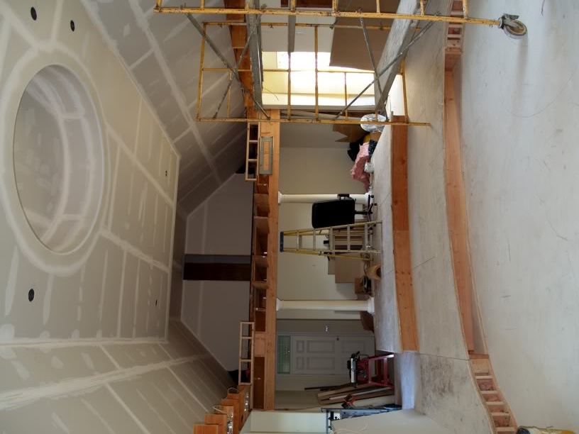

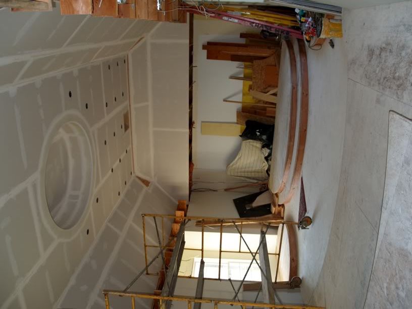

post #16 of 615 Old 08-26-2005, 10:03 PM - Thread Starter
Mark P's Avatar
Location: Dallas OR
Posts: 1,927
Liked: 30
Had a friend tackle my sheetrocking because what took him and his crew 1 day would have takin me a week ( maybe more due to sheetrock burnout)
Pros are amazing 8 hours sheetrocked and fire taped.
Makes me feel pretty lame taking a month to raise the ceiling , frame/seal off IB subwoofer ( front 1/3 of room), stages, risers , balcony , and equiptment room, re-frame chandelier hole 6' diameter
Mark P is offline

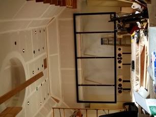

post #25 of 615 Old 09-10-2005, 06:02 AM - Thread Starter
Mark P's Avatar
Location: Dallas OR
Posts: 1,927
Liked: 30
Originally Posted by Jason Turk View Post
Man I love to see my customers rooms come together. Excellent job Mark. I can't wait to see it when the screen goes in.
Ask and you shall receive, the Frame has been up all week, Im thinking of putting the screen in and watching some football and movies this weekend.
I just dont know if I want to put it up because it has to come back down, regardless Ill add some pics of atleast the frame tonight because its an impressive beast for sure.
Had a friend come over to help me hang the frame and when we were done he says " and on the 8th day God created Frame, I think I am going to weep its so beautiful"
I think we sat around for a half hour in amazement
Mark P is offline

Columns are fiberglass, $150 a piece 13000 lb capacity, weigh about 20lbs
heres a couple pics of screen frame and screen, my son is in the one pic ( he's 5'11" for reference, not great pics but I was trying to hurry since its movie night and I have a football game to watch in 2 hours.
Ill try and post some screen shots tonight
