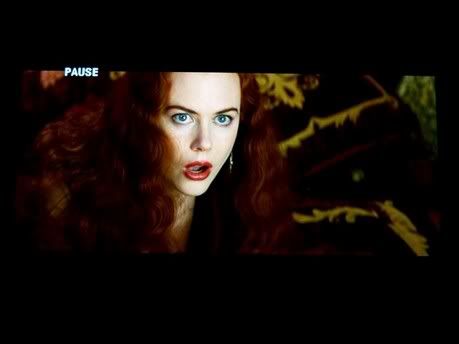

if that is a true comparison, that will show everyone what a good screen will do for the image.
In a way its not an absolutely fair comparison because the first image was before the anamorphic lens arrived and if you look hard you can see black bars ever so slightly on the wall, the other one if I recall correctly was taking up the entire 14' wide screen. This puts the advantage to the painted wall ( it was probably 11 ft. wide-ish, maybe 12' )
Same DVD player, same camera , same auto settings ( Im not smart enough to shoot anything but auto and have it work properly) My jaw dropped the first time I saw the image on the screen, even on old grainy movies like The Good,the Bad and the Ugly the close ups of Eli Wallach and bunch just blow you away.
If I were Ruben I would try very hard to find someone local to test the images on Fabric and a Stewart or other slightly higer priced screen before commiting.
We can barely see a difference between econo and normal bulb brightness but the PJ it self is quiet and cool in econo, its still quiet in normal but the heat intensifies quite a bit. My guess is econo mode is out for sure on a fabric screen, the samples we got were very dim when compared but they were awful small samples

Originally Posted by ebr View Post
Give it up -- where did you get the $40 fabric that kicks CCCs butt...??
On the size - given everything else you've done, you should probably go for the constant height 2.35:1. It will cost more (need a lens) but not that much relative to everything else you've done.
That Fabric I threw up there was clearer than the CCC but not as transparent. I only threw that up for deciding on Size and Ratio. It was definitly clearer but blocked more sound. I have no idea what the material is either, It may be on the receipt somewhere.
I bought at a Fabric Store.
Ruben

Originally Posted by Mark P View Post
That would be decided with ease as soon as you figure out what it is that will be projected the most and/or If you want black bars when watching 2.35:1 robbing you of 33% of your resolution. If you watch alot of TV , hardly any movies go 16 x 9 , If your going to watch alot of movies and little TV then the choice is obvious.
Do you want HDTV big and movies considerably smaller with 33% loss on resolution
or
Do you want movies big and HDTV considerably smaller with no loss of resolution
If your not having the screen covered by curtains than 2.35:1 would be a must for the visual impact of walking into an actual theater, to me 16 x 9 just looks to close to a TV screen. Once we hung the screen we really tossed the idea of no curtains around for several days just because of the impact of the Stewart Screen when you walk into the room, it is the whitest white I have ever seen and with proper lighting it really drops your jaw when walking into the room.
take those pics you made where you masked off the screen sizes and fill them with white or crop a favorite movie and do it sort of like this
As far as using cloth as a screen, I would SERIOUSLY reconsider a gain screen, when we were waiting for the screen we went out and bought the whitest white paints we could find and heres the image
We thought it was amazing and started to wonder if we wasted money, and heres after the screen
I am just wondering what fabric , vinyl coated or not is going to give you the best picture possible and I just cant see it. Everything we saw was not worth moving the center speaker down right below the screen but again I have external crossovers and tweek the sound any way we choose.
Good luck , my vote is the biggest 2.35:1 you can go for and not see screendoor ( which is probably 1.25 screen width back, not familiar with your PJ so I dont know for sure) and the center speaker below, do audio testing right now and see if you can tell the difference using your fabric. put it behind, then move it below. We did all this before the PJ and screen ever showed up. In my opinion it would be a major shame to spend the time making such a beautiful room to shock and awe everyone that comes in and then turn the lights off and have the next 2 hours look half as good as it could.
Let me know when youve read this and I will edit out all my pics as to not clutter up your wonderful thread
Could you explain to me how I will be losing 33% resolution by not having a 2.35:1 Screen? This is fairly new to me.
As you know I have compared every perforated Screen material from Stewart, Da-Lite, VuTec, Screen Research & Dazian to my painted wall and the Color differences side by side were not that dramatic like your pictures. It looks llike the white balance in your camera was set differently at the times you took those pictures. I can take pictures and hit the white balance button by mistake and get the same differences. So you may want to look into that. I do it all the time on my camera.
The material I am experimenting with is Vinyl Micro weave material (that's not the material hanging in the pictures I took). I found the same exact weaves VuTec is using on their weaved screens. I even found the same weave Screen Research is using for ClearPix 2, but I need to find out on Monday if it comes in white and grey like all the other weaves I found did.
Upon further comparison's with the Stewart MicroTek Perf, the perfs add an overall graininess to the image. Whereas the weave material seems to maintain the clearity and have better accoustic values than the Stewart microperf.
The open weave and micro weave vinyl material I'm getting runs $12 a yard and comes in 62" and 72" widths and any lenght. Imagine finding a Material that proves just as good if not better than Vutec and Screen Research for $12 a yard? I will be able to do my Screen for under $100.00 and be able to help all the DIY's out at thge same time.
As far as curtains, that was my intentional plans. But after seeing the real cool 2.35:1 rooms on AVS I think I may use my $550 curtain track for Masking now
Ruben
I know youre not seeing much of a difference between your painted wall and the fabrics and this is what I was trying to point out, get a sample of Stewart Studiotek 130 ( no microperf) and add that to the mix and see what happens to the colors and contrast.
I was seeing very little difference between Painted and Fabrics, the problem is that if sound can pass through so does light, even light of different colors. Hold up your samples and turn the PJ on and look at how the picture passes right through the fabric onto the wall behind, this is why you will also need blackout cloth .
All that color and light should be on your screen.
I cant hit the white balance button without being a contoursionist. this is the difference between paint and a Stewart Studiotek 130.
I cant believe the folks who have tried the audio screens and the gain screens are not chiming in here, come on guys chime in on what you found in the dimness and color differences. Art Sonneborn where are you?
Mark P is offline

Thanks Mark,
I have the whole Stewart Line up of Samples. I got a bg kit from Stewart. I posted screen Shots of all the Samples side by Side including the wall and a white piece of paper about 150 pages back in this thread
I sat down with multiple friends for countless hours with about 20+ Different Screen Samples (perforated and Non) and the Difference we seen between the Perf and non perf is the loss of brightness due to the Perfs along with Moire in my case.
For the higher gain screens we saw a more glowing brighter screen (which I did not care for). For the Grey Screens we saw Higher contrast/darker blacks. The Solid Screens were pretty equivelent to the white paper and painted wall. The Microperf 130 was pretty close to the Studiotek 130 except a loss of brightness and a grainier looking image. But as far as the 2 pictures you posted, nothing has been that different. Maybe that paint you used was real funky? My painted walls are a Bone white Flat paint.
The reason I took all the Pictures of screen shots was because I thought no one would believe me that the wall was pretty damn good considering.
Here is the Post I did of the Screen shots with Stewarts StudioTek 130 and various others including Da-Lite and white paper and the Wall. If You see a dramatic difference (besides gains) like what you posted, Please point it out to me and I will go to the Doctors first thing Monday Morning and get my eyes checked
