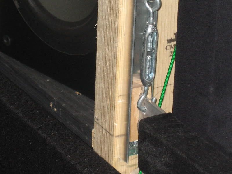

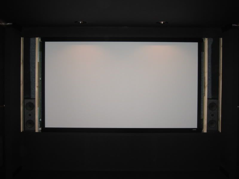

Here are a couple more pictures. The motor didn't show up tonight so I will have to automate this thing tomorrow evening.
Close up of the track that the bottom mask travels in. I created a cavity in the wooden block for the aluminum bar to slide into. This thing works great.

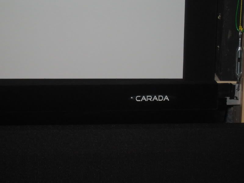

I was able to gently peel the Carada emblem off of the original screen frame and attach it to the new bottom mask.
and finally - I was able to wrap and attach 6 panels tonight. I just have the side speaker panels to complete tomorrow evening and add the automation/motor and I am done!
I have to say that I am very pleased so far with the results and the new false wall. I think if I ever build another one...I have even more ways that I could improve this design - but that is for false wall 3.0.

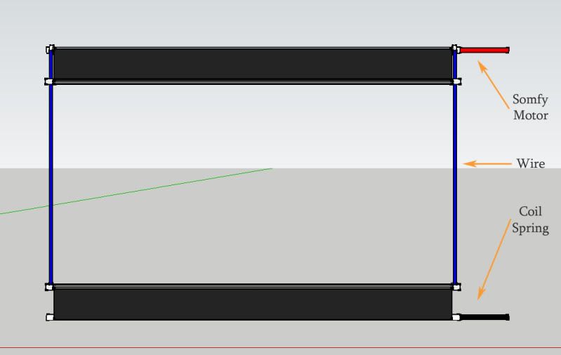

So here is the latest direction I am going in with the masking system. I bought this coil spring to go in the bottom tube to help roll the bottom mask back on the bottom tube when the masks are moving to the open position.
Here is my latest render of the current direction I am going with the mask system this weekend. I also have a backup design in the event that this does not work...
The motor and spring will be inserted into the top and bottom tube but I am showing them outside of the tube for reference.
As the motor turns the top tube to deploy the top mask - it will pull the bottom mask up. This will build tension on the coil spring. Once the mask moves in the opposite direction - the coil spring (now under tension) will pull the bottom mask material back around the bottom tube.
Note: The pulleys I originally installed on the top tube are useless. I am only using them now to prevent the wire from going to the edge of the pipe.
jikkjack is offline

That first sketch is basicly the way Carada do it with there Horizontal Masqurade But without the middle Roller,You just attach the ribbon to the top roller so it is on the back of the roller, opposite of the velvet that unrolls from the front of the roller..
So when the top masking goes down the ribbon rolls up thus pulls up the bottom masking "Straight edge" or rod that the ribbon is directly attached to: Note the ribbon is not attached to the bottom masking roller only the Bar/straight edge that the bottom masking fabric is attached to...
The top masking has no ribbon attached to the Straite edge, it just slides smoothly down the 2 (tefflon aided) side guides thanks to gravity...
Although I am sure they use the Somfy Sonesse 50(ir) motor...
Here is A quick sketch up to give you an Idea of what I mean..
Cheers...

Masking update: Minor setback on the masking system this weekend. I got the wrong remote but the right one is on the way and I should be under way soon. I am going to add the spring to the bottom roller today and of course watch a lot of football.
jikkjack is offline
post #748 of 855 Old 10-20-2009, 08:53 PM - Thread Starter
jikkjack's Avatar
Location: GA
Posts: 1,017
Masking Is A Huge Success!!!!!!!!
Open:
Closed:
And Video... I took this with my crappy digital camera so it is louder than it is in person.
Also note that since my theater lights are on full there is a shadow being cast by the top mask over the screen. This is not the case when the lights are out.
jikkjack is offline

Absolutely Awesome Job on the Horizontal masking Jason That Video says it ALL!!..
Just wondering Jase, Did you use the Guides at the Side like in my Sketch-up ?, so the Masking tracks straight and close to the Screen ...
Cheers mate....
