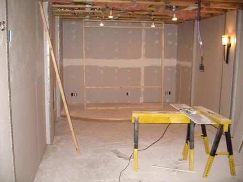

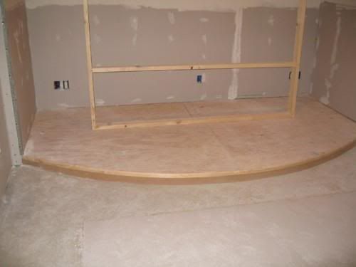

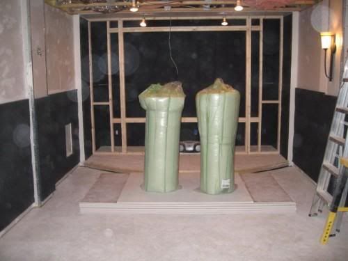

My home theater is 28' long by 12' wide. I wish I had 2 more feet for the width but oh well. I lost a lot of my before pictures due to a hard drive crash but I have some that will give you an idea of the room before. One thing to note is that behind my stage I have a concrete wall that is 8 feet high and spans the entire wall. This should work out very well for sub placement.
Ok, more pictures:

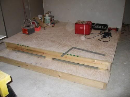

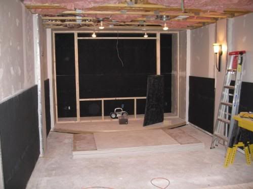

Here is a shot of the stage filled with 1250 pounds of sand and the back wall drywalled:
You can't see it from the picture but I have a 3/4 inch pink insulation sheild all the way around the sides and back of the stage.

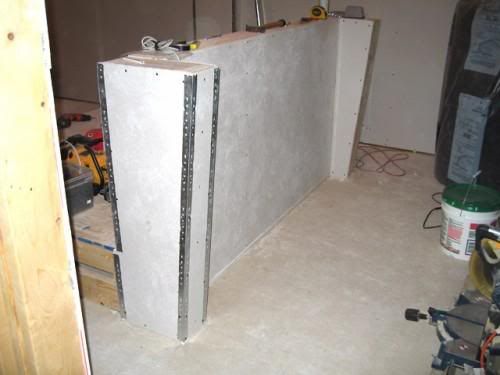

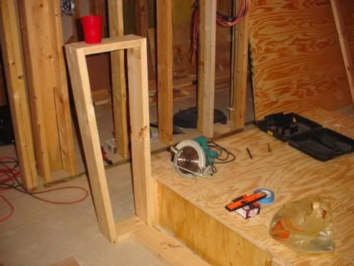

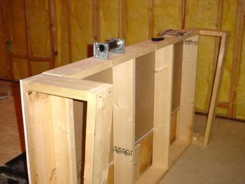

Here is a picture of the back of my riser with the begining of the bar attachment:
and another:

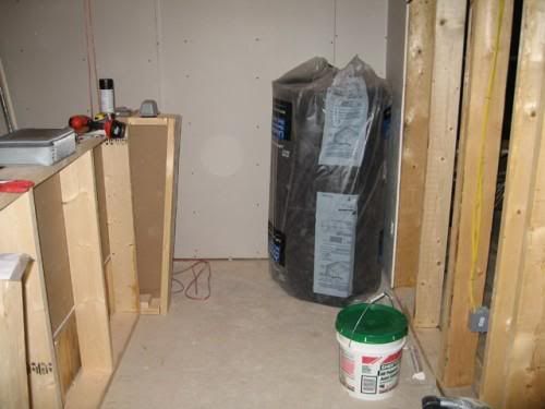

Another picture of the snack bar:

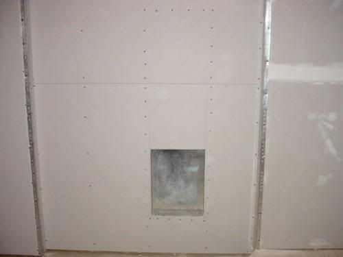

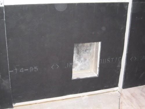

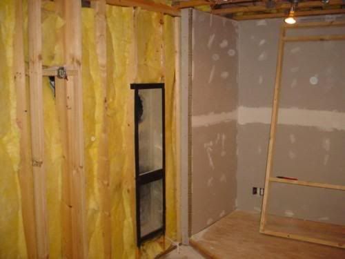

Here is a shot of the covered HVAC return with lots of screws and fastened against a double layer of HVAC foam tape.

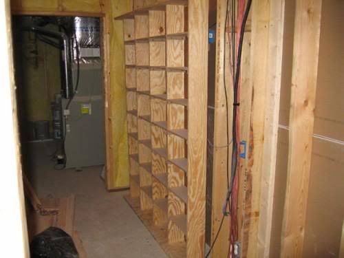

I decided to build my own DVD/XBOX bookcase. While it is not fully trimed out and routed, here is a picture of it currently:

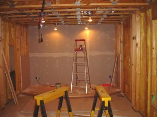

Close-up of the stage. I really like the way this turned out.
Here is a picture looking back from the stage to the riser. The speaker wires on the left hanging down by the column are to go outside to our deck.

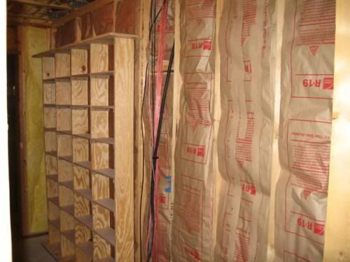

Here is a close-up image of the riser. It will be filled with insulation blown in from the front and sides between the gap in the 2x6's. The riser is 15 inches high and will be home for 3 Black Berkline 088's. Another set of 3 Berklines will be about a foot and a half in front of the riser step.
Here is a picture of the media rack with insulation installed behind it.

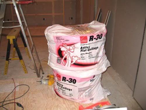

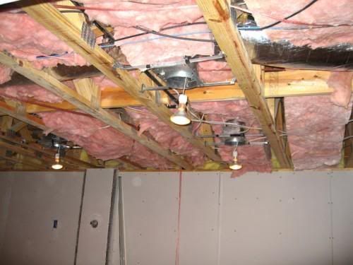

Picture of the Linacoustic. That is a big roll.
And Lots of R30 for the ceiling.

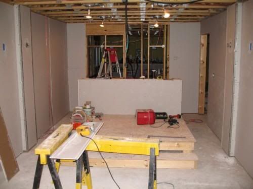

Finishing up the snack bar
Picture of first layer of r-30 in between my ceiling joist.

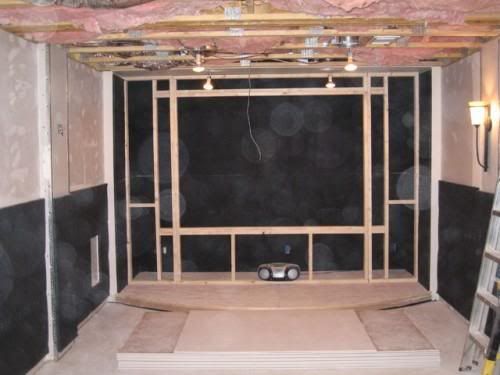

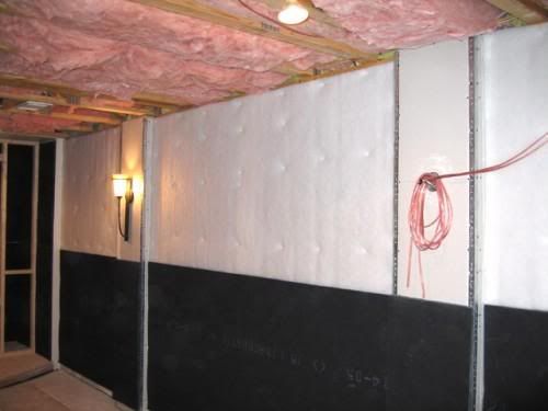

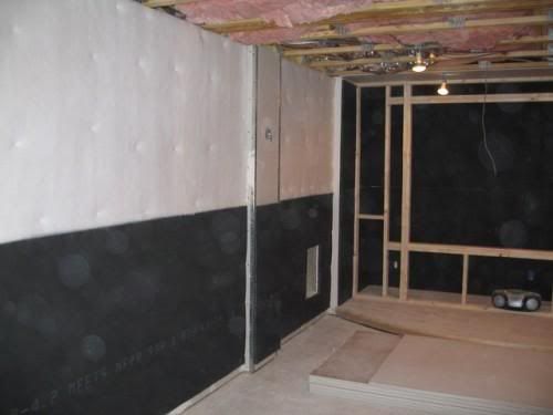

Oh yeah! Linacoustic going up. Notice that my procenium at this point was going to be a 104" on diagonal 4:3 prior to the decision to go 16:9.
Shot of the back of the room with Linacoustic.
Snackbar mudded and ready for final sand and paint.

LOL. Ok - it looks crazy but here is the updated procenium with anticipation of a very big 114" on diagonal Carada screen. I am going to get my screen from Ben Harper. Thanks Ben. What can I say? I got greedy and wanted bigger. There is plenty of room on both sides for the Ascends that I am planning to buy after listening to them at Bud's house. I am going to put my center channel where the boom box is and will have 2 subs on either side of the center channel.
Hello Jo Ann's fabric batting. Let me just tell you that I NEVER thought I would ever darken the door of that place. I felt so weird in that store without my wife around.

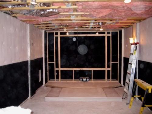

Ok. I am putting up all of my linacoustic and batting first and then will add the firing strips once I finalize my decision on what I want to do. Right now the thinking is basemolding, chair rail molding, and crown. It is so easy to cut the linacoustic that I am not worried about having to retrofit the furing strips in later.
Batting on the other side.
Ok. That brings us to where I am right now...

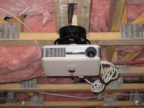

Got the projector mount up. Thanks Bud. It looks great and I am happy with it.
Got in my HDMI, DVI-D, and USB 2.0 cable and will run those tonight.
