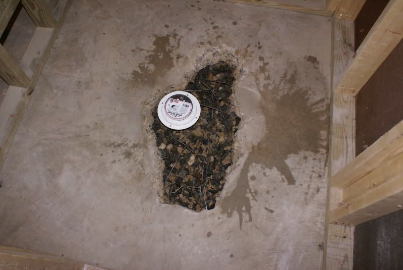

Remember to leave enough room for the mortar base, rubber compound, second later of mortar, thinset and tile (to the top of the drain plug).
CJ
I followed the directions on their web site which indicated that the underneath of the big white flange sits directly on top of the sub-floor (concrete) then the first layer takes it to the top of the flange and then the center part is adjustable for the height of the second layer and tile. Here:
http://www.siouxchief.com/Resource_/...structions.pdf
Please let me know if this isn't correct.

Liked: 26
Jeff:
Excellent picture. That's exactly right!
Keep plugging along. It will look great in the end.

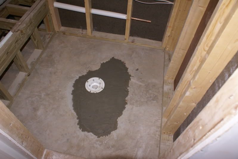

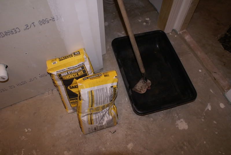

A couple more baby steps
Got the supplies and tools
put the rocks back in, bent the steel into position and washed away all the dust.
Filled it up.
Turned out to be a one bagger. Now I have to carry the other back to the store along with the extra one in my car that I had "just in case".
