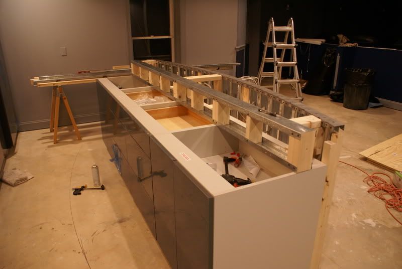

Ok, here is the back of the napkin plan for the back bar.

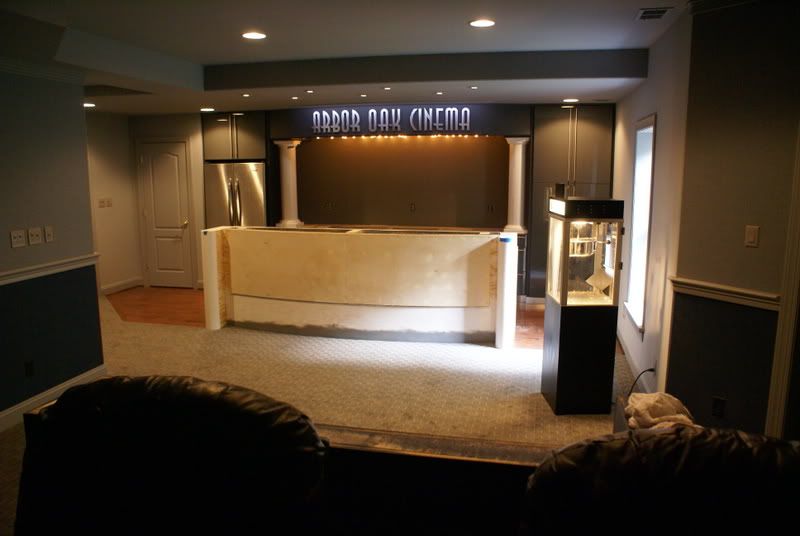

Man that is a good idea. I really want to see if I can adapt your design to fit my space. I would not be able to do the ceiling trim that you did in white, but maybe some others might have a few good additions. To start here is my drawing of the basement and theater room. The issue is that I need to leave 36" walkway to the left of the Theater seats and that is setting the centerline of the screen. It then leaves more room to the left than I want to take up to the right into the wetbar area. I also plan to build a little wall to finish the end of the stage on the right side. I am also struggling with where to start columns with sconces in the room and how many to install. I will try to start a thread tonight when I get home. I should add that the dashed lines to the right of the theater room is a small soffit that we are going to make simply to allow me to paint the theater room ceiling black without while leaving the rest of the basement celing a different color, so it can be moved. Also the dashed lines directly over the theater seats is the soffit that boxes around the HVAC ducts.

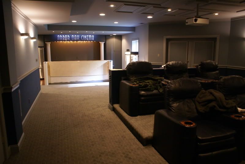

Here we are today:

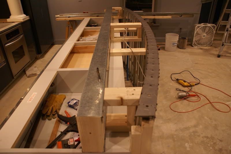

Hey Big!
So you went with metal studs for part of the bar. Any particular reason?
Also, why the intermediate 2x4 between some of the metal studs?
I'm planning my bar outside the theater itself, but like your plan.
Paul

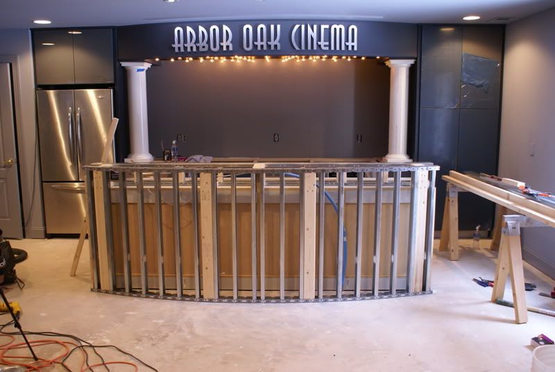

Paul
Thanks for the feedback
On the metal studs I had good luck using the FlexC track to form the curve for the soffit and I just used them because I knew they would be straight and stay straight. I also got a heavier gauge then the HD brand.
Here is some more on the soffit and creating the curve:
http://www.smxscreen.com/forum/showthread.php?t=193
As for the wood I'm planning on a foot-rail and those 4 locations are where I'm planning on attaching the brackets.
Tomorrow I'm going to start putting on a skin. I have some 11/32 plywood and I'm going to put on 2 layers glued together. Then I'm going to form a smaller panel on the front (again 2 layers) then take that layer to a commercial upholstery shop to have then put on a diamond tufted pattern.
I'm a little concerned that the plywood may be too stiff and I might have to go thinner (3 layers) or get some of the specialty bendable materials instead.

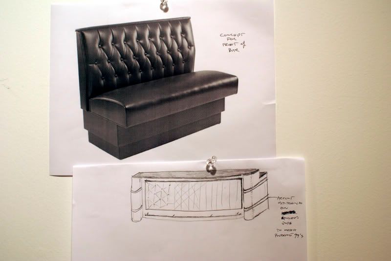

Paul a couple more details FYI

One last update:
I've revised my plan a bit. The end panels are going to look like the front of my Berkline 099s. The bar front will have a diamond tufted panel like the booth below.

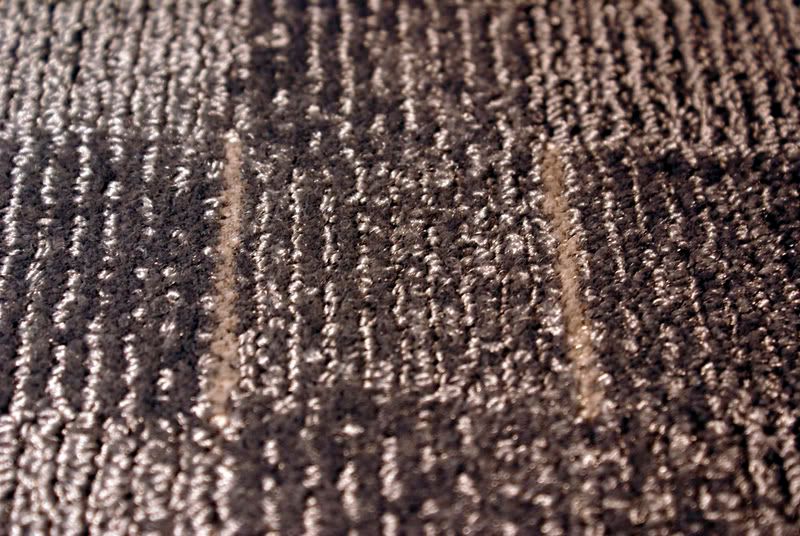

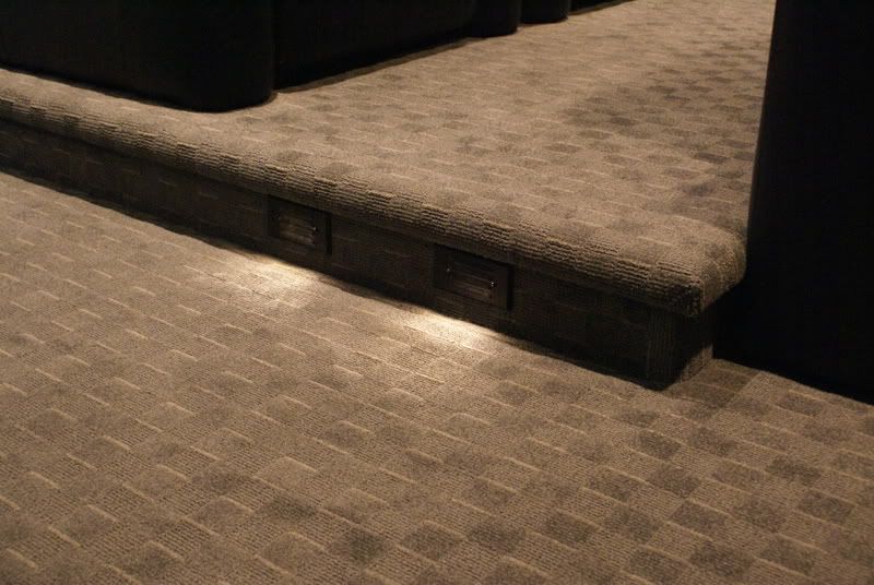

Recently, I had carpet installed and it cost me an arm and a leg.
I'm planning on waiting until the room is done and furnished and I'll post a Recap Thread of all the details. But right now you wouldn't believe it, but Masland carpet shipped a piece with a big flaw right in the middle of the room.

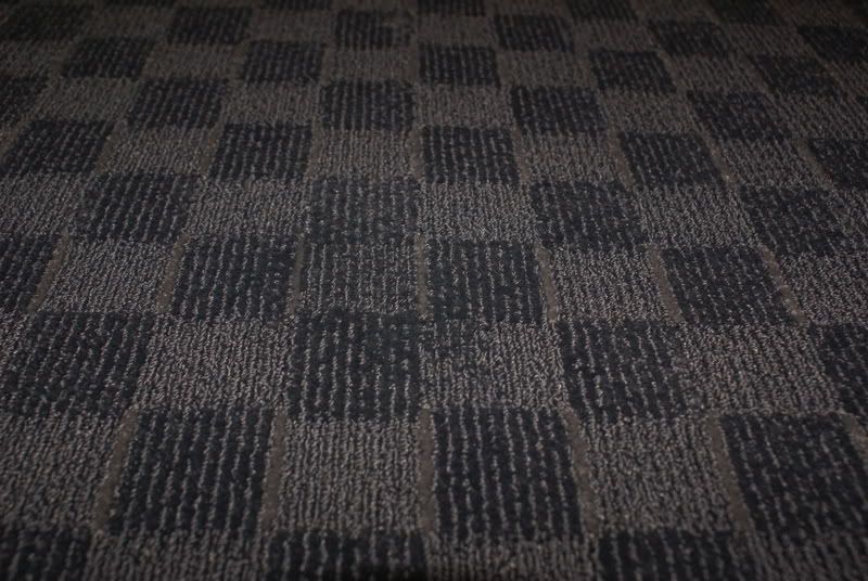

They had to send out an inspector they just couldn't believe that something sneaked out of the factory with all their quality controls. The verdict is they are replacing the carpet.
Couple shots of the carpet
Shots of the oops. There should be a loop pile square instead of the cut pile in the middle:

It's Quadrate pattern, Union Square color.
It's basically a one color grey yarn but looks different depending on whether it's cut pile or loop. It's also different shading depending on which direction you stand. The first two pics are the closest less a little of the yellow cast form the lights.
I goosed the last two pics to exaggerate the problem area.

Big -
I know you have a keen eye, but who REALLY spotted that flaw?
Tom
It was me. As the carpet went down I noticed something. At first I thought it as a crush mark and would spring up. Toward the end of the day when all the scraps were picked up an the carpet was vacuumed it was pretty noticeable.
During the final walk around I pointed it out to the 2 guys (who at by that time had worked 11 hours none stop, complaining about my stage) they said "don't worry it's just a crush mark".
I told my wife that I thought the carpet had a flaw and she spotted it in about 5 seconds.
After they left I got out a work light and got on my hands and knees and could pretty much tell what the problem was. The manager came by the next business day and was expecting to just fluff it up with some cleaner and couldn't believe it.
He e-mailed my pictures to the company and they couldn't believe it. They hired some independent "inspector" from West Va to drive over and inspect it. That was a full day round trip for him (cha ching!). He showed up with his wife who had a great interest in how to do the Linacoustic walls, He had a dinky little pocket digital camera and he snapped a shot.
His conclusion was that at the mill something got behind the carpet raising it up and that section got sheared.
So the replacement carpet is on it's way. The two poor guys who layed it, get to do it all over. Luckily the don't need to do the stairs, riser or stage.

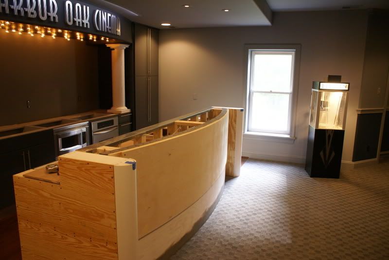

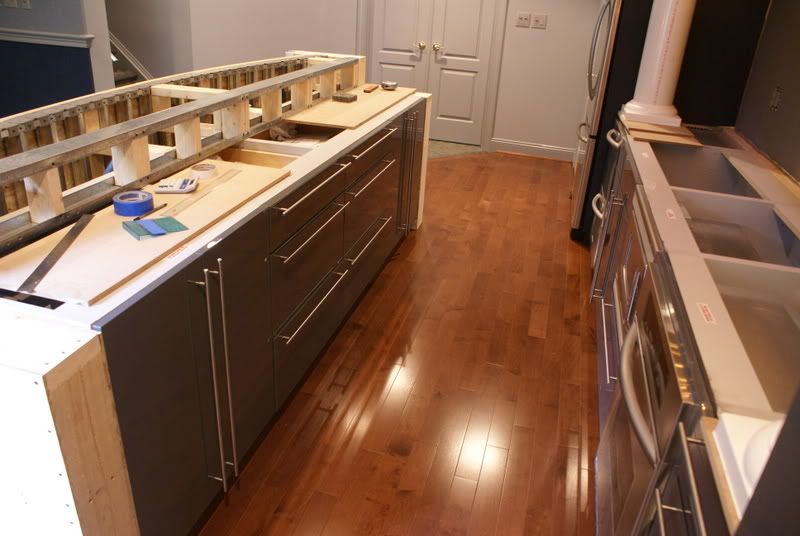

OK, things are moving along so I thought I'd put up a few more pics before my grand finale.
I'm big into the theory of first impressions and here is a shot coming down the stairs to my space:
Still need to skin the bar, add the stainless steel foot rail, counter tops, tile the back-splash, get the blackout shade in, furniture and poster frames.
And now a bunch of other shots:
