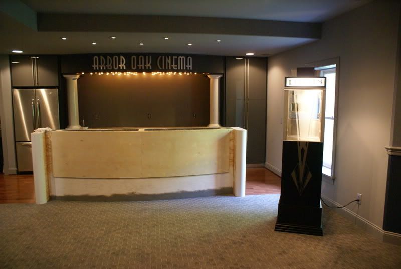

Here is the curved piece of plywood that I had to make for the upholsterer. Three layers of 1/4 birch pine glued together. I used the actual bar as the form gluing each layer and holding in place with screws. This is actually the second I made. The first was two layers of 3/8 but it didn't hold the curve. Three layers worked like a charm.

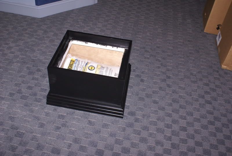

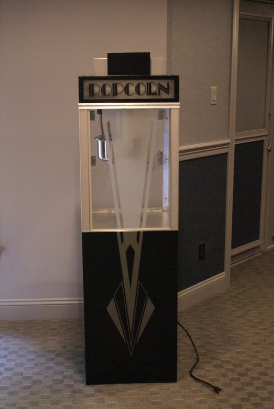

Before and after of building a base for my popcorn machine to give it more of a visual presence in the room. Still need to swap out the back light for a dimmer/bluer version. I think I can just put a Gel tube on the bulb.

Jeff,
May I ask a source for your columns? I am assuming they are fiberglass? Will you be filling them with something? If you cut them yourself, can you please explain how you did it?
Thanks Happy Holidays!
Actually I just bought the PVC pipe column kit.
http://www.classiccolumn.com/
I ordered it from Outwater plastic then bought a large PVC pipe and cut the pieces.
I'm not certain if I am going to keep those columns or make something square. Still up in the air. Also haven't finalized what Color I'm going to do. I could cover the tubes with metal laminate.
Probably would make sense to stuff with insulation just in case.
