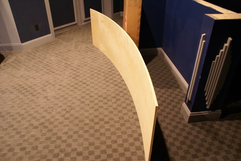

Here is the curved piece of plywood that I had to make for the upholsterer. Three layers of 1/4 birch pine glued together. I used the actual bar as the form gluing each layer and holding in place with screws. This is actually the second I made. The first was two layers of 3/8 but it didn't hold the curve. Three layers worked like a charm.
What a quite cool technique!!! So how does the curve stay that way?
Each layer puts tension/compression on the adjacent layer and with the 3 layers it will hold the curve. My first attempt with two layers was a disaster.
I used the actual bar front as the form and fit the layers to it with clamps and screws. After it dried and I removed everything it held the curve. It sat at the Upholsterer's shop for a couple of months and when I got it back it still fit the front of the bar perfectly.
As for the glue I used well over a gallon of the Titebound II and put it on with a foam roller.

Cool! Thanks for the instructions. I also used TiteBond II for building the manifold for the sub. They are very strong.

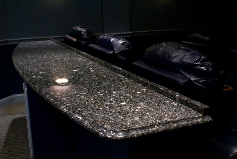

Some progress today. Granite counter tops, sink, faucet and GE reveal bulbs to make the bar top look bluer.

Hey Big what is the total depth of the island/bar and over hang. I am in process of finishing my lower level bar area
thanks Jeff
edit: by the way nice edge on the bar granite!
Thanks, The top is 129 1/4 long 32 wide at the middle, 22 3/4 at the ends. The lower section is 18 wide. The overhang on the front is 10-11 inches.
The edge is Ogee. selecting an edge was a real process. We also considered half bull-nose, Dupont, and others. In the end we selected the Ogee because if looked good on a sweeping curve and gives the impression of a little more thickness.

Looks sick! Are those GE reveal bulbs halogens?
No. http://www.gelighting.com/na/home_li...eveal_main.htm
If you have a room with a shades of blue/gray and you use yellowish lights things start to look like mud. I used the reveal bulbs in my sconces. It makes the wall look bluer rather than brownish mud.
If you look at the picture of the back bar the wall behind the sink is painted the same gray as the side wall. I put a GE Reveal bulb in the light in the corner and you can see the difference in how the color of the wall photographs.
