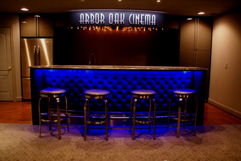

post #202 of 1674 Old 05-08-2008, 08:45 PM
Posts: 27,998
Mentioned: 259 Post(s)
Tagged: 5 Thread(s)
Quoted: 3819 Post(s)
Liked: 3244
OK, mark another milestone on my chart Mr. Logan.
I was thinking that when the lights were low that all the effort that went into the bar upholstery got lost in shadows. So after a couple of experiments I ended up putting a string of blue LEDs under the counter top.
Here they are on full, they look kind of bright in the PIC but aren't all that in person. I've also got them on a dimmer so I can dial them in to be just right.
post #203 of 1674 Old 05-09-2008, 02:08 AM
ArtieR's Avatar
Location: Atlanta (East Cobb), GA
Posts: 69
I really dig the "Blue Lights in the Basement" !!!!

post #204 of 1674 Old 05-09-2008, 06:09 AM
tlogan6797's Avatar
Posts: 5,196
Quoted: 106 Post(s)
Liked: 133
DANG! Now there's something ELSE I need to copy (I mean, PUT) in my bar.
THAT is about the coolest thing I've seen in a theater. Excellent work!

post #205 of 1674 Old 05-09-2008, 06:24 AM
John Martin's Avatar
Location: Fort Mill, SC
Posts: 469
That is a freaking cool effect with the tufting and all. I really think the blue lights help set the front off nicely.
Chalk one up for Big.

i was going to do the glass block framed front but this looks much easier and pretty freaking cool looking!
The tufting is NOT a DIY item. I even rented an Upholstery DVD and after watching it, called a commercial upholsterer.
Putting on foam, stretching vinyl and popping in some buttons is a piece of cake. Getting all those accent folds is an art. If you don't do it right it looks like this. Notice that there are no fold lines connecting the buttons. Not a bad looking door but not as good as it could be.
This is what tufting with folds looks like and my concept sketch that I took to the upholsterer.
I hear ya loud and clear. As for the Door I agree really nice idea and not bad looking but can see where a pro would have put it over the top.
How did you find craftsman to do this? last thing you would want is to pay and have it turn out not perfect. Although I am in the 3rd largest town in Ia I bet I will have trouble finding someone, at least this is my guess.
