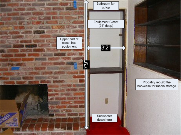

- Equipment closet. Just to the right of the fireplace is an existing closet 2'd x 2.5'w. A perfect equipment closet! Its stuffy, and I am concerned with airflow there. I did have a ton of spare junk in there before so Ill need some new place to throw my junk.

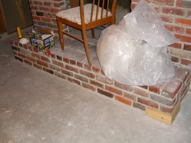

- FIREPLACE - The focal point is a big old 7.5' w x 7.75' h red brick fireplace. Its been used twice in the 12+ years that we've lived here. Its a perfect place for the screen actually. My buddy said I should not put the screen there but on the opposite wall that has a 6.5' x 2' window. I could do that, but it would really make putting in 2 rows of seats difficult because row #2 would be basically right up against the hearth of the fireplace. Just wouldnt "look" right. Im not completely opposed to it, but getting a floor plan that can seat a crowd of people would be a challenge that I need some help resolving. One idea I had was to put 1 chair on each side of the fireplace so as to not block the firebox with a chair. An end table could go in between I suppose. I dunno. Needs some more thought. Im still pursuing using the fireplace as the primary screen locale.

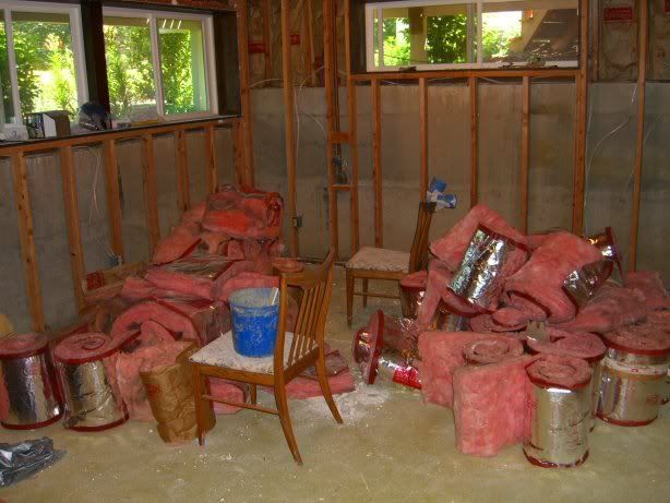

Step 1) Demolish the existing room.

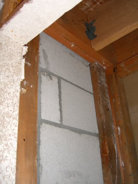

Here's where challenge #1 is. Popcorn ceilings! Yes, it has asbestos. House was built in 1973. Sigh. So, Ive got an asbestos abatement company coming out on Friday (6/23) to scrape it. Boy, I was tempted to DIY! I flip-flopped on this decision so much. Ive heard, read, and seen many situations where people just wet it, scraped, and lived happily. I finally waffled to fear and paid the $1500 to get it professionally scraped and removed. I dont want to watch because its going to kill me watching someone wet it with a garden sprayer and scrape with a putty knife. I could have done that! Only difference is theyll be in a moon suit, have a negative vacuum going, and everything will be sealed with plastic. Their advice was for me not to demolish anything in the meantime so it would make removal easier. Sigh. Im DYING to rip down the old drywall and see what I have to deal with!

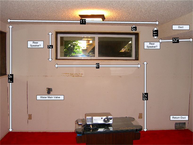

Here's a pic of the back wall my buddy said I should really put my screen. The window overlooks (or maybe underlooks is the better word), the belly of my deck. No big loss if the window is covered up with something. I agree this is a good wall for it, but the fireplace is then at my back, and puts a wrench in my 2nd row idea (i.e. the back row would butt up against the hearth).

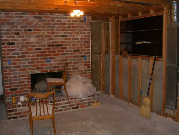

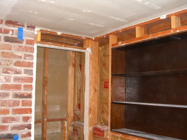

To the right of the fireplace was a closet. I will rebuild the closet for my equipment. Ive used a Panasonic Whisper fan in my bathroom remodel so I found it enlightening to hear others using it in their closets/cabinets. Not sure where itll vent to, but to the right of the closet is the outside wall (near the main entrance to the house). I wont really have access behind the closet. Its the storage space underneath my stairs, and there isnt much headroom for anyone to really manuever back there.
I would like to put my subwoofer at the bottom of the closet. I have a Klipsch KSW-12. Its a nice middle of the road woof with good enough boom for me. Anyone ever do such a thing before? Im interested in knowing if the woofer is going to be rattling my equipment.
The closet runs floor to ceiling. Used to have some bi-fold doors on top and bottom, but Ive ripped those off. Ill have 7'9" to play with, so Im hoping to get some drawers in it for DVDs, CDs, random junk, etc.
Not sure if Ill hide the closet behind a door or anything. Maybe a glass door. Ill cross that bridge when the time comes.
I would like to build the closet shelving with cabinet grade wood that I can stain. Each shelf would be a slider so that might help make up for the lack of rear access (if youll pardon the expression). I like stained wood and dont mind making the equipment closet visible to people. Hey, I paid good money for this equipment! Why hide it?!

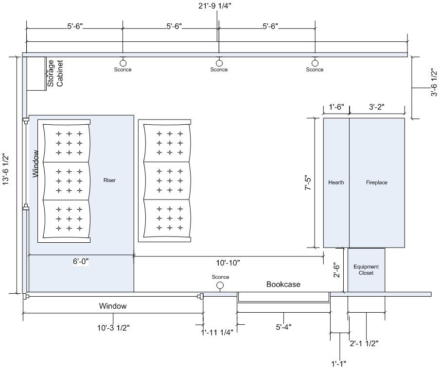

So here's my basic floor plan. Is 6' deep enough for a 2nd row? I just sat on my sofa and stretched out good to make a guess that it would work pretty well. The only drawback is the back row would be against the back wall. Im not too worried about it unless someone out there thinks this would be a very bad thing to do acoustically speaking.
Now you should be able to see that if I flipped the room so our backs were to the fireplace that the 2nd row becomes a problem. I suppose I could move the first row forward a bit more, but was trying to make that as optimal per the screen width * 1.5 rule.
Where does everyone get those cool Visio shapes? Ha. My Visio had some really generic sofas. Id actually like to consider an "L" shaped sofa (i.e. wraparound) on the first row. Adds more capacity, and I think it would work stylistically too.

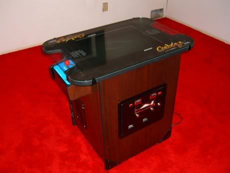

post #11 of 537 Old 06-17-2006, 09:46 PM
nebrunner's Avatar
Join Date: Sep 2001
Location: omaha,NE,USA
Posts: 1,224
Quoted: 43 Post(s)
Liked: 49
sweet galaga cocktail, did you build it or is it an original?
nebrunner is offline
post #12 of 537 Old 06-17-2006, 10:01 PM - Thread Starter
david_rostowsky's Avatar
Location: Bellevue, WA
Posts: 424
Haha. Thanks for noticing! It was an original that I rebuilt. Its got a real wood veneer on it now instead of the original plastic laminate. I replaced the graphics under the glass, gave it a new power supply, replaced video chips, new fan, new joystick, buttons, etc. All replacements were true to the original machine. It was a fun project. It is a sweet machine now. Ill post a couple of close ups when I get a sec. Its my personal all-time favorite video game. My first paycheck after graduating college went for that. Didnt even have a chair to sit on, but darn it. I had GALAGA!
david_rostowsky is offline

I like the way you've put dimensions on your photos. Very efficently informative.

Thanks. Takes a little time to put together, but wanted to make sure I gave enough info so people could help me think this through properly.

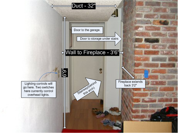

Nothing too interesting here, but should help keep the pictures flowing to help complete the mental image of the room space. It does show where the lighting controls will be located. There are currently 2 light switches here. One for each light fixture. I could never figure out why it was that way as the room was always so dark that both lights needed to be on to see anything. Drugs were obviously more widely (ab)used in the 1970s...
I guess the important point here is the duct that drops down about 11" from the ceiling. Most people over 6' tall get the paranoid feeling that theyll bash their forehead on the duct when walking in. Cant wait to rip the ceiling open so I can assess what (if anything) can be done to help this out.

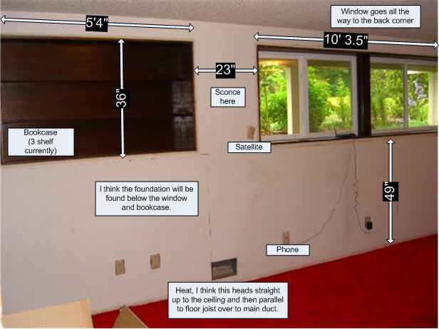

So this is the wall where lots of interesting things will no doubt occur.

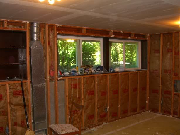

Theres a fairly big window here to contend with. It used to have a roman shade here which rendered the room pitch black even in bright daylight. Not much sun to worry about in Seattle area. Ive taken the shade down as it was really falling apart after 30 years, but I will get a nice new one. I used to think the room being so dark was a curse, but that roman blind really helps for the home theatre application! Im not so fanatical as to drywall off perfectly good windows either. I replaced those windows with 2 pane windows a few years ago. Not about to drywall those babies off!
You can see where the satellite feed came in to the house. The line was drilled through the outside wall straight into that jack. Its up so high on the wall because they were either lazy when they built the house, put it in after the drywall was up, or the foundation of the house got in the way. In any event, that and the phone line will have to be pushed over to the equipment closet. Ill have to figure that out once I can see behind those accursed walls.
Another problem spot is the heat register on the floor. You can see I marked off where Id like to have a wall sconce, but I cant imagine that being code if the electrical was near the heating duct that Im sure runs right up the wall to where I want the sconce. I can live without the sconce, but it would help balance the room out with 3 sconces on the opposite wall (maybe). There used to be a wall clock there which I found invaluable. Maybe itll go back. Or maybe some other decoration can go there, a picture? I dont know. Thats a decision that can wait.

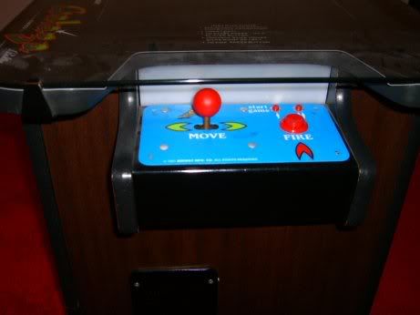

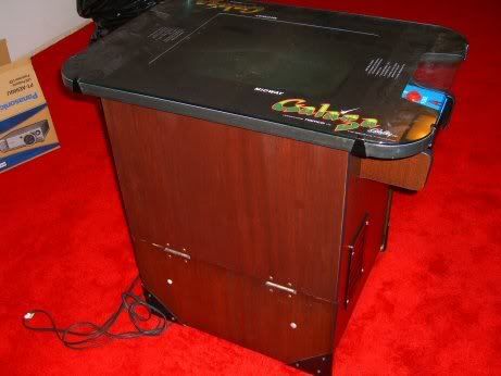

Just a quick interjection about the greatest video game of all time, and the only game in my home theatre's arcade. Not sure where Ill put it when the HT is done, but Ill make room!
I bought this baby in 1994 for $400. Since then, I rebuilt it almost entirely.
Heres what got modified (or didnt):
Galaga Serial #1262
Original circuit board
New video RAM (those were a treat to find )
New power supply
New fan
New replica joysticks
New replica buttons
Repainted original glass clips
New 1/4" tempered glass (beautiful)
New graphics underlay
Ripped off plastic laminate from original plywood cabinet. Taking off that plastic was a PAIN!
Glued on walnut wood veneer 10 ply paper backed
I stained it with red mahogany. It looks like the original color (but better IMHO). Reflections from the red carpet make it look redder than it is. Its really a nice dark brown ala 1970s molding (I should know, my house was covered with it).
New lock
Spray painted original coin return
Spray painted original vents
New corner guards
New T-molding
Spray painted metal under joystick controls on each side
Original monitor. The reason I bought it. 0 screen burn.

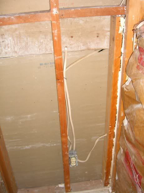

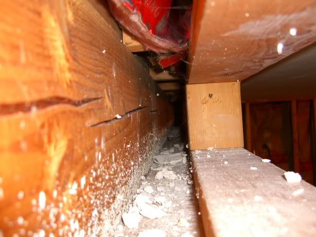

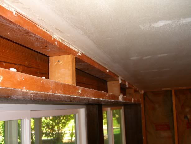

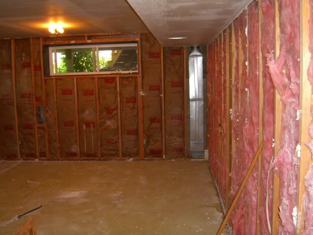

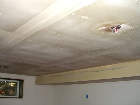

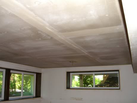

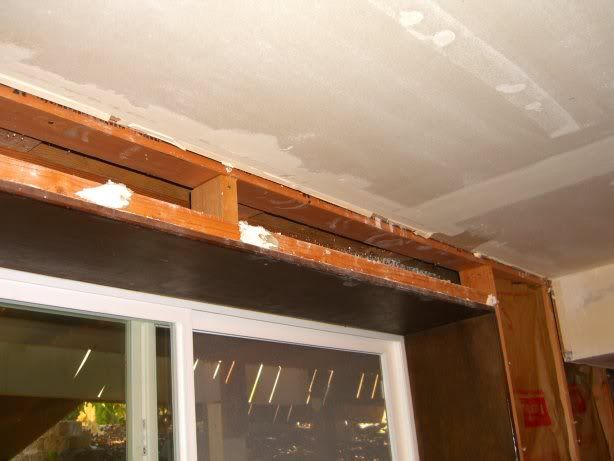

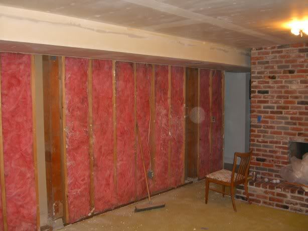

Yay! The popcorn is gone! The blocking item to my demolishing my room for the home theatre is removed! Let the demo begin! Know what Im doing this weekend.
Now that I can peek into my big ducts vents, I can see theres a specific heating duct line and probably a separate return duct in the big plywood box. The return vent is running against the wall, and the heat duct is the one nearest to the room. Cant wait to see where the return lines branch off. I suspect one comes from upstairs. I do have the one return in the HT room, but it wouldnt make much sense to run a big huge 12" duct just for one silly 8" return vent. My suspicion is the HT will have to just live with the HVAC the way it is. However, I will probably call in a HVAC expert to fill me in if anything could be done.
Im excited to see what mysteries lie behind my walls!

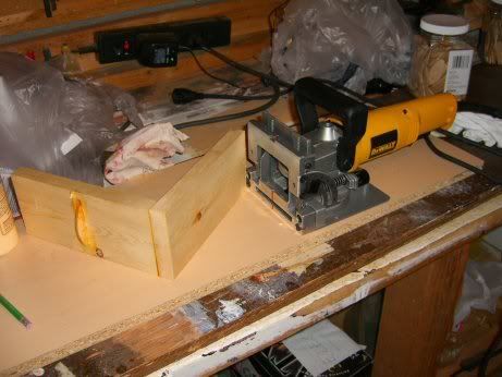

Say hello to my new addition. The DeWalt DW682K biscuit joiner. I went to town with it immediately. Adjusted the depth a bit when I did my first #20 cuts. I practiced doing my first end piece joining. I know Ill be doing this join when I build the oak plywood box around my hearth. Im going to do the same thing again tonight, but 45 degree the joining edges first. I think thatll be a cleaner look and I wont have to worry about edgebanding it.
That board the joiner is laying on has about 25 slots cut into it, but its on the backside.

With the help of my nephew, we took down all the side walls today! Wow, what a load of junk. My garage is filled with garbage sacks of busted up drywall. We also pulled up the carpet too. We left the carpet pad for no particular reason. Seemed easier on the feet.
We found a treasure in the walls though! A built in 3.5" soffit! It runs from the equipment closet, above the bookcase and windows all the wall around the room until it hits the duct. Wow, its SO perfect for running cables! I could put a 2" conduit in there for my projector wires. It does get tight going around the heat duct between the bookcase and window. Thats the only issue really, but this is great news!
Here's some pics that show the soffit. Theyre ordered such they basically move from left to right when looking at the room. One closeup pic is my camera in the soffit space looking down this great space.
Im in the soffit!

So here's the big picture of the room.
Check out the honking 6x6's holding up the house! Kind of hard to see the far one in the pic, but its there.
Heres the bottom of the electrical closet. My equipments electricity!
Heres the right side of the fireplace (left inside of the equipment closet)
My nephew is keen to come over tomorrow. Ah, the boundless energy of teens. We'll drop the ceiling. Hopefully not on our heads. Ditto for the drywall + plywood box covering the overhead duct. If we have time, take out the insulation too. Im almost hesitant to pull the insulation. Its in great shape. Will have to get to the electrical though eventually. My brother in law is coming over with his pickup so we can make a run to the trash dump with my garage full of junk.
BTW, I dont have a pic yet of it, but below the windows theres a little concrete "shelf" too. Its where the foundation wasnt as deep to make room for the windows. I noticed peeking behind the insulation that the electrical is run on this little "shelf." Interesting.

Well, demolition day #2 is in the books. 5 hours yesterday plus 5 hours today. The ceiling is pulled down as well as the insulation removed. Just me and my nephew going to town on it. We yanked 98% of the nails out of the studs. We also removed the carpet pad too. Later in the day my brother in law came over with his big truck and we loaded it up with everything! Whew! What a pile! He's a landscaper so he's used to hauling big loads in his truck. He helped us remove all the carpet tacks too. The floor is in its bare concrete glory now. My wife came down later and swept up most of the little bits and pieces. Will need to run over everything with the ShopVac to pick up the remaining junk aroud. As far as Im concerned the demolition is 99% done. I see a few nails here and there in the studs, but really its ready for construction!
Now that I can see most of the electrical wires. I can start to noodle through how to hang some recessed lighting. Need to crank out a drawing for it, and then see if I can figure out the rats nest of electrical wires everywhere. Whew. There are wires going every which way. Completely nonsensical right now. I cant see how it made any intuitive sense to the original electrician!
Will post pics later.

The next project. Fiddling around with my biscuit joiner and some scrap wood. Joined the 1x4' pieces with a #0 biscuit after a 45 degree miter cut. Thatll be what I want to use on the oak plywood box around the hearth.

Junk Piles before my brother in law arrived with his truck for a run to the dump!
Heres a nice clean room (almost) after sweeping and cleaning up a bit more at the end of a long day.
