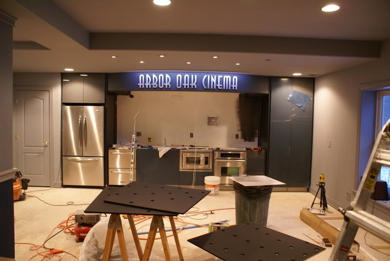

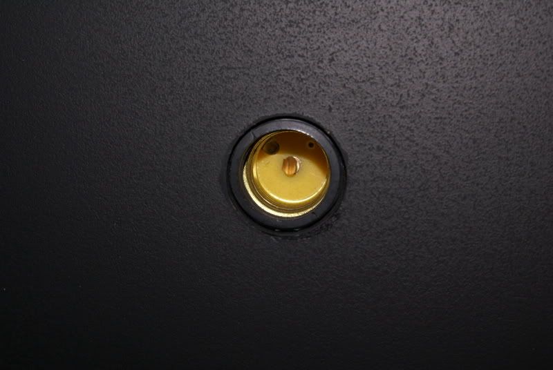

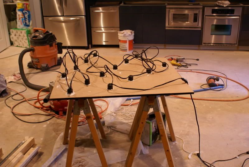

I've tried Christmas lights and fact I've now got an assortment that failed the audition process. They basically looked like christmas lights sticking through a board.
What I've ended up with is an 11 watt sign bulb in a medium socket (normal lightbulb socket) for my marquee.
http://www.budgetlighting.com/store/...&ppinc=search2
Here is one panel at the factory:
It's going up under here:

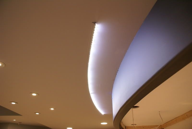

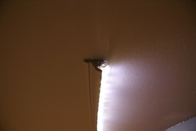

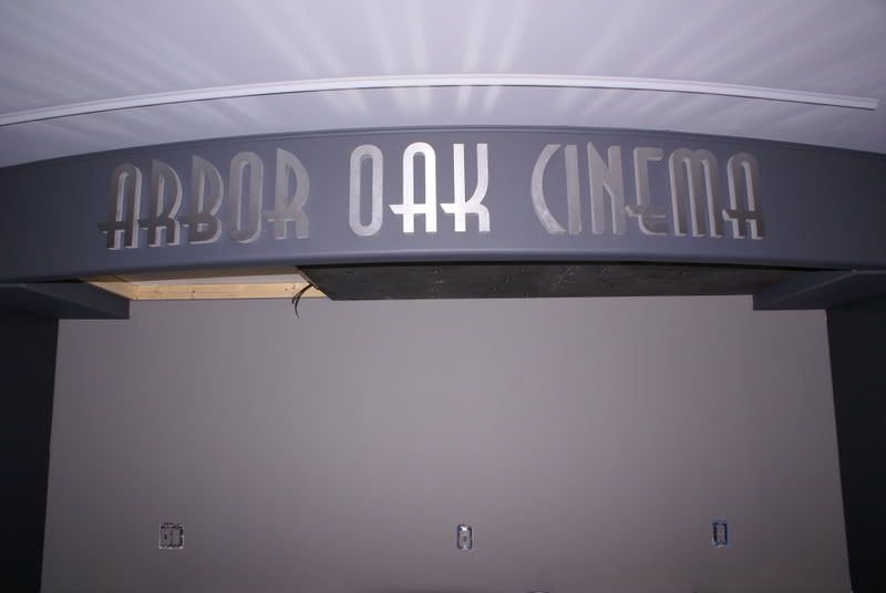

Thanks Heynow, I didn't have a collection of helmuts so I had to do something different. I admire your bar it's got a feeling like I could sit there all day.
Another thing I came up with for lighting the Marquee letters is a one of a kind. I started with a LED strip lighting system from IKEA:
http://www.ikea.com/webapp/wcs/store...umber=90098177
Then I took a piece of base molding cut out a reccess and glued the led's in the recess.
I actually put the molding up first in the shape of the Marquee then glued in a total of 8 ft of the white LED strips up.
That's how I ended up getting the Metallic letters to come alive.

Wow, looks awesome!!
Was it difficult to get the sockets to mount straight so the bulb will look straight? Did you use a cordless drill or a drill press to drill the holes? That was the dilemma I was stuck with with rope lights.
Can you take a close up or two of the socket both on the back side and face? What kind of glue did you use to mount the lights?

Craig I actually tried that string and changed my mind. The sockets are tapered and it's the wrong direction. The part that you would want to shove in a hole first is the biggest.
That would make for a sloppy fit.
With the medium size sockets (see link) the sockets are straight and there is actually a lug just a little less that 1/2 inch from the lip so that when you press them into a hole in 1/2 MDF the front lip just comes just a little short of the surface (perfect)
http://www.budgetlighting.com/store/...gs-Medium-Base
I used a hole cutter in an electric drill, I did have to order online the right diameter because neither Lowes, HD or Sears stocked the one I needed. I cut 1/2 the depth from one side and then flipped the wood and cut the remainder of the hole to keep the edges from tearing out.
I used Loctite construction adhesive, glueing just a few at a time. You have to keep checking that they haven't come out of position because of the weight of the cords tugging.
I'll post some more pics.

Big - the Bar area is really coming together.....sweeeet!
Craig
I'm not taking it down to get a closer pic of the back but here is the business end. That's a 1 7/16 hole. It's actually about 1/64 to big but you gotta use what you gotta use.
I'm going to put another coat of paint on now to hide the marks from the construction process and to cover up a few of the sockets where some of the white glue is peeking through. When it dries I'll put in a few bulbs and take a pic.
